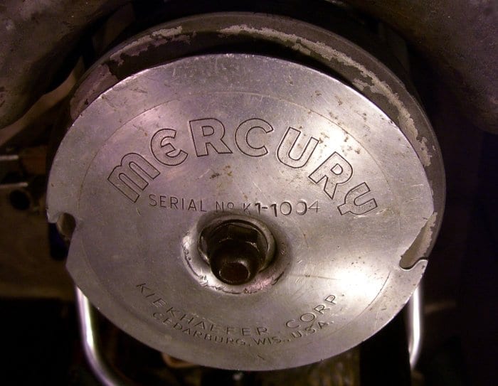

          #194697
          ROBERT LAFAYETTE
            1940-8820
            11133255
            https://aomci.org/forums/topic/1940-mercury-k1/
            From Bob Grubbs excellent site!!!!! (Thanks Bob)
            http://www.mercguy.com/virtual_outboard_museum.htm
            mercury_k-1_motor
            K-1_serial

                Thanks for the replies Louis and Bob! Great pics!! My motor appears to have the tab on the port side. #2403. So it must be a sea king. Rats!
                Is #1006 in the pic a K1? Can you post any more pics of that one?

                #194748
                ROBERT LAFAYETTE
                  Serial number 1006
                  Number 5 or 6 off line.
                  My second motor is serial # 4806
                  Weird? Yes

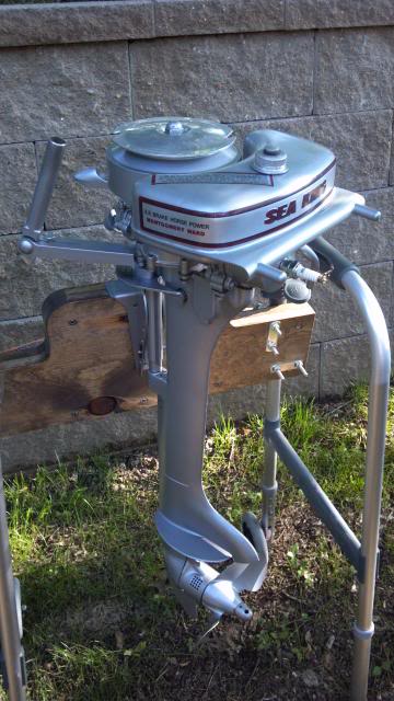

                  #194774
                  kirkp
                    Scott, you sound disappointed that it’s a Sea King. It’s identical to the Merc K1.
                    Restored
                    1940SeaKing_zpsfb415450
                    As found
                    avatar
