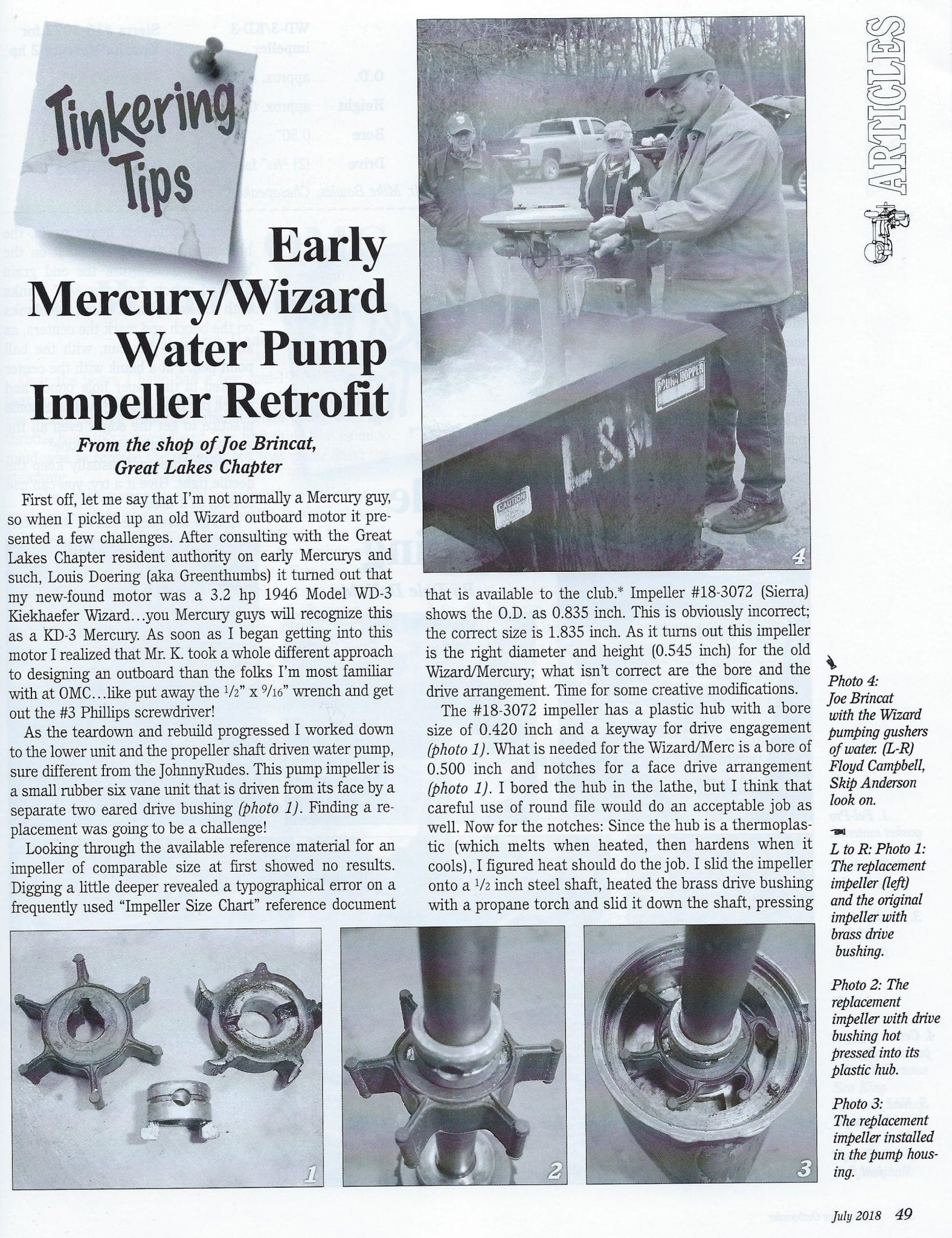

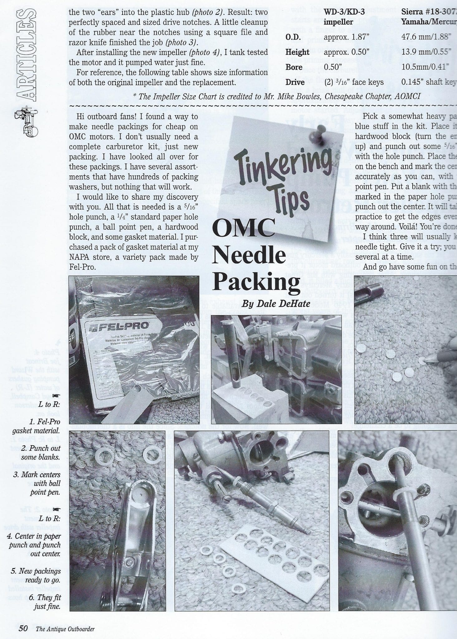

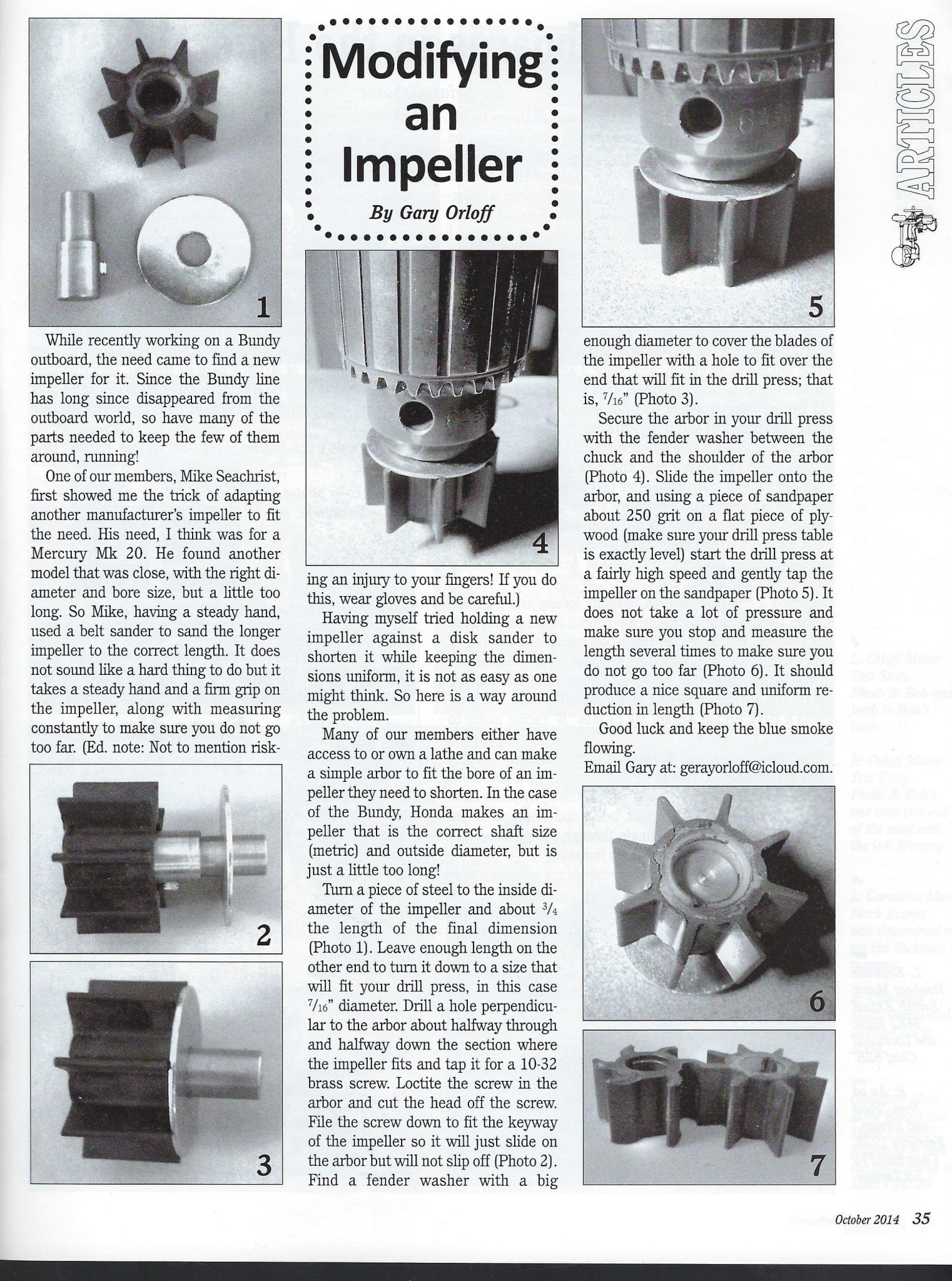

You can also modify a current available impellor to fit.

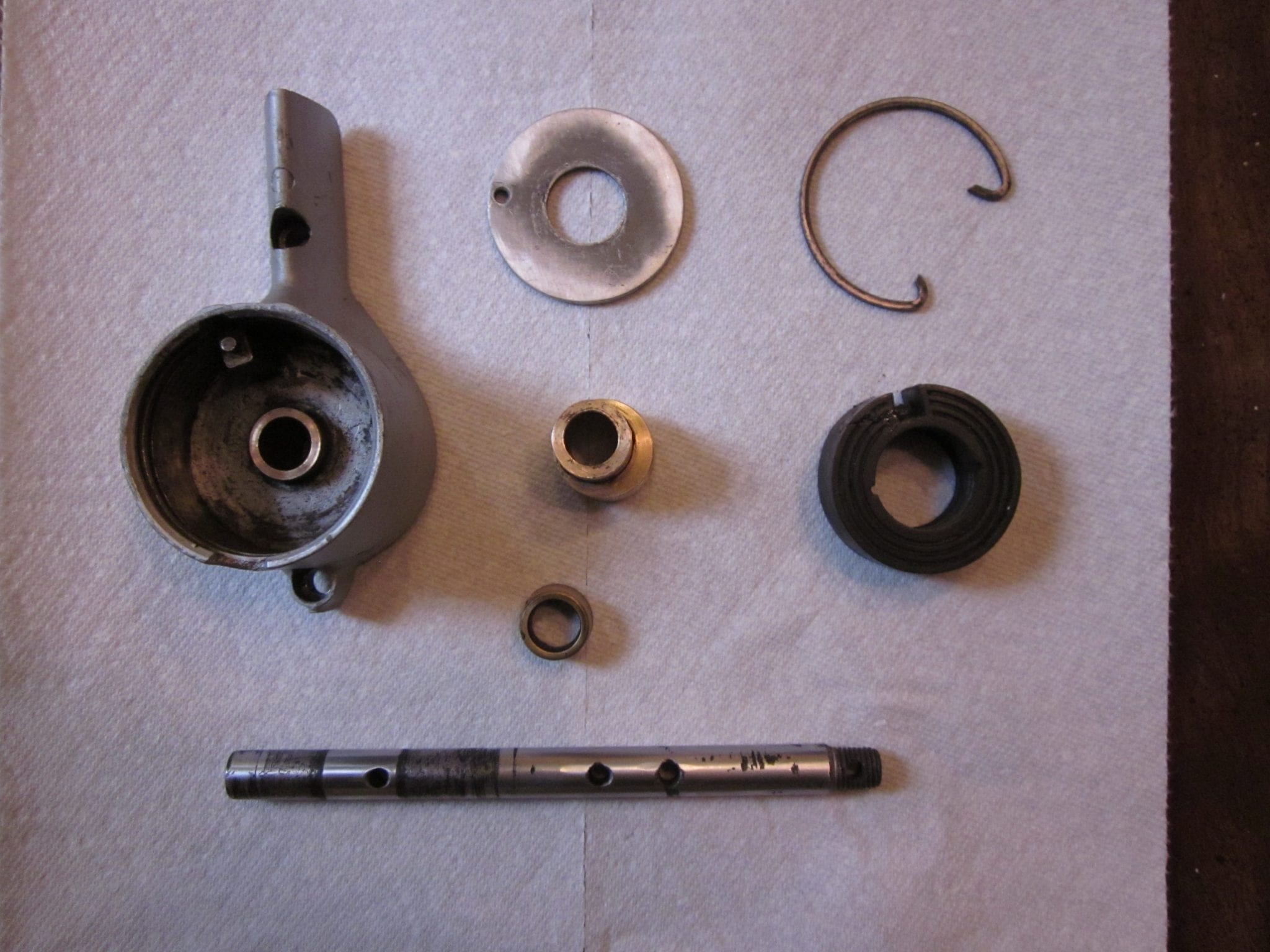

If your motor still has the 16 square hole intake, you will need the oscillator style impeller available from
The 7 slit or later 3 slit water intake use the rotax style (Vanes) like a conventional water pump.
