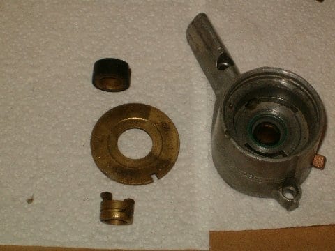

      I am trying to replace the impeller on subject engine. There is a brass disc in front of the impeller, held in by a “C” ring. I have removed the “c” ring but am unable to remove the brass disc. The impeller is behind the disc. Anyone have experience removing the disc ? Any suggestions welcome.

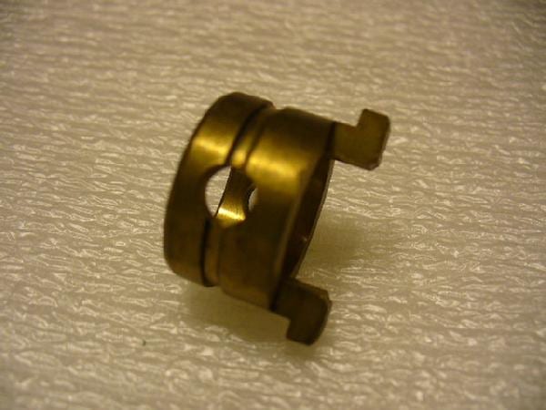

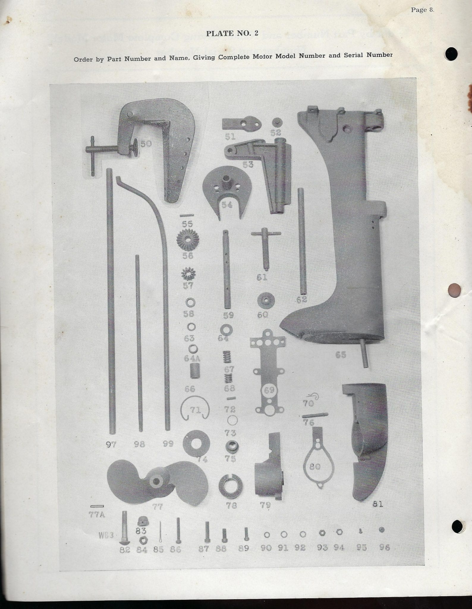

      #196106
        By brass disc, are you talking about the impeller drive dog? That appears to
        have a C ring keeping a pin going through the drive shaft, in place.
        WD-3-KD-3-Impeller-replacement
        #196111
        joellerich
          The document you sent is what I need. The second page of the document did not come thru. can you resend or e-mail to john.oellerich1525@gmail.com
          The disc I cannot remove would cover the impeller as shown in fig 3 It is held i place by a C RING.

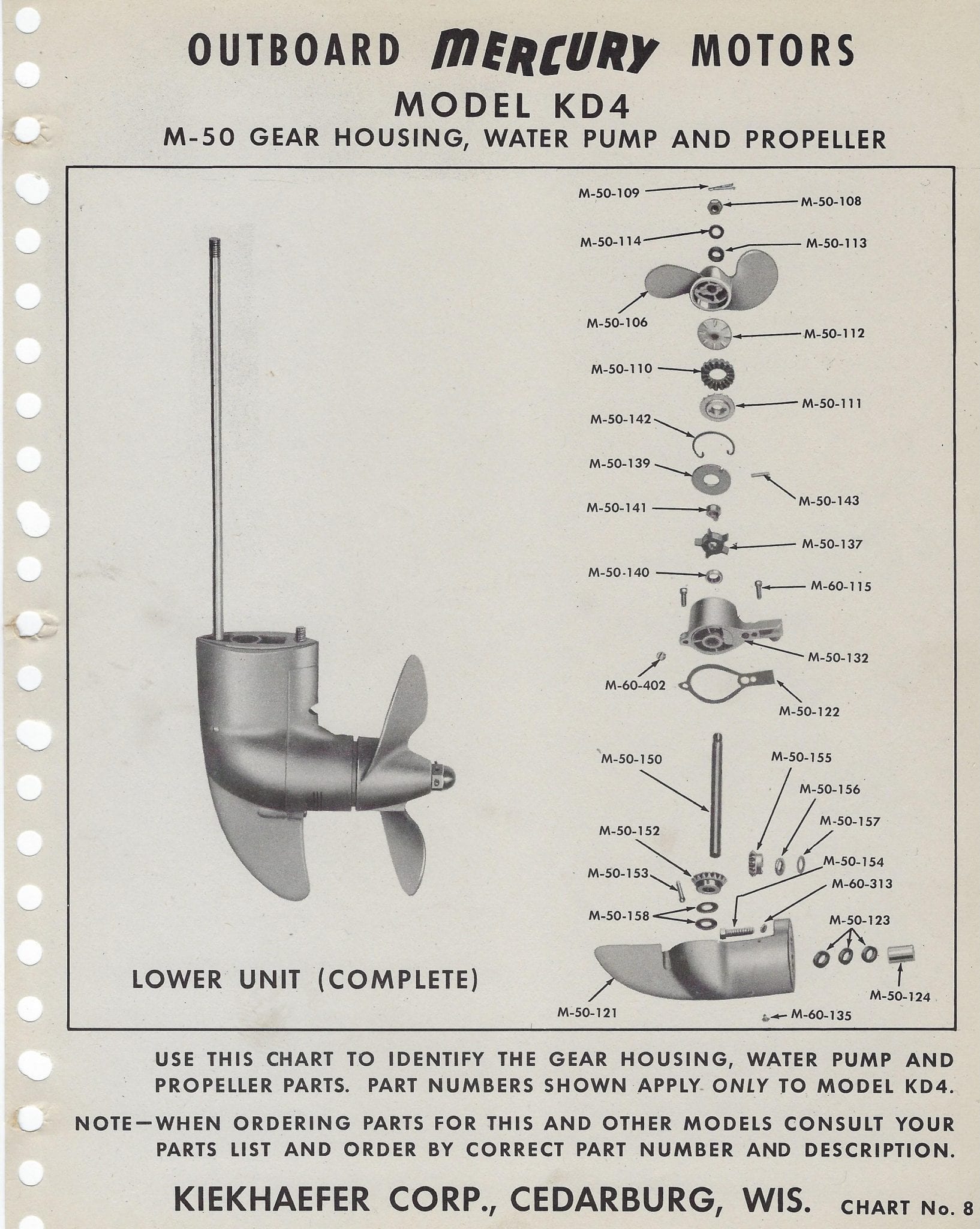

            ROBERT LAFAYETTE
              #196132
              ROBERT LAFAYETTE
                KD3
                #196151

                  The brass disc is a close fit so it does not take much crud to jam it in place. Line the pin up with slot on edge of water pump housing, then
                  push it out. If the pin is bent in an S shape it may be best to cut it with
                  a Dremel tool cut off disc or similar method. If the pin come out without
                  a problem, use 2 rods to pry up on impeller drive hub…that often is enough to do job. Extreme method is to SLAM the water pump housing
                  down on a wood surface so the inertia of the heavy brass disc pops it
                  loose. Both methods work, If may help to clean the gap between the
                  brass disc and the water pump housing as that may ease removal of
                  disc by either method.

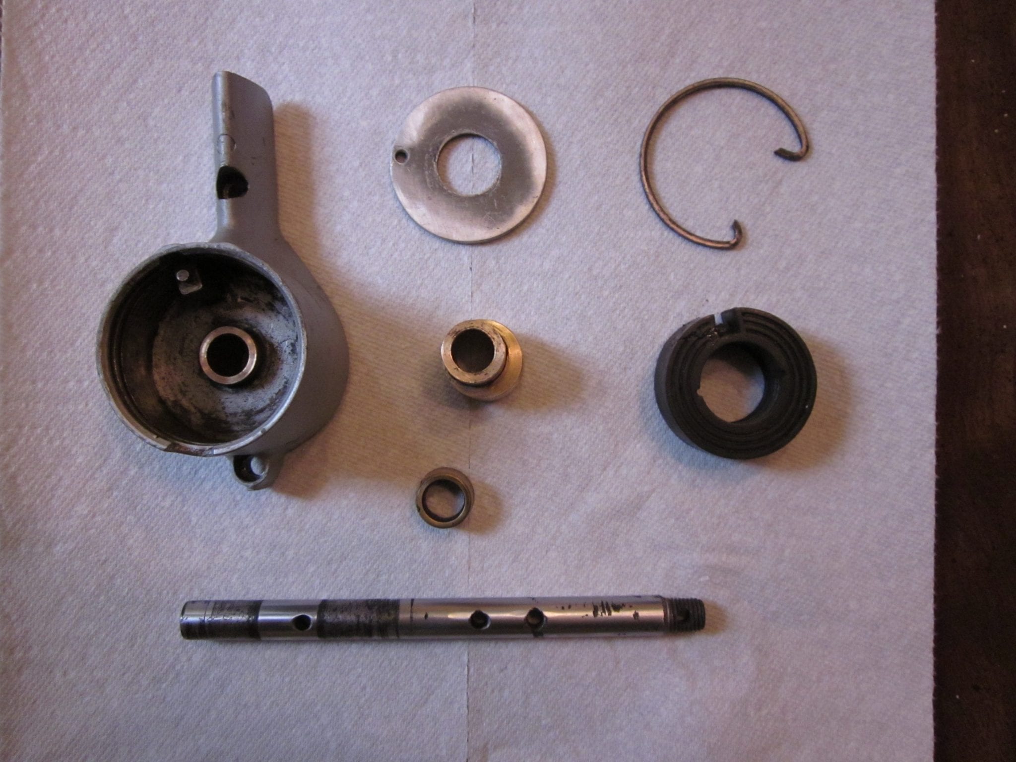

                      #196484
                      ROBERT LAFAYETTE
                        Scott,

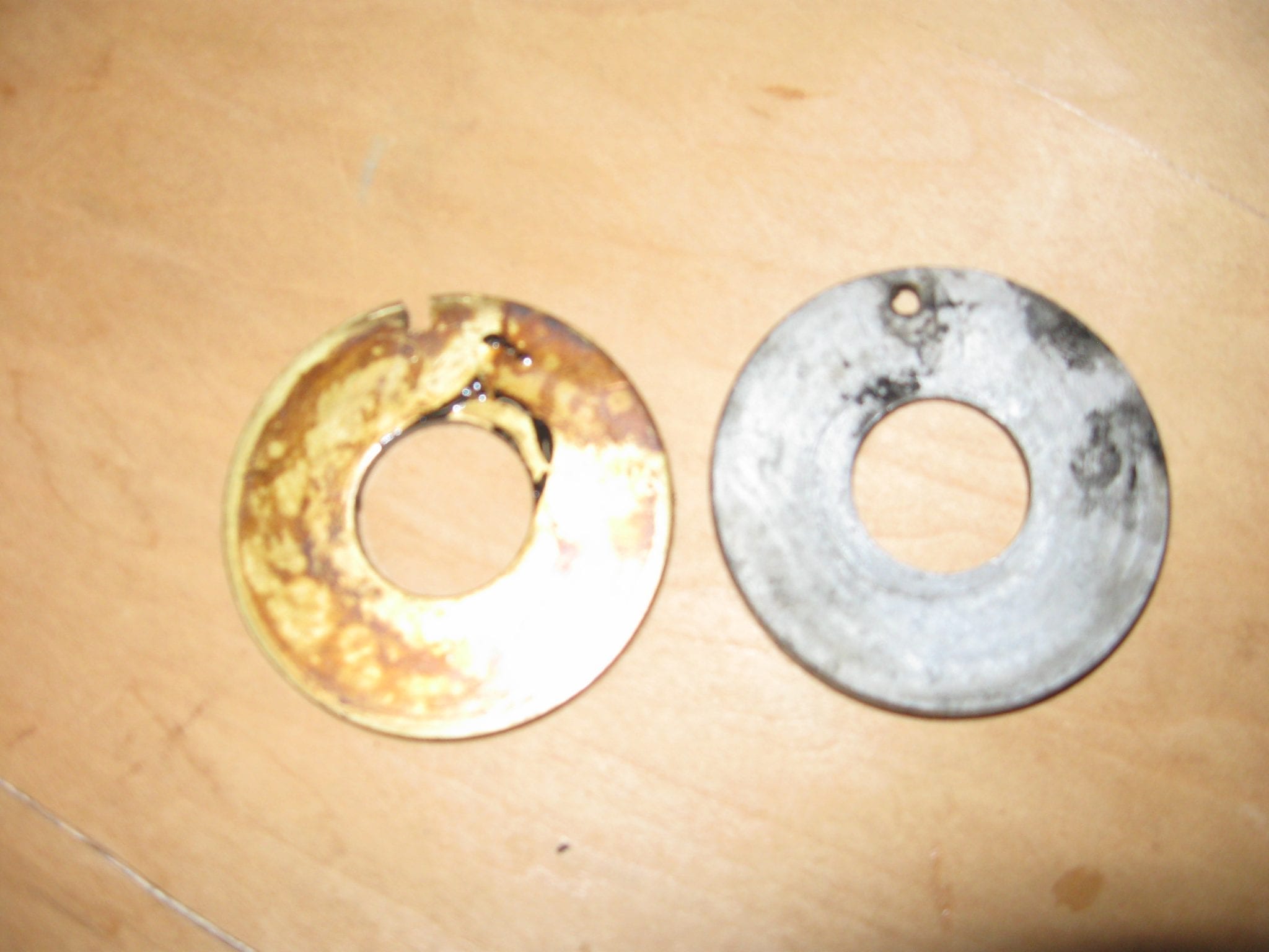

                        The Mercury 1940 K3 should use an oscillator (Hockey Puck) style impellor not a rotax style.
                        Does your intake have the 16 square holes like Sea King K1?
                        I would dissemble intake & prop shaft from lower unit and try a little heat on outside of aluminum
                        Housing using propane torch and try to press out using drive shaft Gently! i.e. light taps.
                        Reproduction impellor are available from Ferguson- poole
                        http://fergusonpoolemarine.com/
                        7-slit-water-pump-components-plus-brass-stock-to-make-eccentric-004
                        comet8
                        IMG_3338
                        The Oscillator style pumps have a hole in cover
                        And the rotax vane style pumps have a slot in
                        Cover. (See Picture)!
