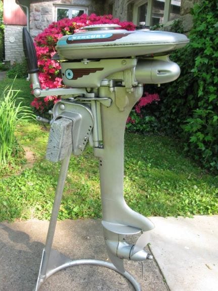

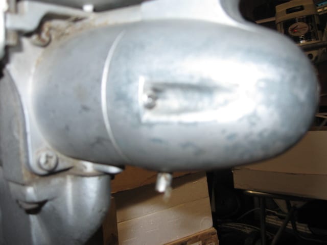

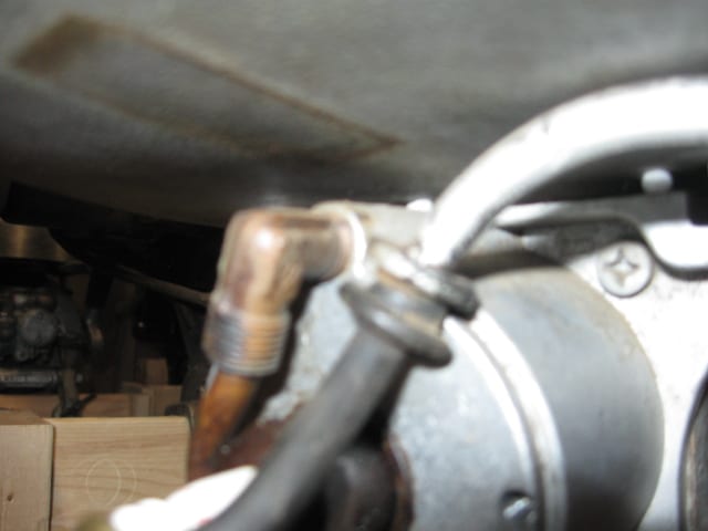

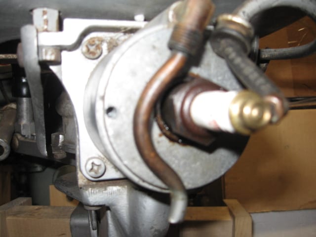

          A few pics of my 1946 Mercury KD-3
          Hope these help.
          Good Luck,
          1946_Merc_KD3111
          IMG_4426
          IMG_4428
          IMG_4430

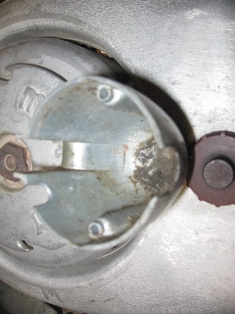

          ROBERT LAFAYETTE
            inside of cover.
            IMG_4431
