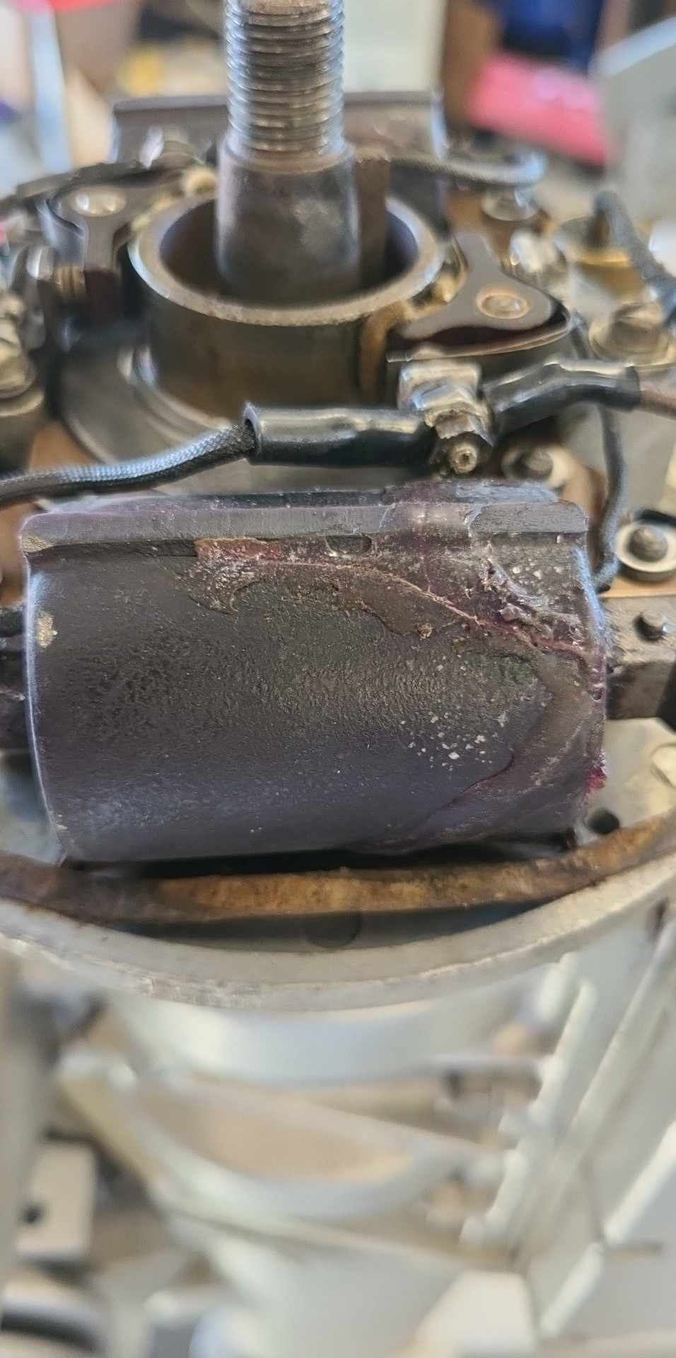

          One is look at the coils and power test them on a Merc-O-tronic or Stevens coil tester. If the results are the least bit unfavorable, junk the coil because its only going to cause you heartache later. Sometimes there is evidence that someone has tried to repair a cracked coil with epoxy. Be very wary of using such a coil in a motor unless you enjoy being stranded somewhere.old-coil

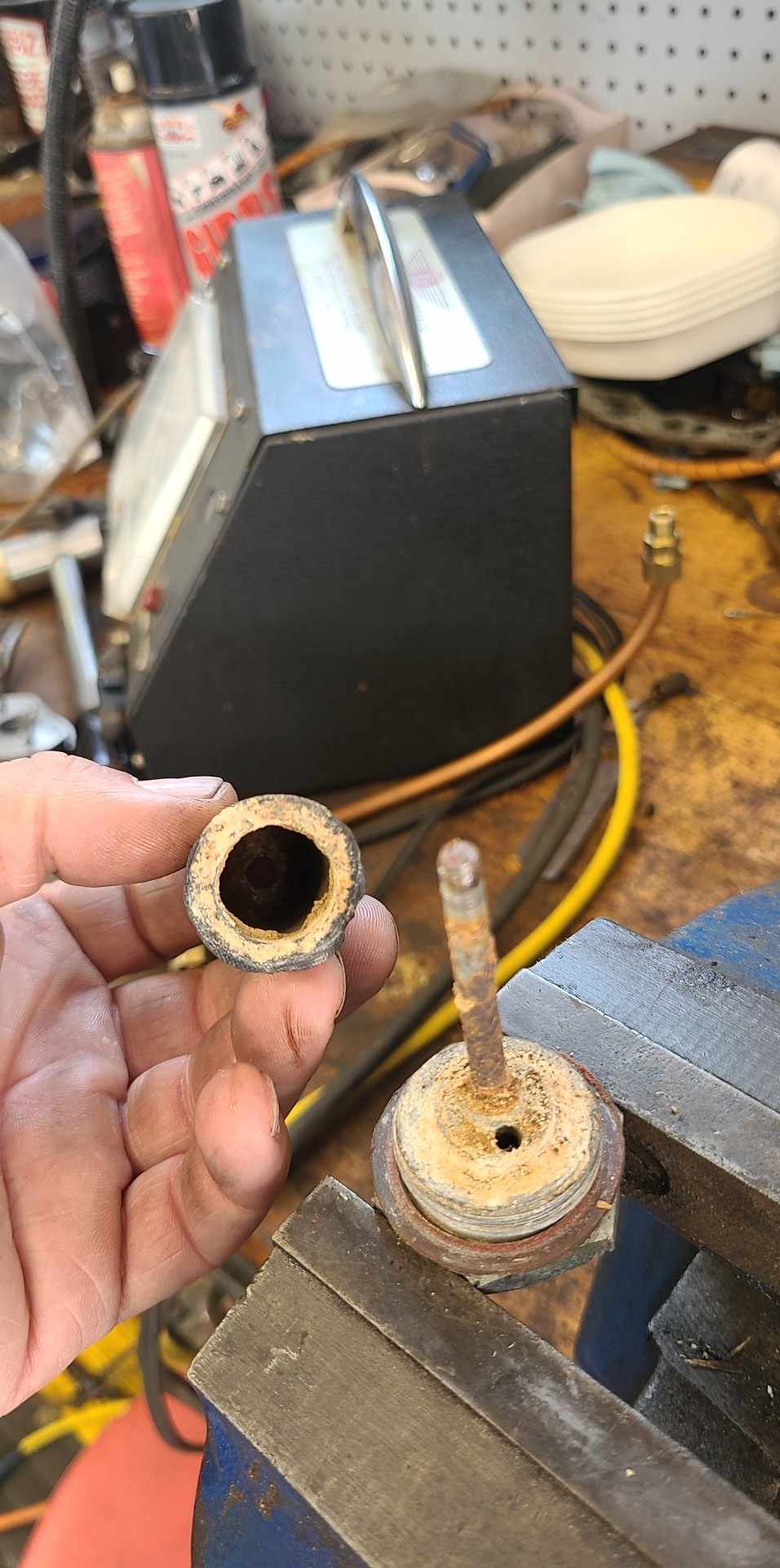

          Secondly is go through the fuel system a million percent. As in, clean the tank out. Then clean it again. Clean it about eleventy-seven more times, then clean it once more. By then it should be OK. fuel-filter
