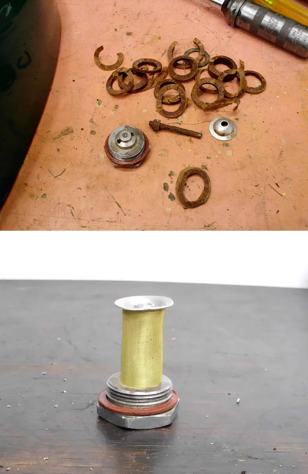

      Gas filter is gummed up and will not slide out of the tank. Anyone have any recommendations? Thanks,

        Use a solvent, lacquer thinner or some such solvent… it will break down the gunk, might take a minute
        #326860
        fastjohn
          When you get it off, use a small inline filter instead.
          #326870
            I had one that swell up for some reason. I had it out when I first got the motor – no problem. Had to get it out in pieces. Made a screen filter to replace it. Johns suggestion is so much easier.
