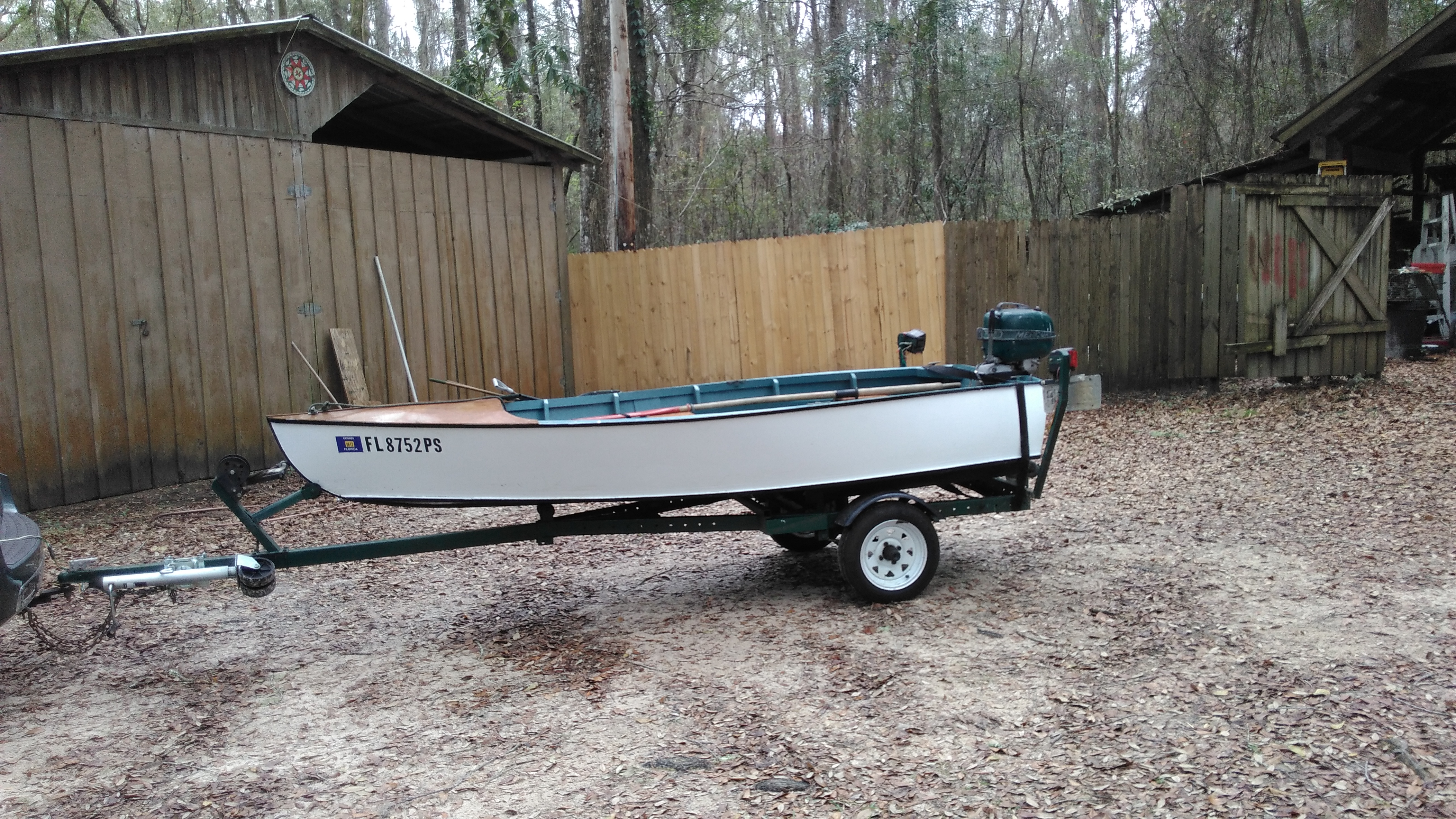

      I recently purchased a KE4 and it appears to have a Wizard 6 hp prop. (MB 2091 )) some one bored it to 9/16 inch . I have another MB 2091 prop and it has the 1/2 inch shaft hole. Well this prop is fast it will do 21 mph on my plywood boat . The correct KE4 K50 prop will only get to 19 mph. This is by boat speedometer. The General Purpose Wizard 6 hp prop is 7 5/8 X 7 and the K50 is 7 5/8 X 8. Why isn’t the K50 faster.

            That is one beautiful boat!
            Tell us about it.

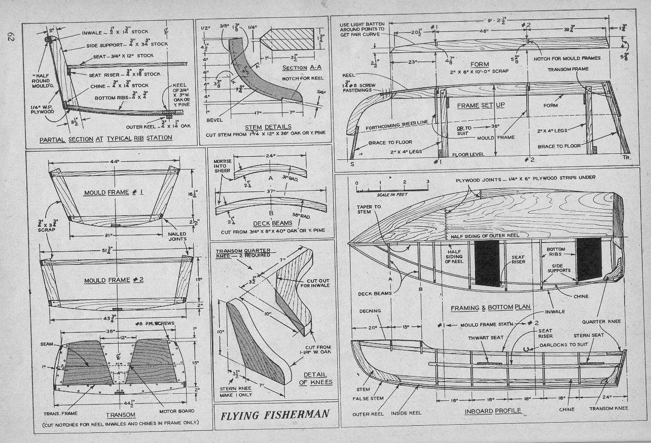

              I built the boat from plans on internet designed by William Jackson in early 1950’s. I used 1/4 inch fir plywood. I also ran my KG7 and it got a little unstable when it got to 26 mph on a windy day .
