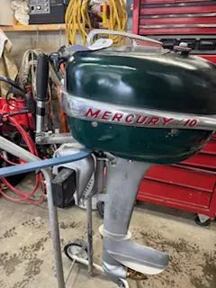

      Currently setting up a KF7 for a “daily driver” motor for my 1953 Blue Streak Runabout.
      B-Stock class, designed for a normal leg KF/KG or Quickie lower.
      I have a Quicksilver KG7, but would like to keep the wear as minimal as I can on that motor until I can afford to repair the L/U if needed, as I am newly in college.
      Currently, I am building up a nice KF7, but I have found the KG7 steering bar does not look right on the KF7.
      The KF has a front mounted bar while the KG has a rear mount. Is there a way to use the KG bar on the KF?
      Or should I be looking for a different style steering bar.
      Any help would be great, thanks!
      IMG_3425
      It is mounted right behind the tiller mount, and on the KG it is mounted behind the water jacket and cylinder head.

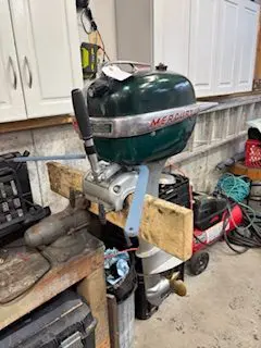

      IMG_3427
      Lower cowl still fits.

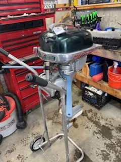

      IMG_3428

      #304521
      CHUCK WEBSTER
        The front mounted steering bar should be reversed.
        #304918
        COOPER
          The front mount bar is smaller in that it only has a slight bend. The holes to attach the steering cable have to be inline with the swivel pin to wok properly.
          #304919
          Aidan Smith
            Cooper,
            Yes, I have been informed of that. I am looking for one now. If I cannot find one, I am going to make one most likely.
