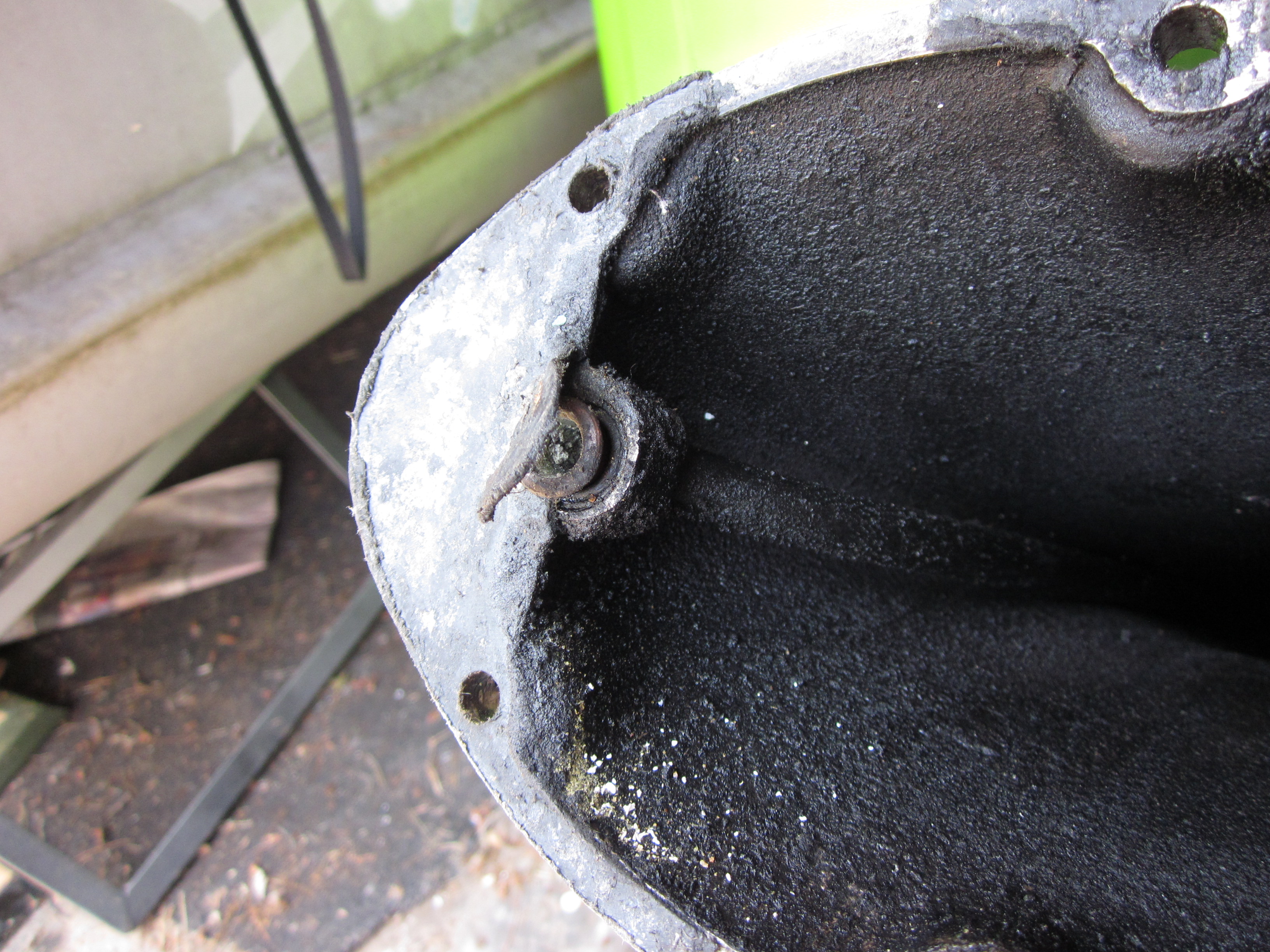

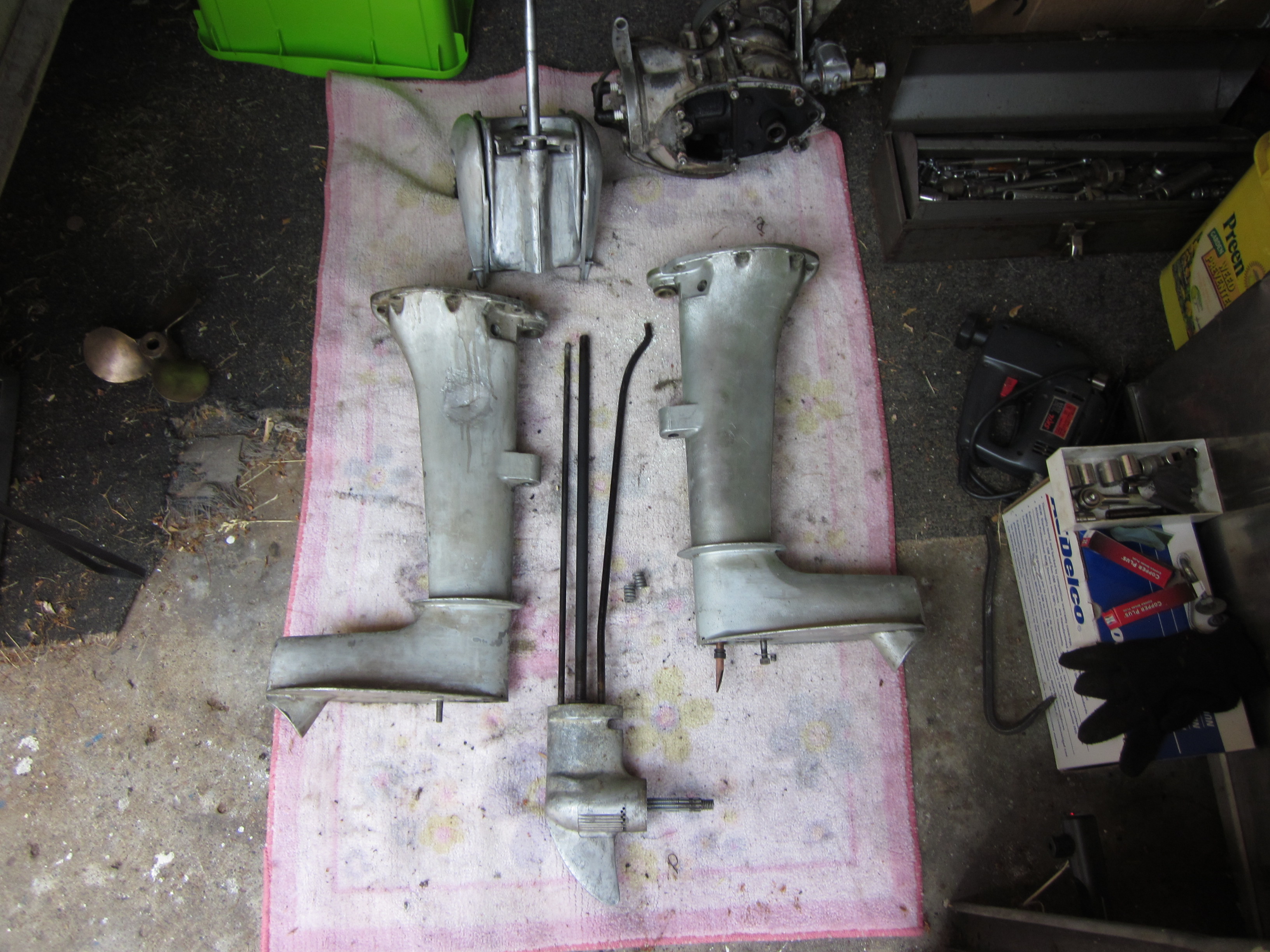

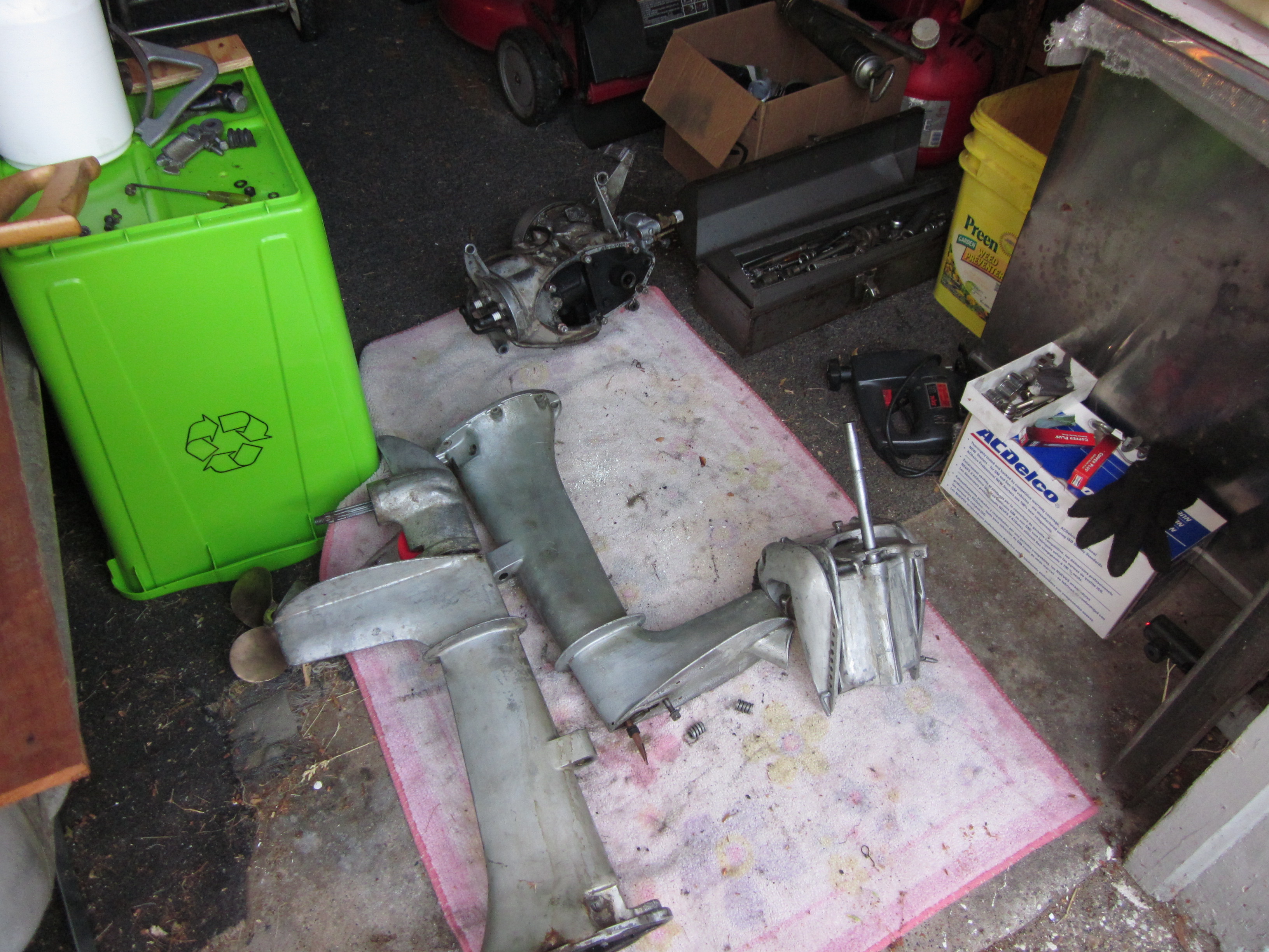

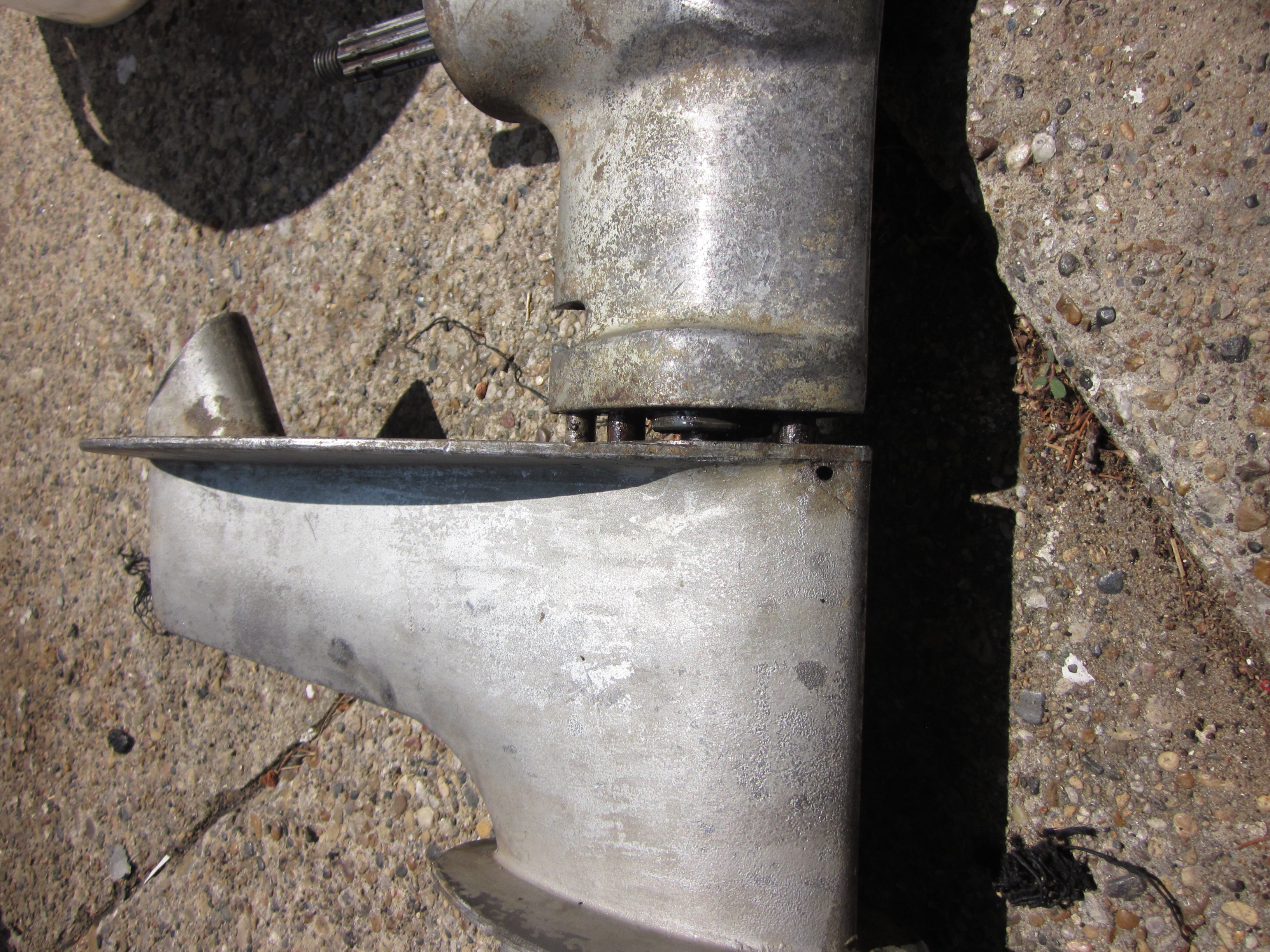

      Replacing damaged tower on Mercury KG4 is not going smoothly. No problem removing power head. Gear foot is loose from tower, BUT, water tube is stuck in gear foot.
      Tube can be cut and replacement made or flare at top of tube can be crushed in and hopefully
      reflared in replacement tower. Before I do that…
      Are there other ways to deal with a stuck water tube?
      Thanks
      Louis

            A few strokes of file on flare released tube.
            It might be easier to remove tube from replacement tower
            to transplant entire assembly.
            Just enough experience with copper and steel water tube corroded into gear case
            to know they can be real tough to get out.
            Fishing the tube in should not be too frustrating as there is access at top to see
            and finagle.
