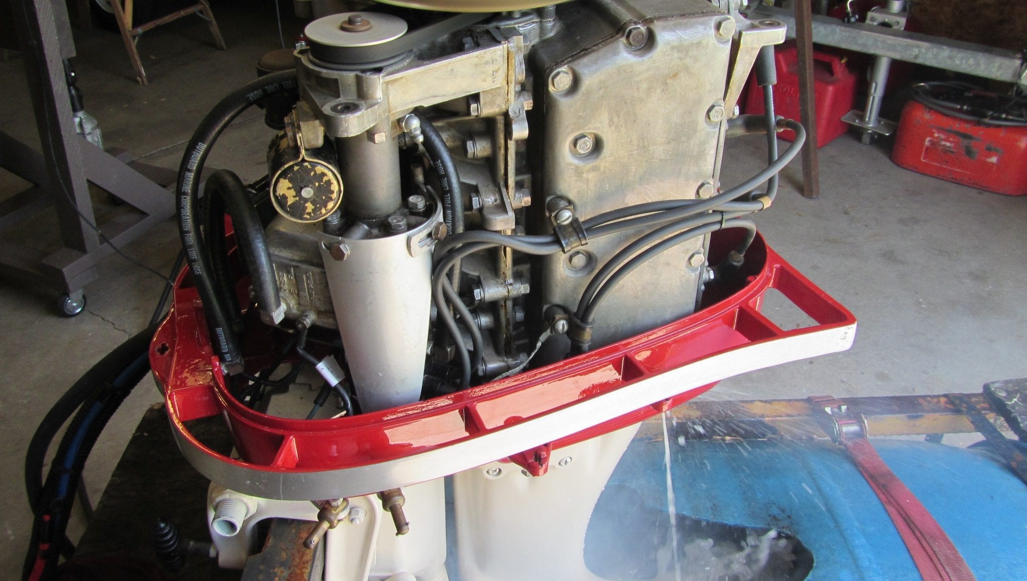

June 13, 2020 at 9:19 pm #205590bb, Here is a picture of our M55, (mine and my sons). This one is a ’56 model. I have been told that the teltail gets plugged. You might want to check yours! This picture is at first start and a fast idle. The stream has sense slowed down some but still visible. I also enlarge the opening when the motor was apart. Hope this helps.
dale
