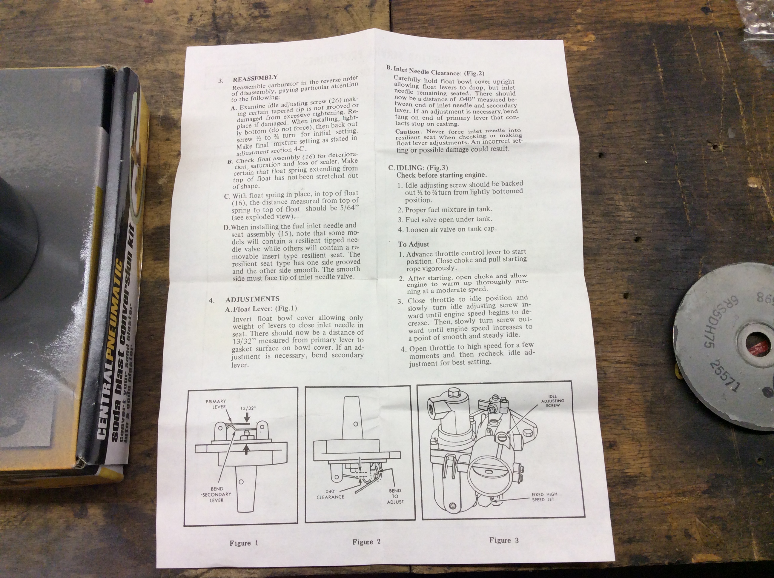

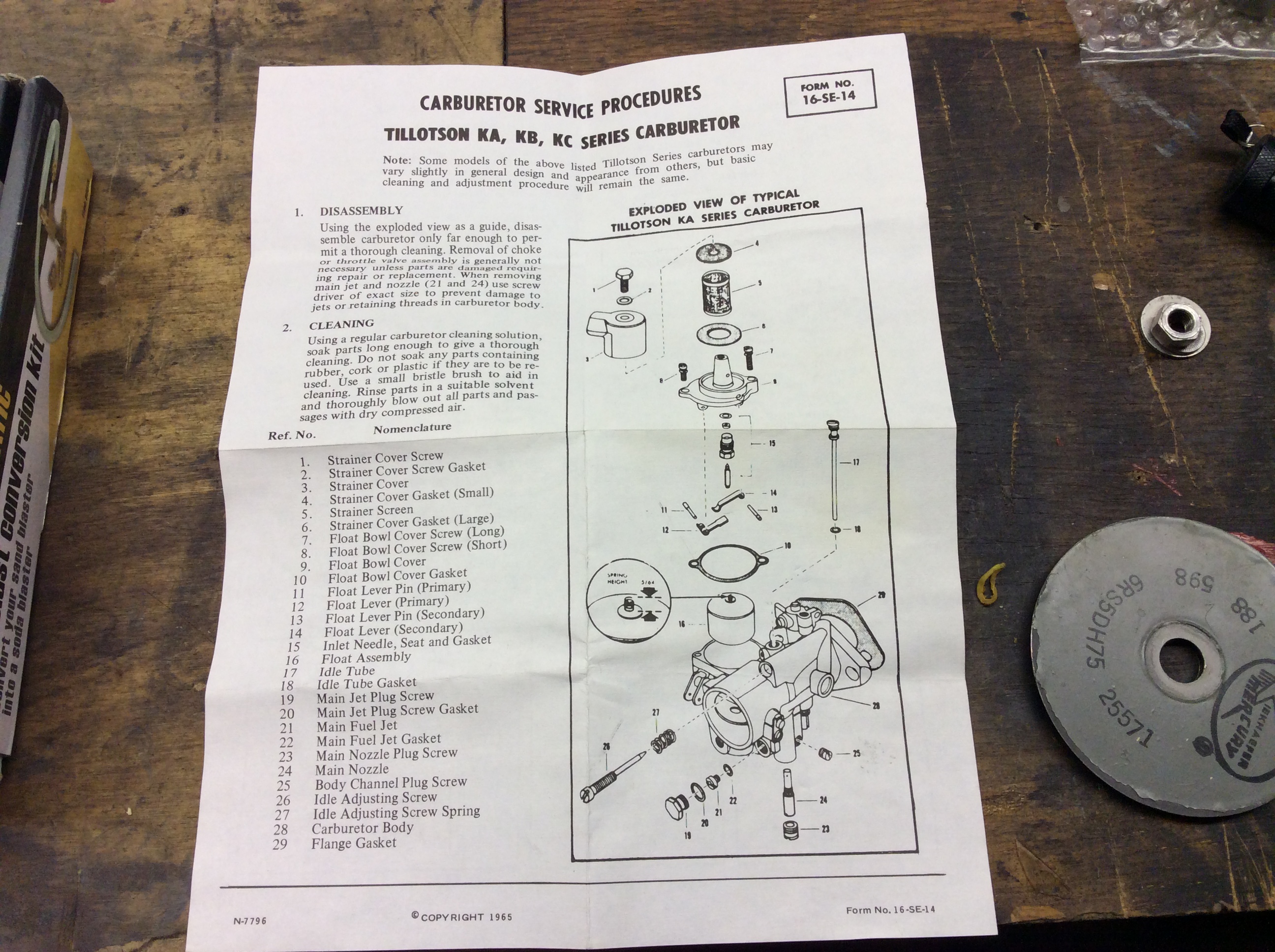

My 1st question did you run the motor before you rebuilt all accessories?
Make sure new gas
Check all easy stuff first which I’m sure you did.
You should have KA carbs when you rebuilt did you change out the rubber seat with metal?
Check timing
What type of mag kiekhaefer kd-1,2,3,4? Or FM do you replace all points condenser double check point gap.
Just a few thoughts.
Attached carb rebuild info what typ carb do you have? I run KA9at and on others ka2atTravis
