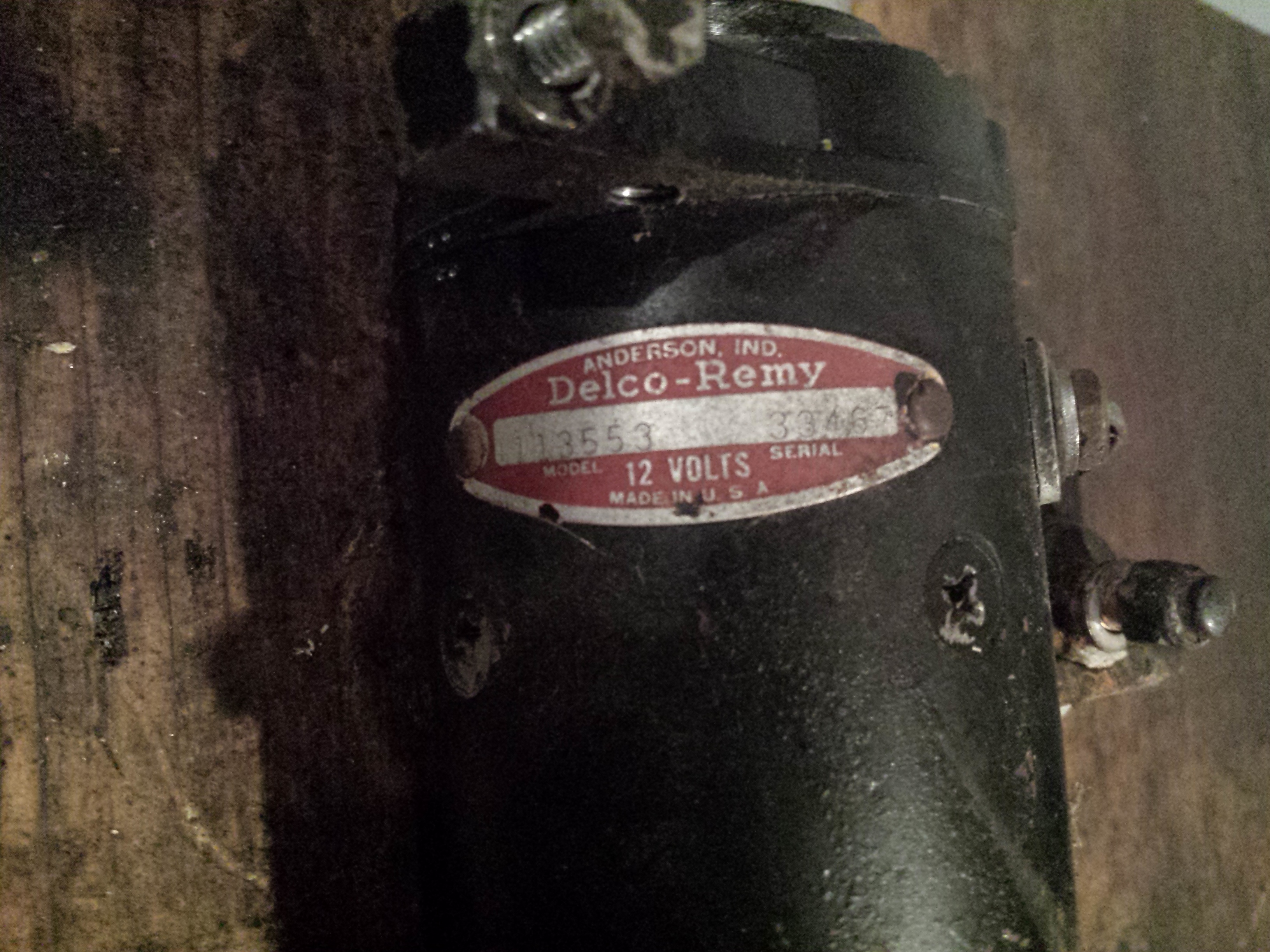

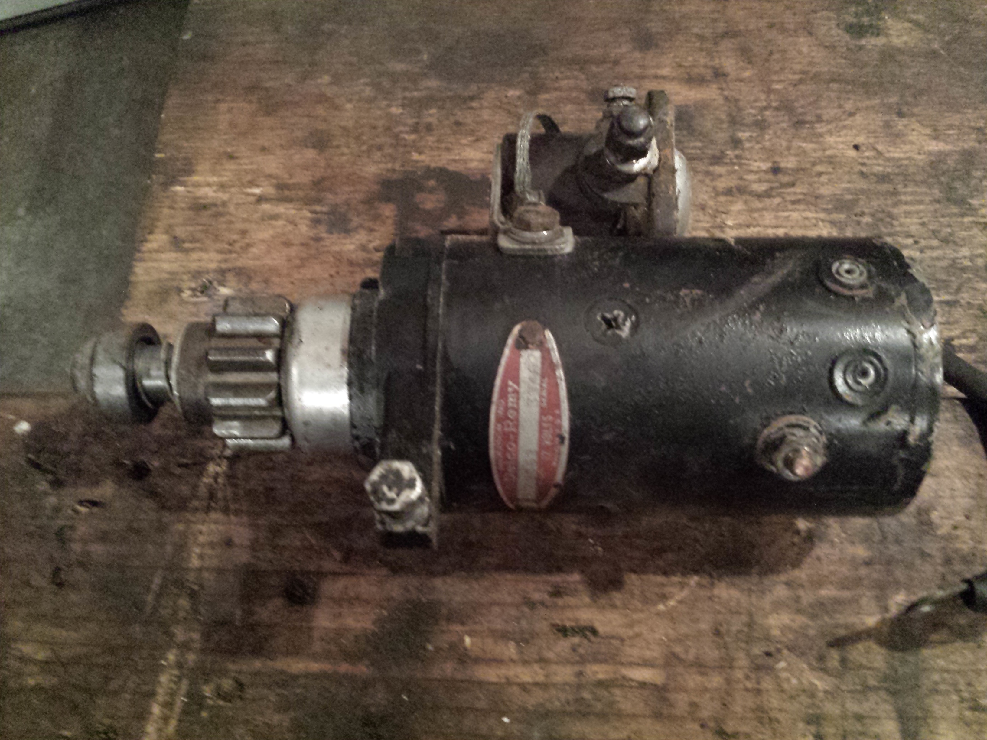

Hi everyone. Would a member know the part number for a Mercury Mark 58 starter rebuild kit for a Delco Remy model 1113553 starter? Thanks, James in Wisconsin
October 30, 2016 at 9:10 pm #46753James,
Do you have a few pics of the starter. Basically I take them apart clean well on the inside. Make sure brushes are still good, then button back up. Are you having troubles with the starter the way it currently is?

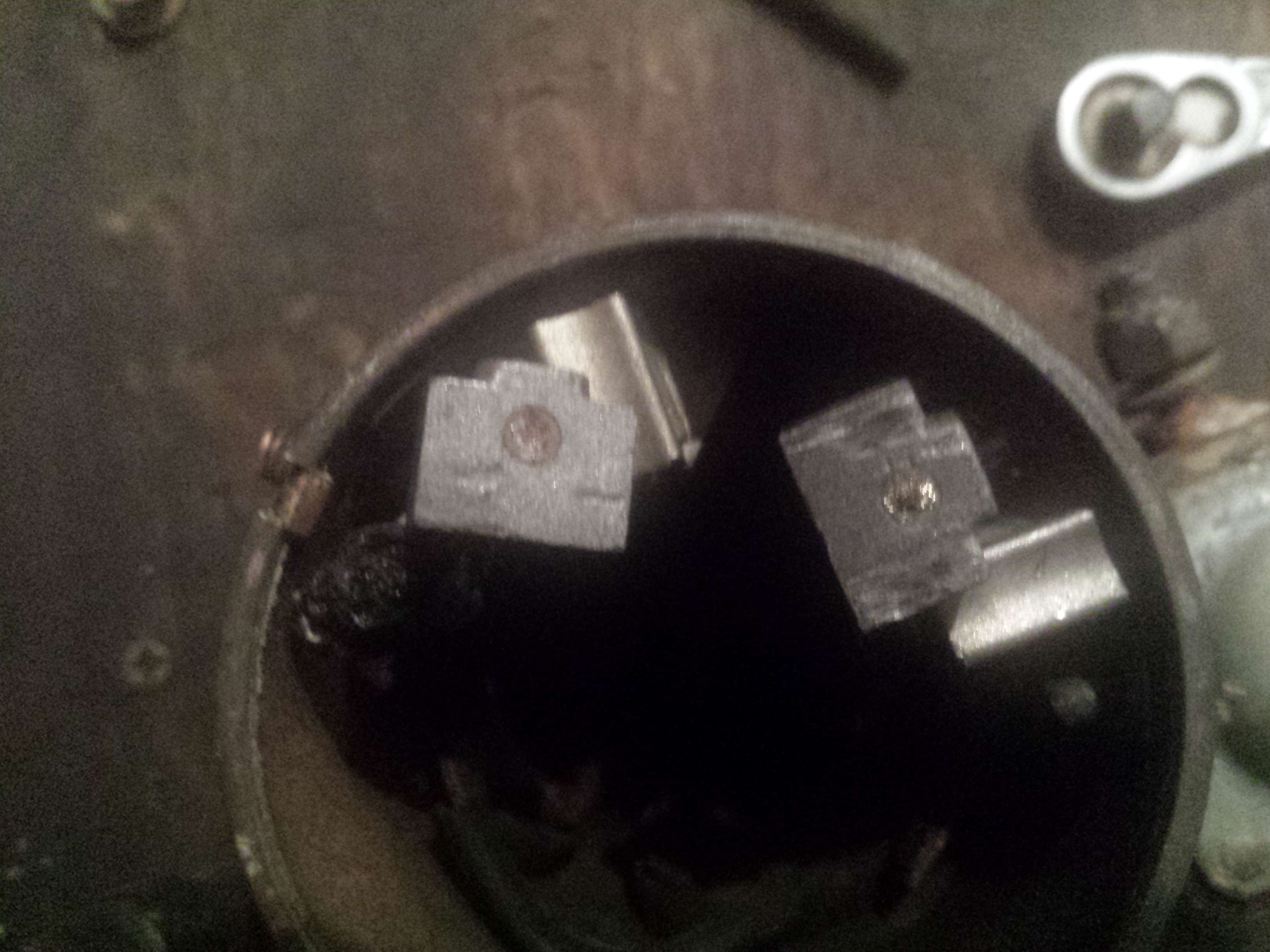

October 31, 2016 at 12:54 pm #46782October 31, 2016 at 5:10 pm #46789Those brushes ar very worn. I have had good luck finding a ‘competent’ starter/alternator shop to install new brushes in two old Merc starters. They should be silver soldered on. One of my old starters had been ‘monkey wrench’ soldered and the solder had let go. Best of luck
