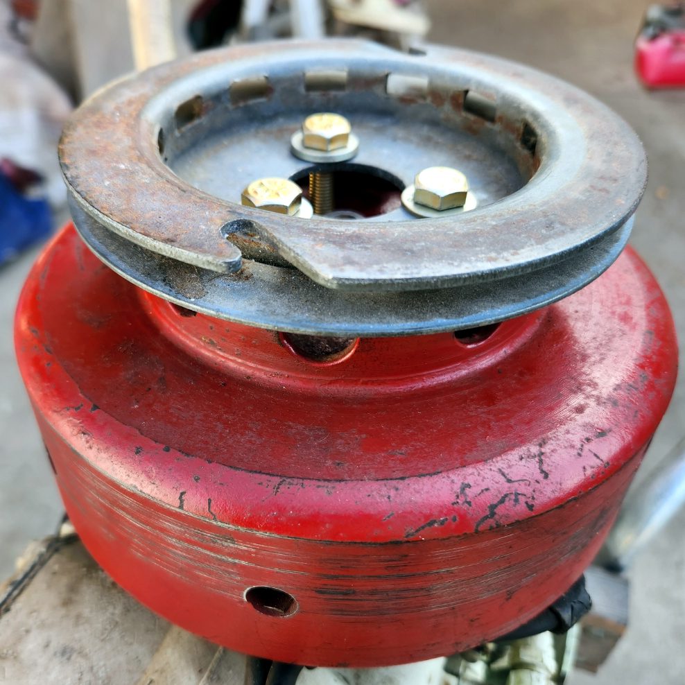

                  You have to wonder what the Mercury engineers were thinking when they designed that cowling with the recoil starter built-in.  Remove the cowling and you have no starter. Sheesh.
                  With a small engine like your 4HP….a simple adapter like is mentioned by Crosbyman will work fine.  Or you can find a suitable rope pull from some old engine and adapt it.  The picture I have shows one from an old Scott Atwater 3.6HP but there are many others that will work .
                  Or….you can buy a custom starter with a built-in over-running clutch.  There are adapters available for your electyric drill that would provide the added safety of the clutch.  A bigger concern with larger engines though.  Not so much for your 4HP.
