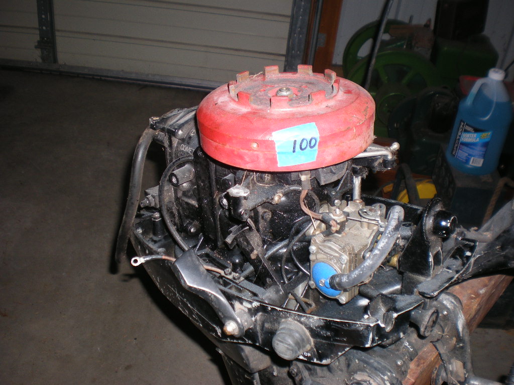

I only see a serial number on this Mercury part motor.
It’s a twin cylinder, probably about a 7.5hp. Comet is
printed on the block. It’s serial # 5145303.
Would like to come up with a year, model and HP.
Help appreciated. I looked at some serial number
data online and the closest I came up with was
an 80hp …… NOT.Prepare to be boarded!
November 17, 2015 at 3:51 am #27228My guess is 1978 Model 75M.
November 17, 2015 at 4:43 am #27231That serial number places it in the 1978 year. 7.5 hp. would have "Comet" printed on the block. Wonderful little motors!
Steve
November 17, 2015 at 1:40 pm #27239Thanks Guys! Now I can look up what’s missing
by the loose wires….. coils I suppose!Prepare to be boarded!
November 17, 2015 at 3:33 pm #27242Looks like you’re missing the power pack and coils. I have some used coils if you need some…
