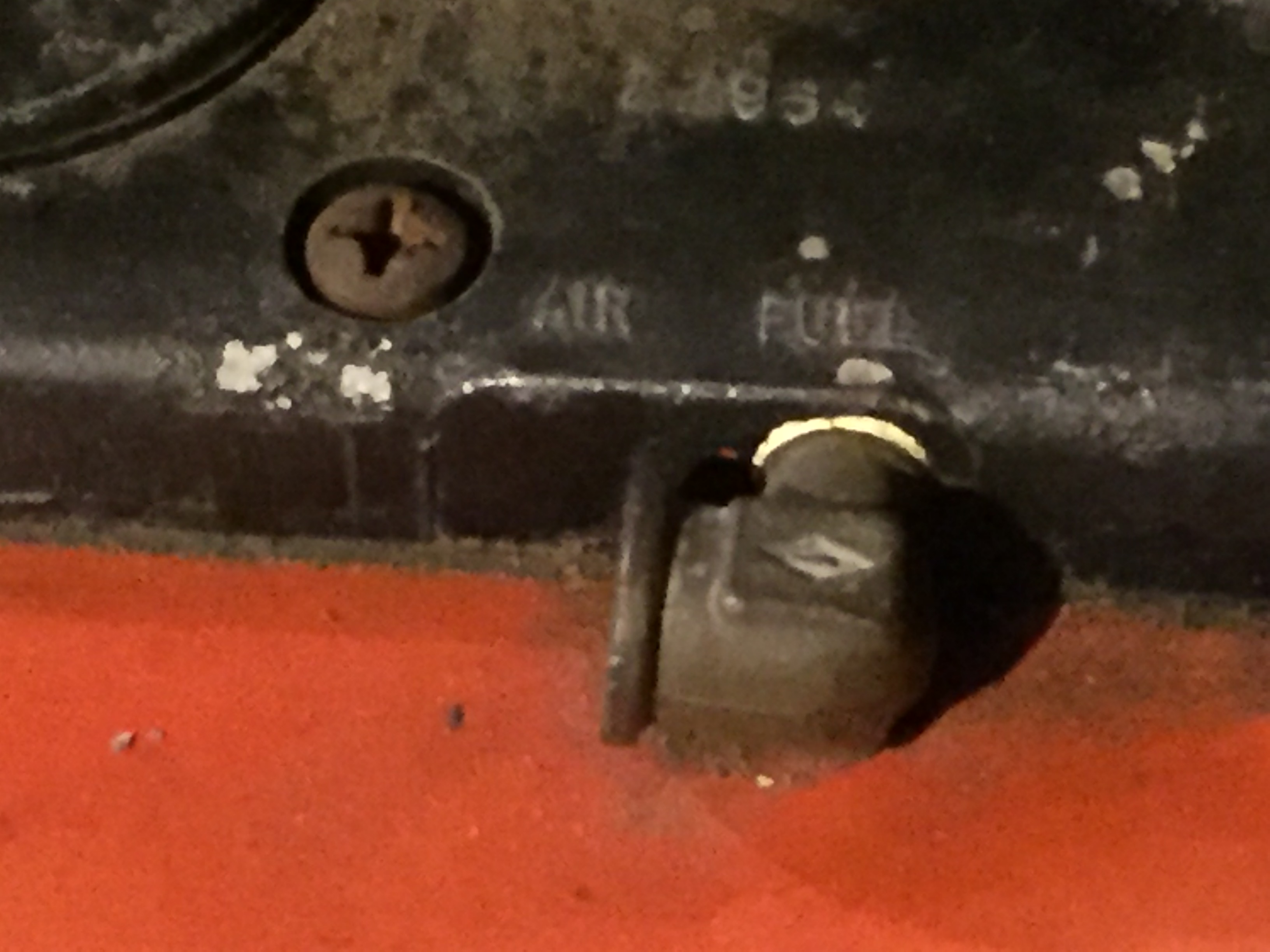

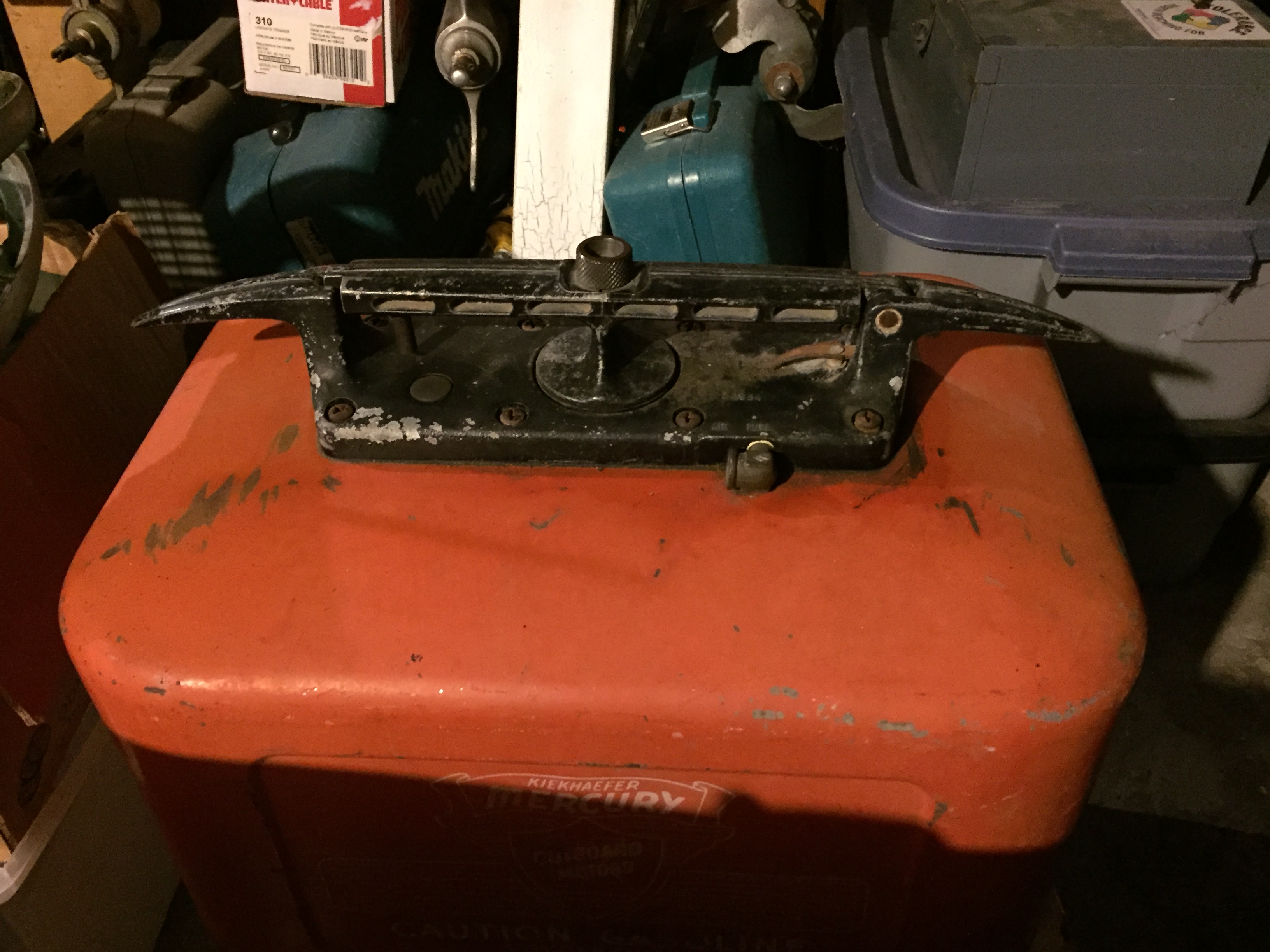

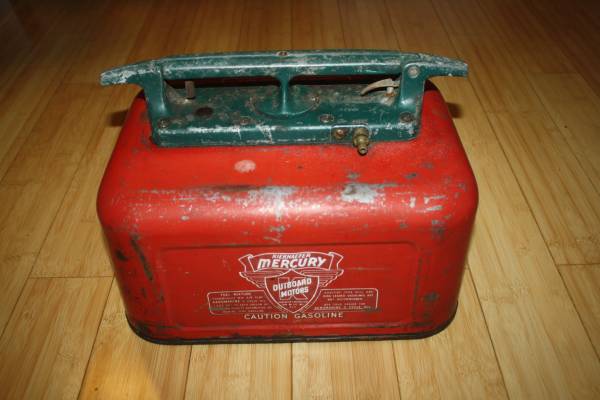

      Before I go look at this, I’m trying to asses this tank for a fellow member, and because I have no experience with Carl K’s version of the pressure tank I did a little reading. I see that the air fitting is plugged.and am guessing this is a leftover tank that was made into a non pressure tank with the trigger primer instead of a bulb .I also note the ears seem to be shortened perhaps because they broke off and were filed to match? I know the fitting is pretty rare too.

        Wedgie,
        My understanding is that this is a small tank that was used primarily with the mark 20H model. The ears were that way from the factory, I believe, to trim weight. The air hole may have been plugged to convert it for use with a single line and a fuel pump, although I believe the mark 20H did not come with a fuel pump.
        Later when Mercury put fuel pumps on most of their motors, those tank tops continued to be cast with "air" above the spot where a hole would have been to accommodate the air line. I should have a photo and I will try to post it here.
        There are many Mercury experts here who will chime in and let us know for sure.

        wedgie
          Being that the air inlet has been plugged, I worry some bits may be missing inside.

              #49379

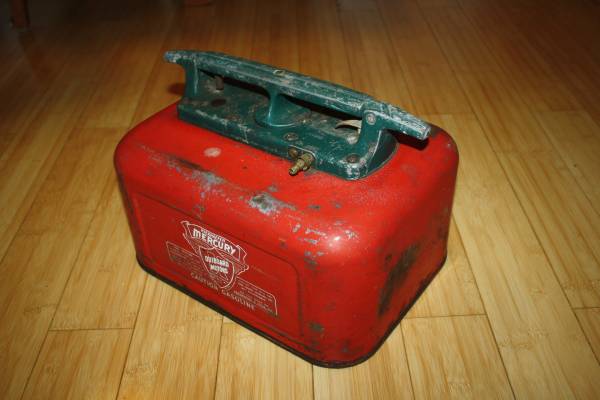

                could have used it for this. this is what they were made for . this tank has been modified.to non pressure. as done it wont work it has no vent.

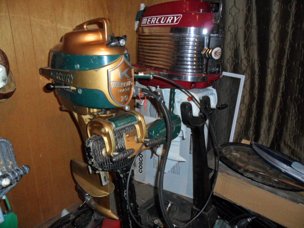

                #325152
                This is a very old thread, however, cleaning up and I found a very old Mercury Mark 15 outboard complete with it’s original 2-line pressure tank. I cleaned out the tank, added and 1 gal Fuel & TC-W3 Oil mixed 16:1 and low and beholden the old bugger fired right up. I only ran it a few seconds but at least I know it fires/runs. What the heck does a guy do with these things ?
