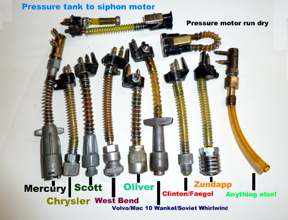

                #46427
                  I also do it with my single line tanks.
                  #46434
                    Here’s a variety of adapters for running a variety of different motors off a single line OMC tank.
                    I believe credit for this photo goes to the late Art Sesselberg.
