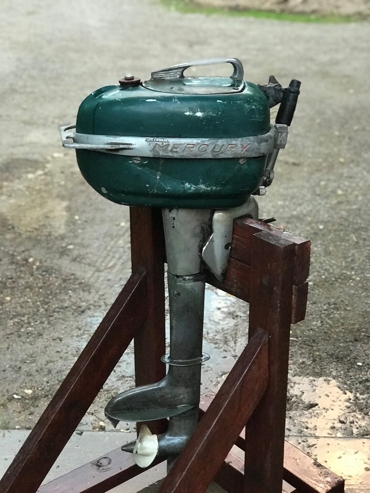

      Thanks for all your help on this site. I am so glad I joined AOMCI and this site and forum members are a great resource. I acquired this little Mercury for free and after cleaning it off and removing the mice nests inside, I was able to get it started after about 50 pulls. I took my time and was patient with it. It had the healthy thump thump and kept almost wanting to go until it did. Anyway, it idles decent and slides up to full throttle OK but not great. I would like to give this one the once over mechanically and cosmetically but have no idea where to start in terms of a good resource(s). I’ve only worked on OMC. Perhaps purchase a service manual? Thanks in advance for any thoughts on where to go first for a beginner on Mercury’s.

      #205215
      green-thumbs
        Not my favorite Mercury, but, from what I am told ,nice motors when they run. That said, I would make two suggestions 1) Illustrated Parts Manual would be very informative 2) Do not run motor until impeller has been checked. Service manual are helpful IF you keep in mind that they were intended for experienced mechanics,working on relatively new motors using factory tools. Parts manual shows you what is inside, gives you an idea of their relationship and give names and part numbers.

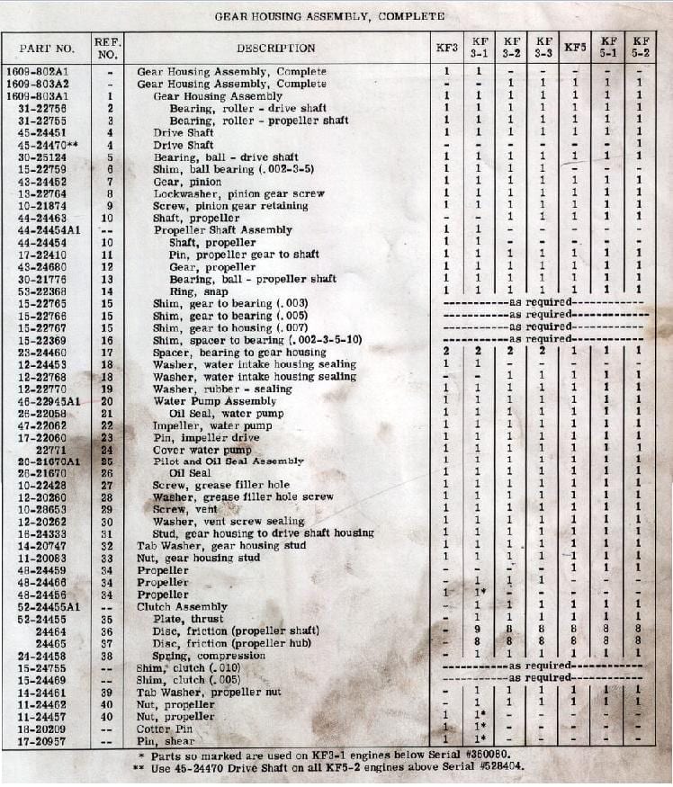

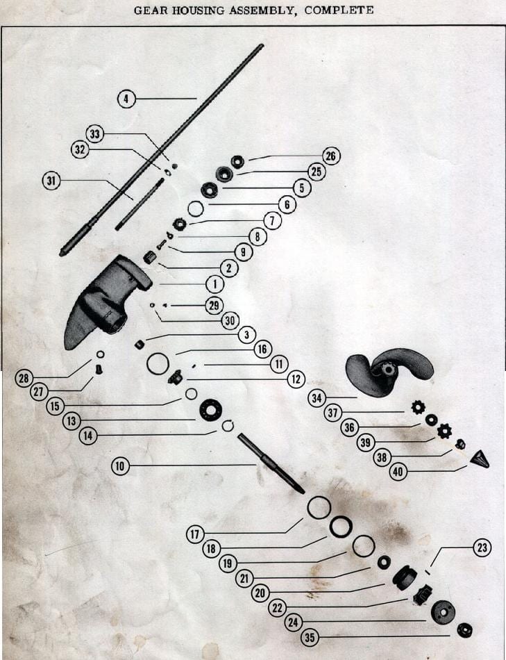

          #205224
            KF5-Gear-Case
            KF5-Gear-Case-List
