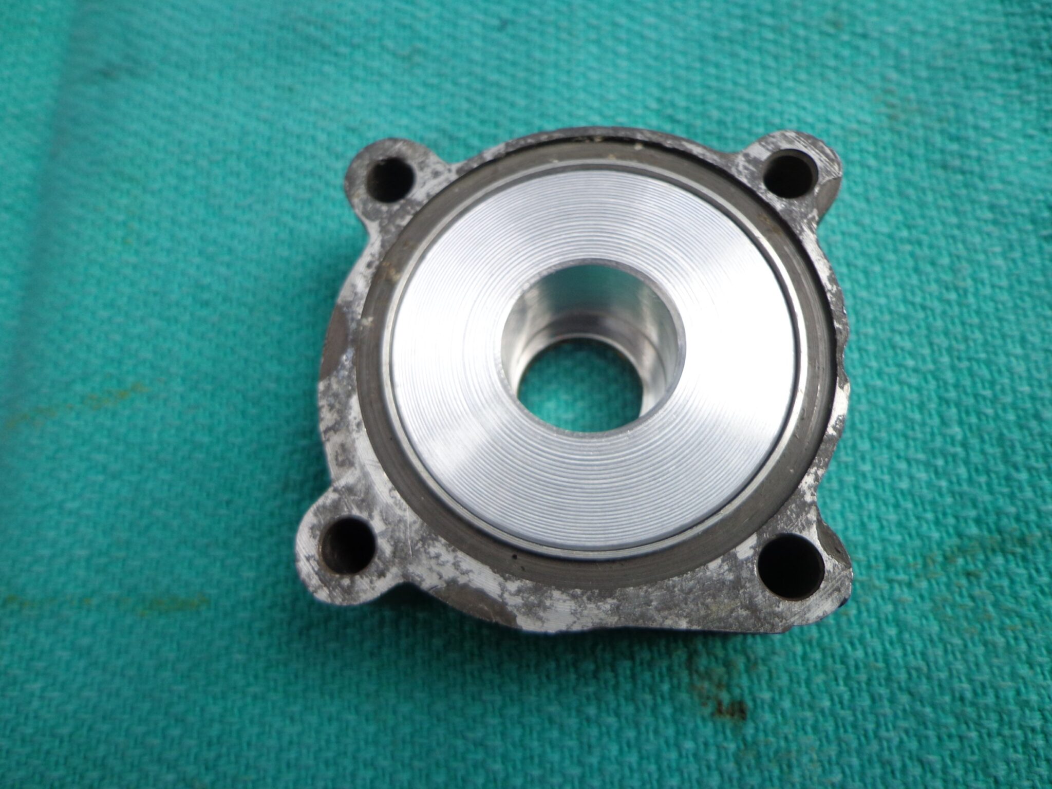

              I blanked off the bailer pump by fitting an aluminum
              “hockey puck” like piece in the cavity (not a photo of my motor)
              like in the photo.
              Bailer-Pump-Blank-cartridge

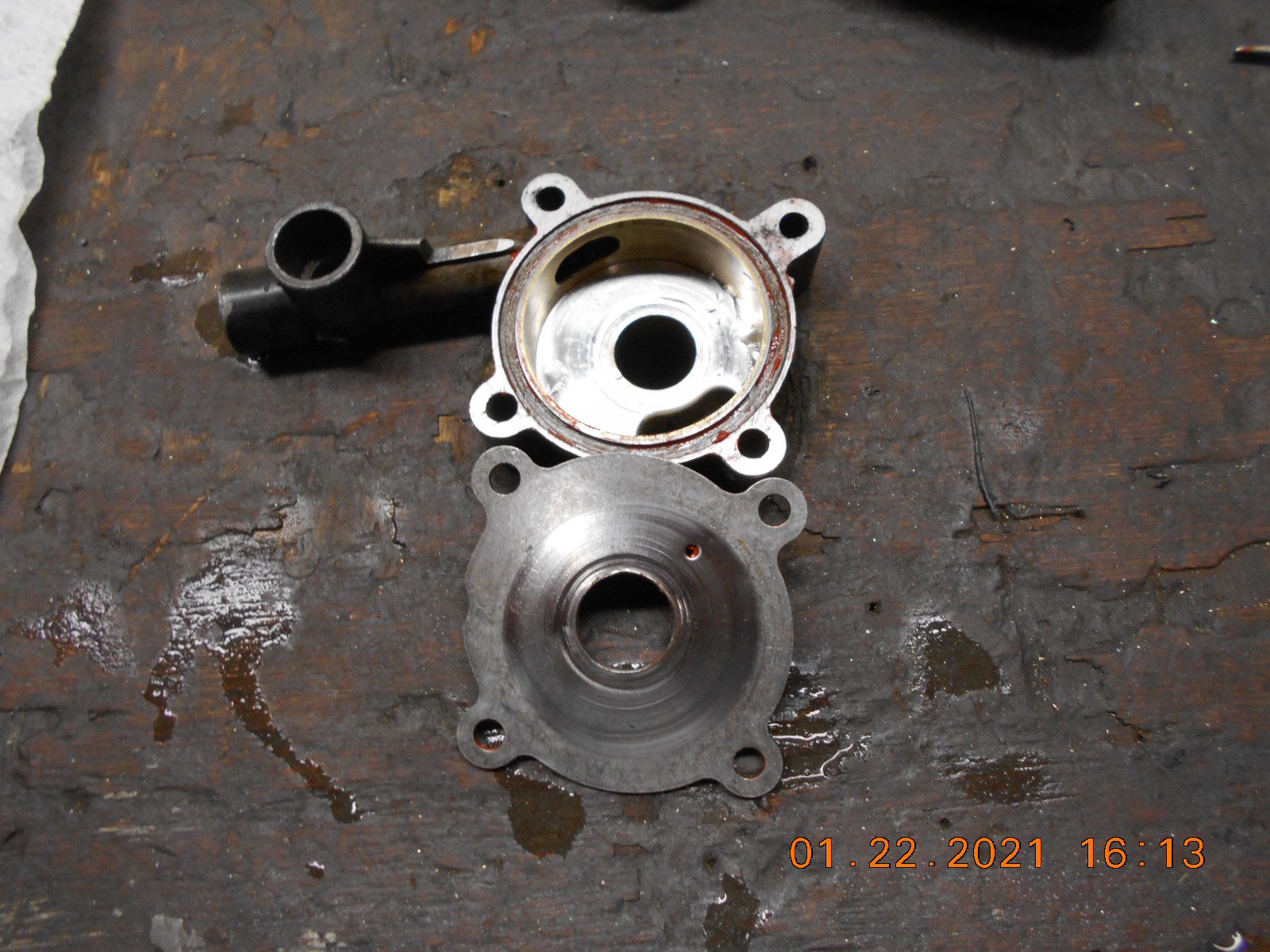

              A photo of my pump with the homemade brass liner on the sidewall of the
              pump cavity.
              DSCN0271
