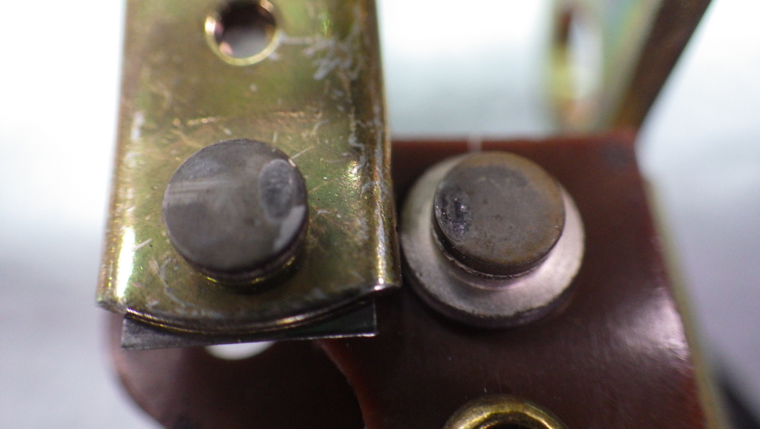

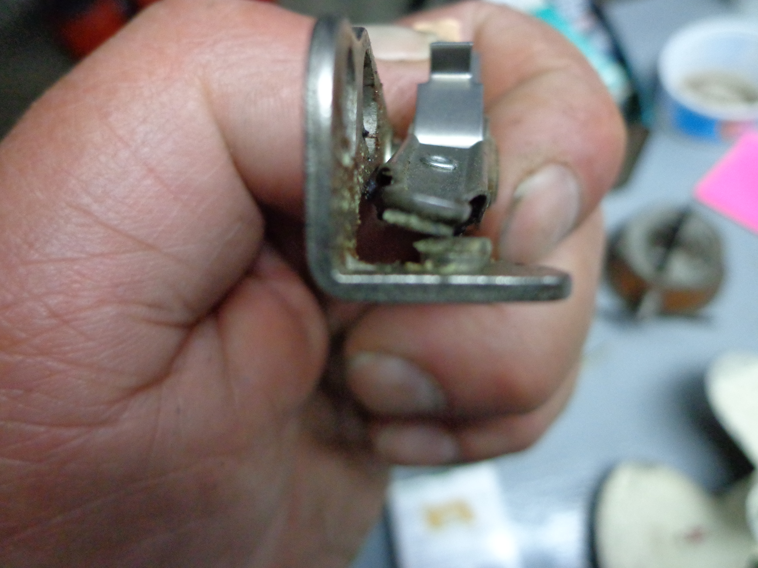

So I yanked the flywheel off my dead CD-25 to find the points corroded, but only on the 1/3 or so of the surfaces that actually make contact. They seem to be aligned OK, but the surfaces meet at a pronounced angle. Is there a fix, anything I can bend or tweak to assure full contact ? Or do I just need to find a new and better set of points ?
August 3, 2016 at 11:22 pm #41548August 3, 2016 at 11:41 pm #41550Mine looked like the third picture, without the big-time crud. Thanks
August 4, 2016 at 7:14 am #41572quote retiredoz:So I yanked the flywheel off my dead CD-25 to find the points corroded, but only on the 1/3 or so of the surfaces that actually make contact. They seem to be aligned OK, but the surfaces meet at a pronounced angle. Is there a fix, anything I can bend or tweak to assure full contact ? Or do I just need to find a new and better set of points ?"Full Contact" should not be your goal. In fact, your 1/3 contact sounds good. If you are into cleaning and polishing them, you will probably find that you wind up with just slightly convex surfaces—that’s a good thing. The contact really should be somewhere near the center of the point, but truthfully it isn’t the big deal it is made out to be.
August 4, 2016 at 4:50 pm #41586My minor concern was about setting the points using a feeler gauge when the contacting surfaces are not parallel. But now I suspect that doesn’t matter much either. Maybe my basic difficulty is visualizing an ignition component could actually have excess capacity. .
August 4, 2016 at 5:21 pm #41588The points gap in itself is not important. What is important is WHEN they open as the flywheel magnets pass by the coil. Setting the gap to .020" gets them very close to the correct time by establishing the time they strike the rise on the cam. "Close Enough" as they say.
August 5, 2016 at 1:39 am #41610‘Close enough’ is right in my wheelhouse…Thanks, Frank
