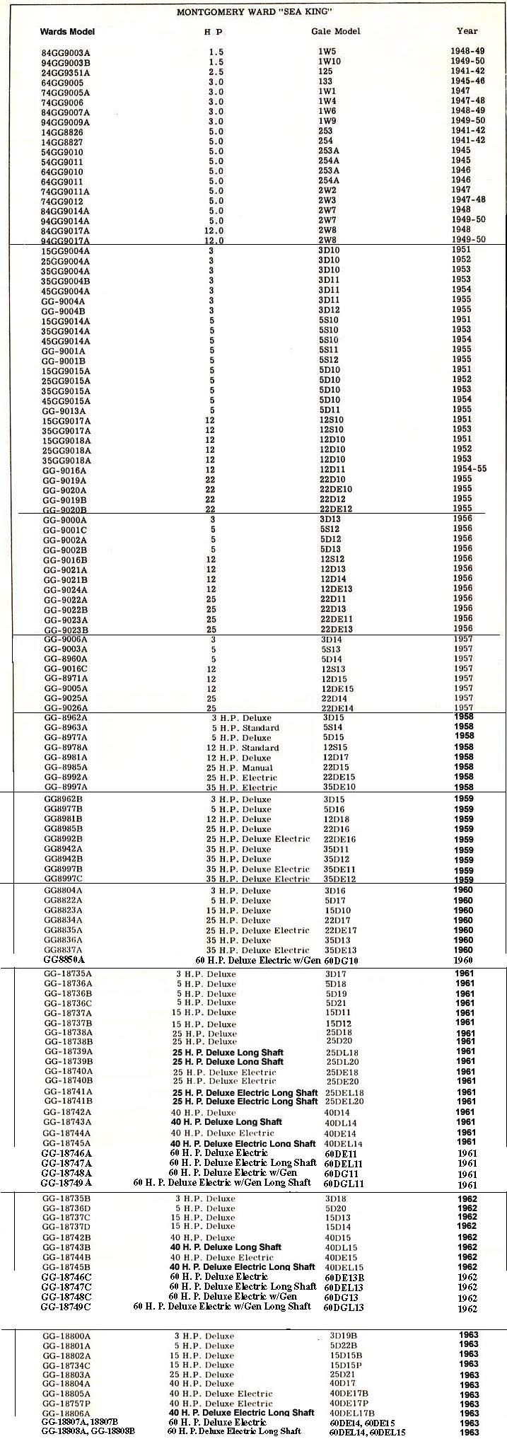

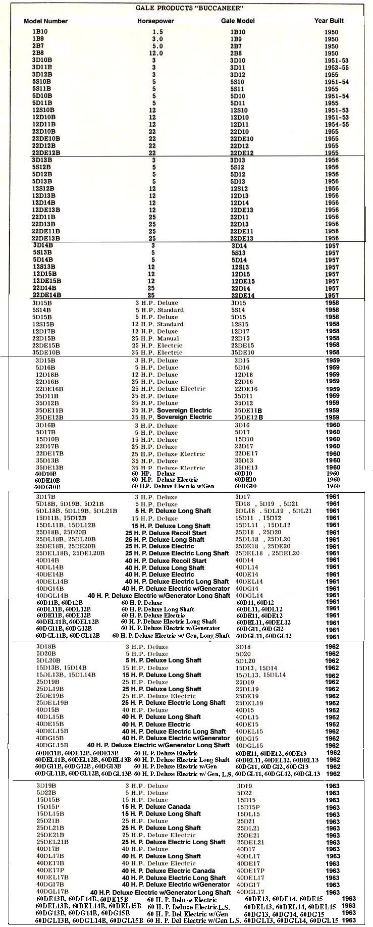

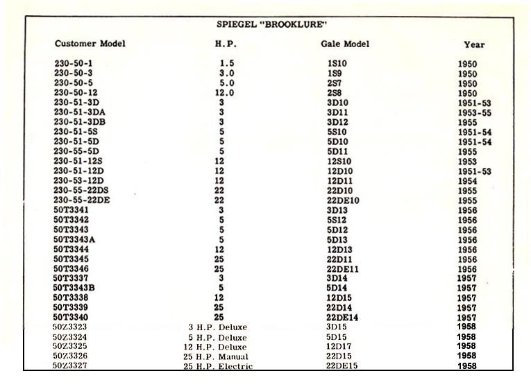

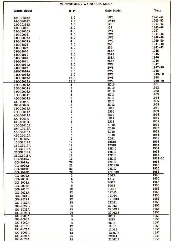

          #291917
            Here ya go……….
            Gale-Buccaneer
            Montgomery-Ward-Sea-King-thru-1957
            Spiegle-Brooklure
            There are more……
