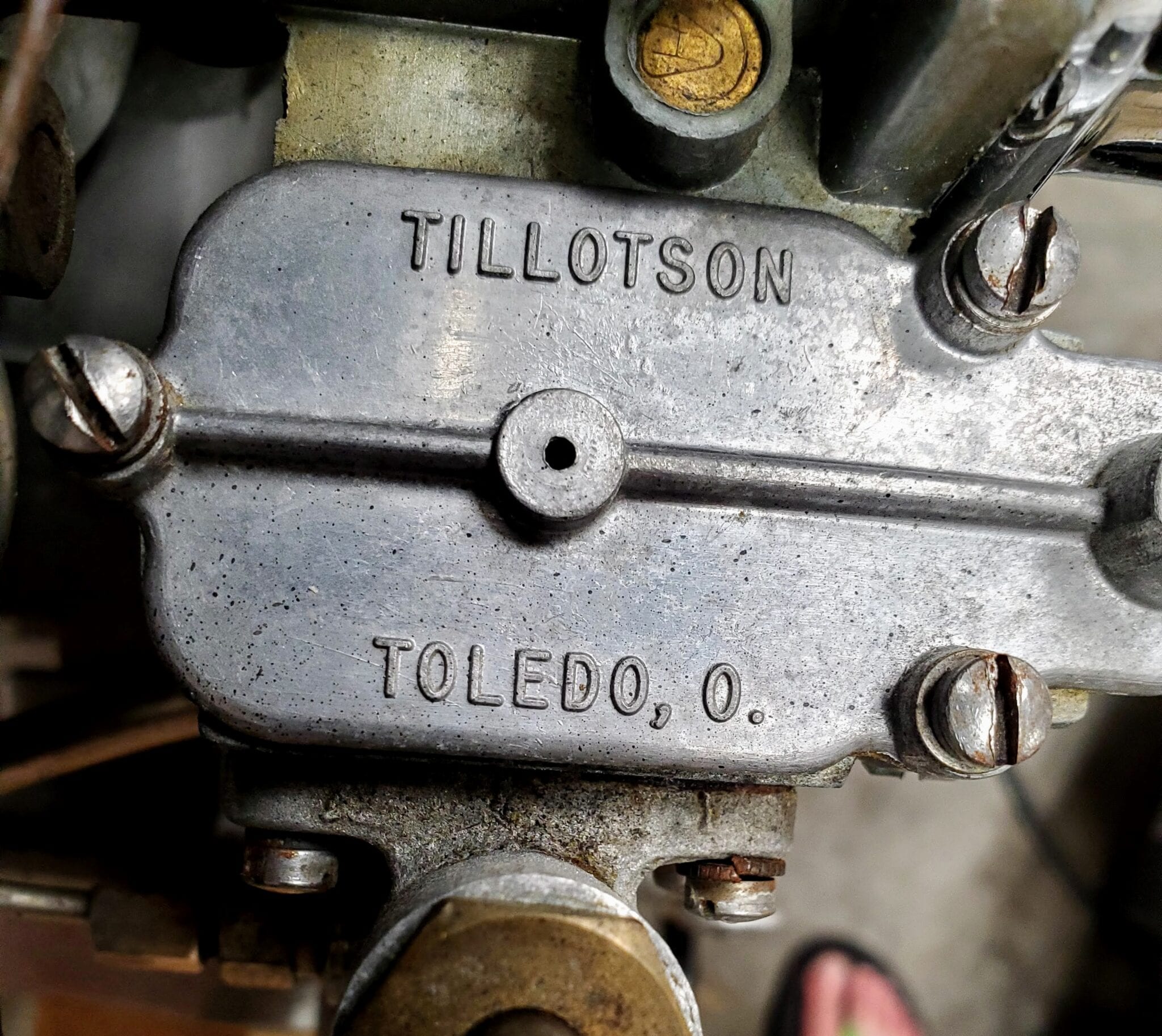

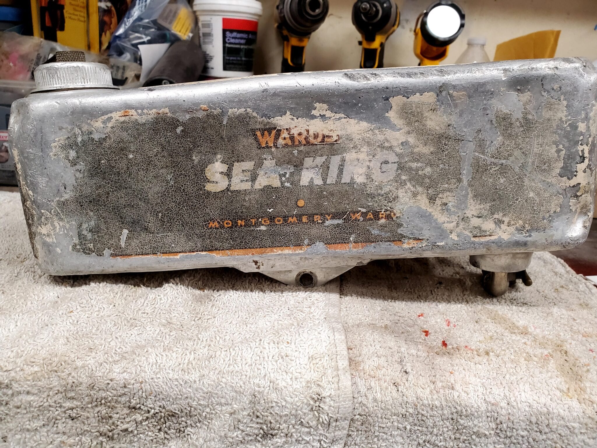

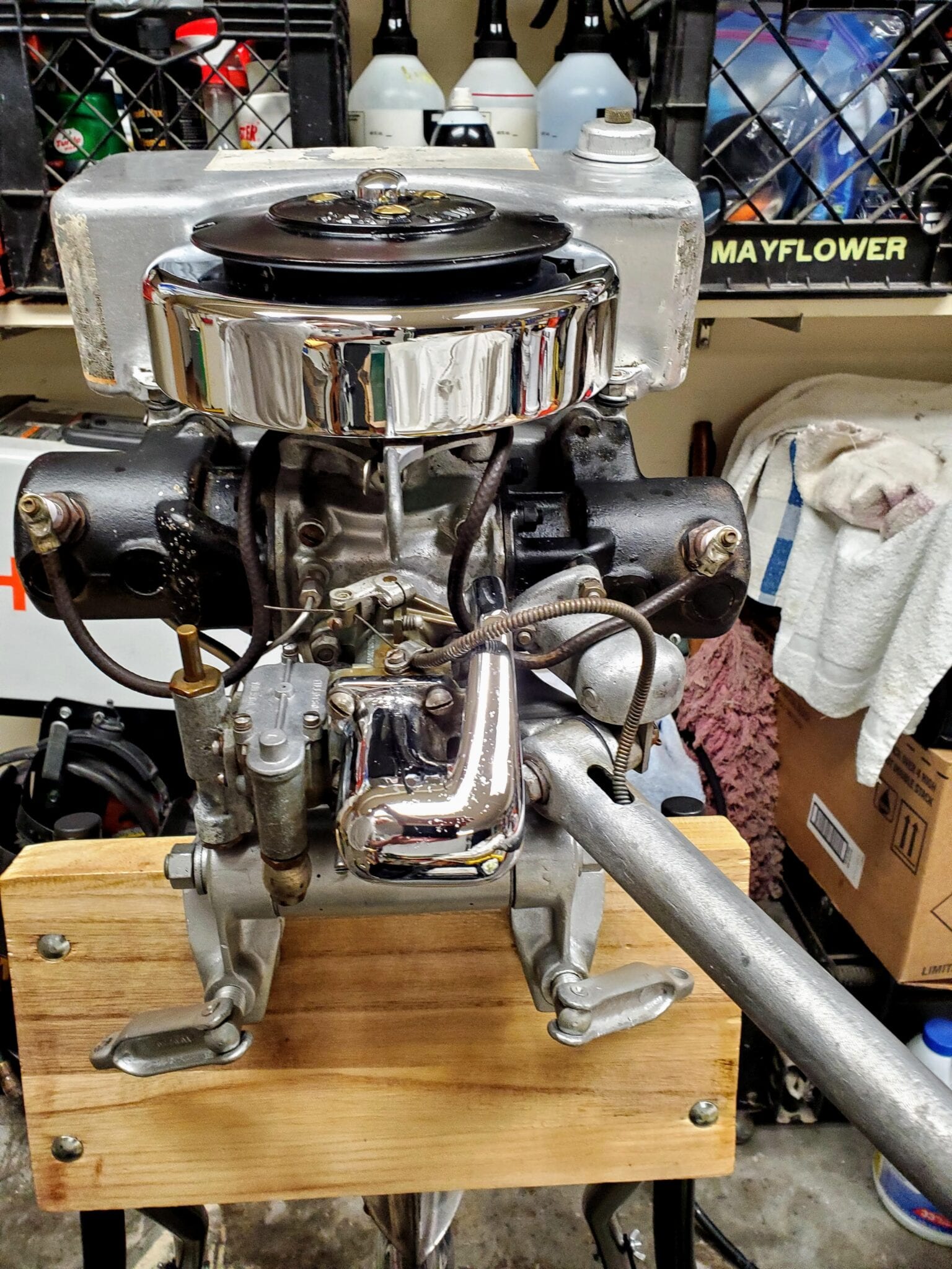

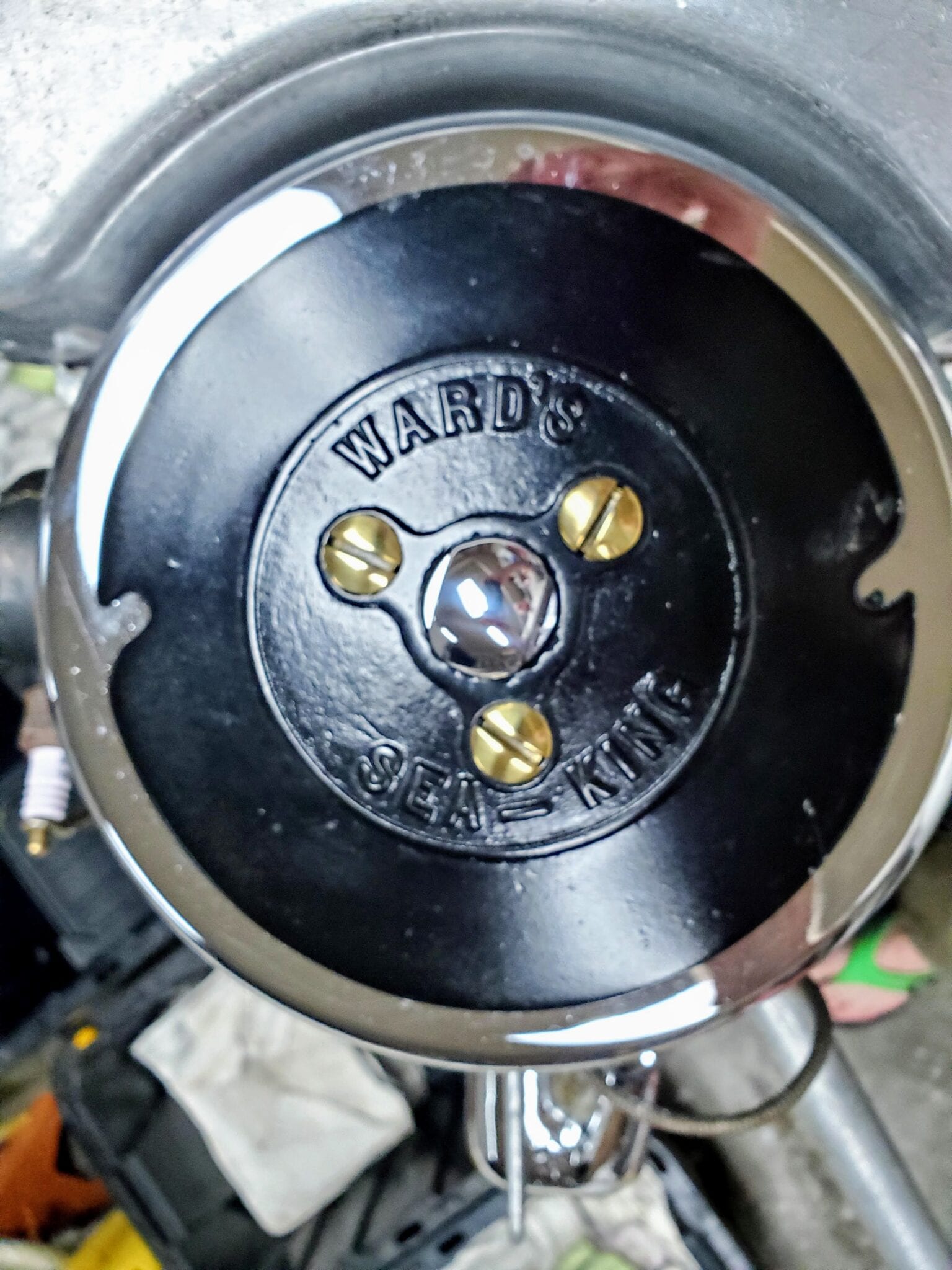

      So, I got this for a Fathers Day gift, and other than knowing the name (growing up on the Puget Sound in the Seattle area), I know next to nothing about this engine. What makes things worse, I can’t seem to find anything that represents the model number, or such. I can find a bunch of numbers (which I think are part numbers), but nothing that I can correlate back to a model. the motor appears to be in good shape and someone has already started a re-store, and I would like to finish it, but obviously can’t do that, if I don’t know where to start. I am attaching photos in hopes of someone being able to steer me in the correct direction.
      Thanks in advance for any help you all can lend here.
      If these photos are not helpful, please let me know which ones you need.

            I suspect the tag has fallen off or been removed.

              This could be your motor with the front cover missing.

                Thank you Boat House. There are definitely similarities, as well as differences. Mine doesn’t look like there are the screws available to attach a cover to it?

                  I think you will find the model number and serial number combination stamped into the lowest edge of the crankcase below the starboard cylinder. Use a flashlight. The number is not cast onto the metal , it is stamped into the metal. My version of your motor is the same except it has a poppet valve carb which makes mine a 8 HP. Yours is 8 1/2 HP with the fancy carb. Mine is a 1933 model 417 with the same crankcase (electric start) as yours and same spring dampened steering handle mount etc. Your tank is a keeper with those nice original decals. Are any decals visible on the ends of the tank??

                    Thank you, I will take a look tonight. I have noticed that all the part numbers (I have found) are stamped directly into the metal as well. I have all three decals on the take in about the same condition as the rear-Legiable if you squint. I am glad they are keepers because I bet it would be a bugger to fun some repos

                      So I found the model number and it is in fact a 492. My question is, does the 0051 indicate the exact year. The 492 spaned multiple years?

                        The 0051 is likely the serial number of your particular motor.
