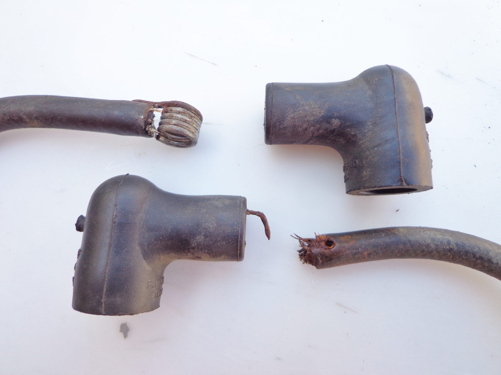

February 28, 2023 at 1:42 am #273263The spring terminals inside the plug boot which snap onto the sparkplug can cause issues as they can get cotrroded and loose contact with the core wire, They may pass an ohm reading but wont have enough contact to carry the volts needed to fire the spark plug. It might be an idea to slide the boots back and see how everything is in there.
