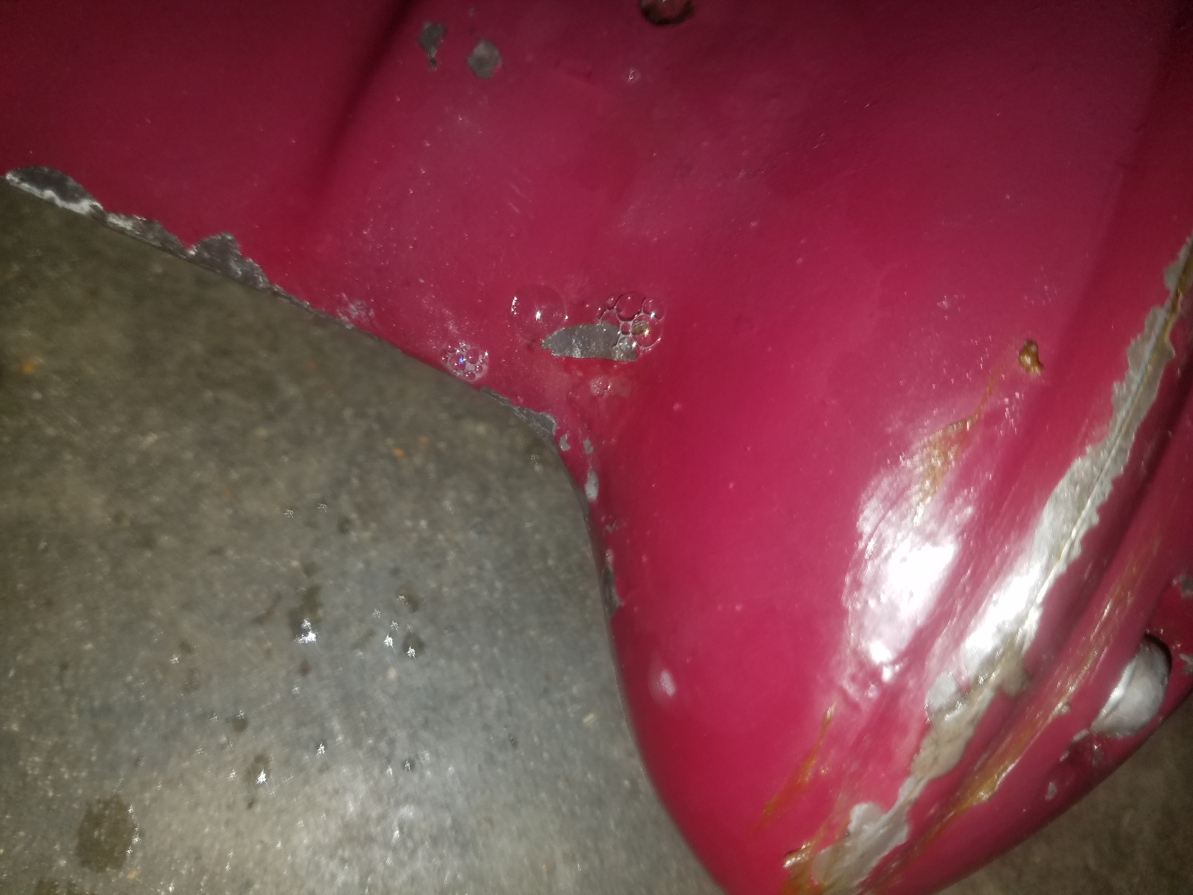

      The correct forward gear came in and I had a little time this afternoon so I installed it and buttoned things back up again. Then, I saw the pinion gear right where I placed it so I would remember to put it back in the LU. So, I took it all apart again. Wire wheeled everything back shiny then buttoned things up again. I flipped her over and installed the drive shaft and a new impeller and got the pump assembled and everything looked good. I decided to pressure check the LU and got this!

      #78391
        Where are the air bubbles coming from? Out of the hose fitting?
        #78392
        bullie
          No, they are coming out where its bubbling.

            How much air pressure are you using? and can you give a photo or video of the exact location where the bubbles are coming from?
            #78395
            bullie
              8 pounds or so of pressure

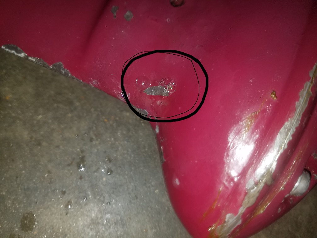

                If your leak is within the black circle I put on your picture, you have a much bigger problem as I do not know ANY reason why, other than a crack that you should EVER see a leak there… I have been wrong before…
                #78398
                bullie
                  Yep. Right there where the bubbles are forming.
                  #78399
                    Dang, You are going to have to remove paint to find out why….. There should be NOTHING there to leak…except maybe a crack, but you gots to find it…
                    #78400
                      Yeah, that doesn’t look good…Looks like the casting is either cracked or porous…Did you see any damage from a previous failure on the inside of the gear housing when you had it apart? I guess I would sand down that area to help pinpoint the actual leak, but you will probably have to pull it all apart again…
                      I hope I am wrong also…
                      #78401
                      chris-p
                        Probably a crack. I would grind it out slightly, then fill with brazing rod or TIG Weld with Argon, then self etch then paint.
