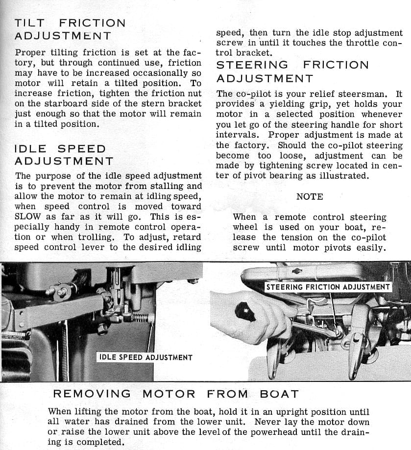

      The motor swings very easily on the mount. How do I tighten it up?

          Looks like your question posted twice. For the Buccaneer 12 I think this will be the location.
          steering-friction-1

            Gentlemen, I thank you for the information. I put it to good use and it works just fine. Thanks again. Richard
