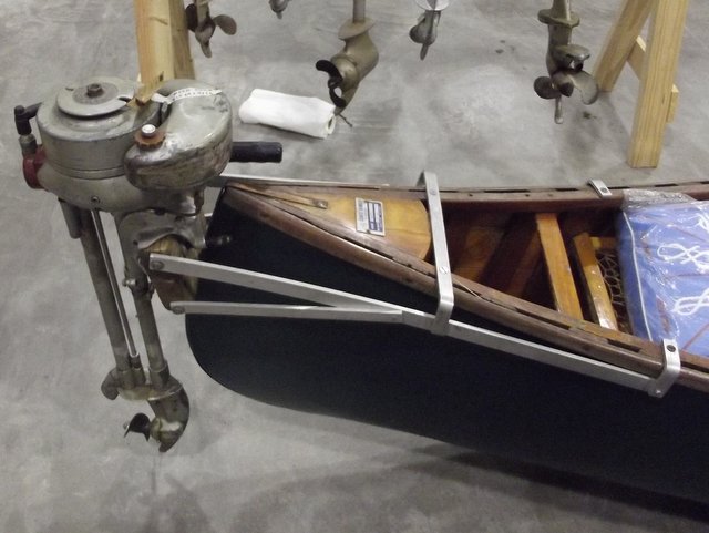

        Some double ender row boats have a small transom that can support a motor. A mount could easily be fabricated, if it’s like a canoe. Here’s a picture of one from Tomahawk a couple years ago. Another option is a side mount that is also common with canoe’s. Of course if it’s a larger row boat it might not be suitable for a motor if it has a lot of freeboard. Another consideration is the amount of displacement where the motor will be and whether you have a passenger to balance the boat, it can be easy to swamp a narrow boat if you and the motor are at the narrow end of the boat.

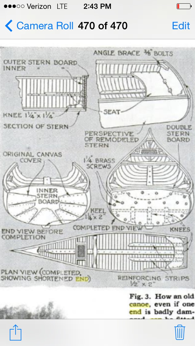

                Assuming the boat is not a highly collectible model,I would cut a foot off of the stern and build a transom.Pretty easy to do and as long as you stick to small motors it will be fine.

                    From 1928 Popular Science
