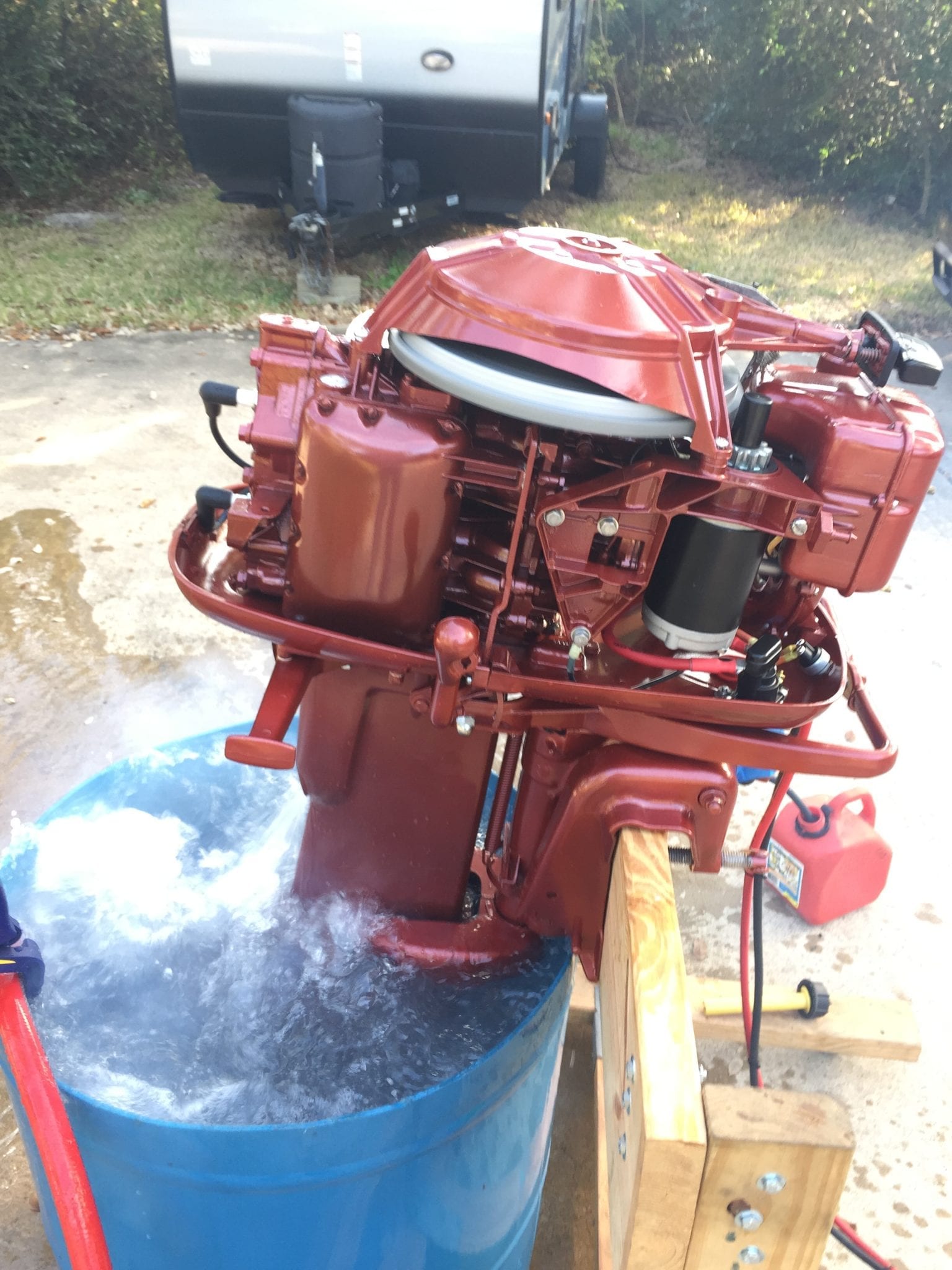

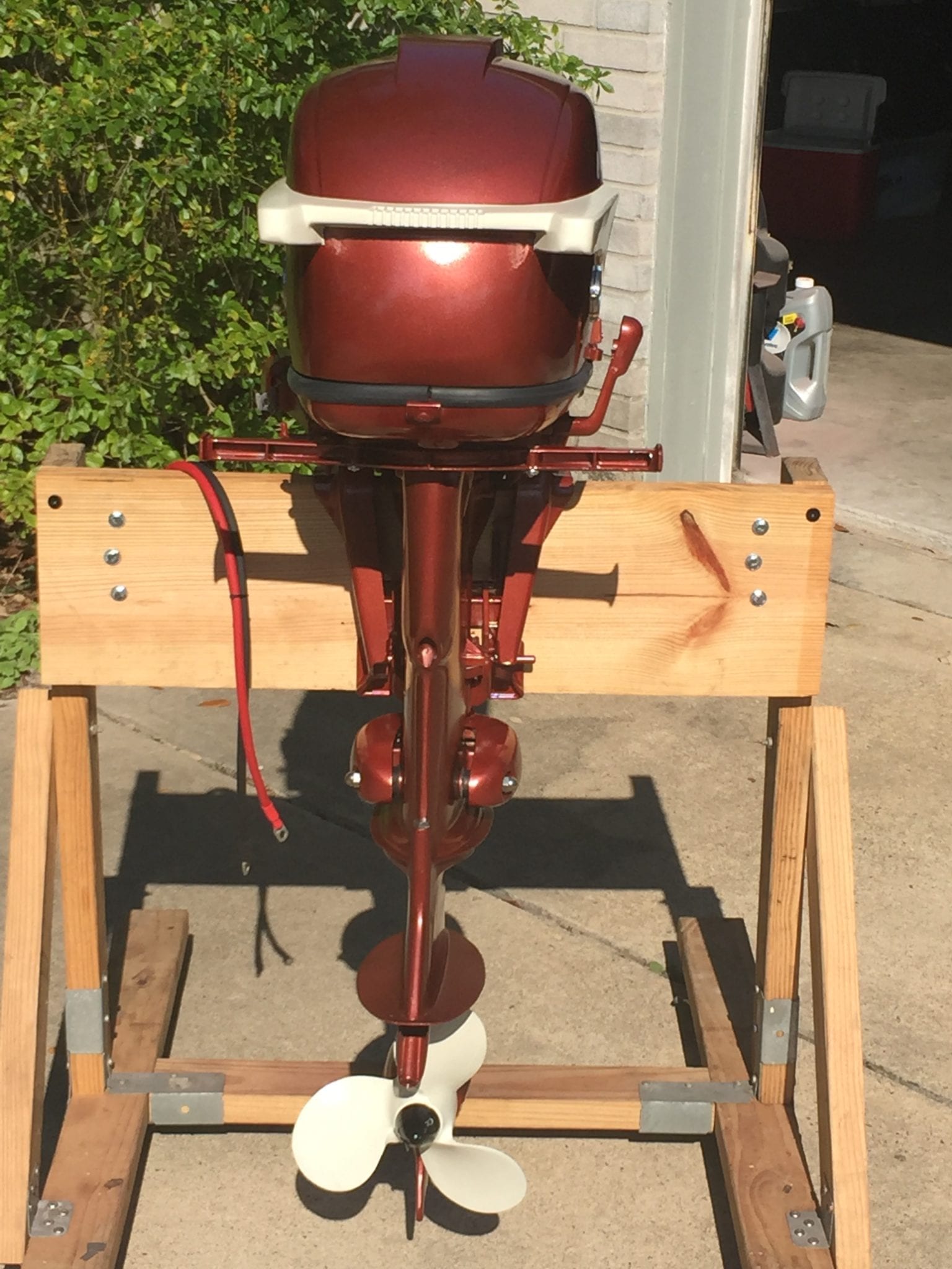

            I have a couple of these home-built stands I use for work/display stands and barrel testing.
            IMG_6564
            IMG_6472
            1982 Evinrude 25hp
