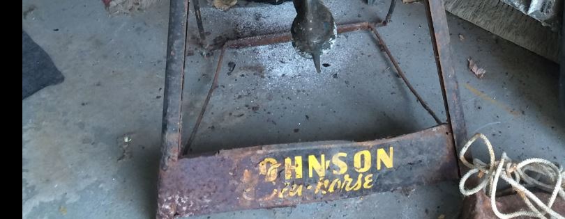

            Here is a pic of the base of the stand. The environment at the cabin is pretty damp, especially over the winter when everything is shut down. As you can see, the base is deteriorating and I’m afraid that if I don’t do something, it will rot away and just disintegrate completely. I’m all for leaving things original but in this case I think doing so might lead to the demise of the piece so I need to find some way of halting the disintegration or at least slowing it down as much as possible.

              how about a light coat of cosmoline or grease.

              thumper
                The rust can’t be saved. The rat road community usually brushes off the rust and then clear coats it with a satin or flat clear to seal out oxygen and slow down the rust /oxidation process. Base on how far gone the base is you will lose most of the logo. I’ts really only hanging on by a thread .
                #51519
