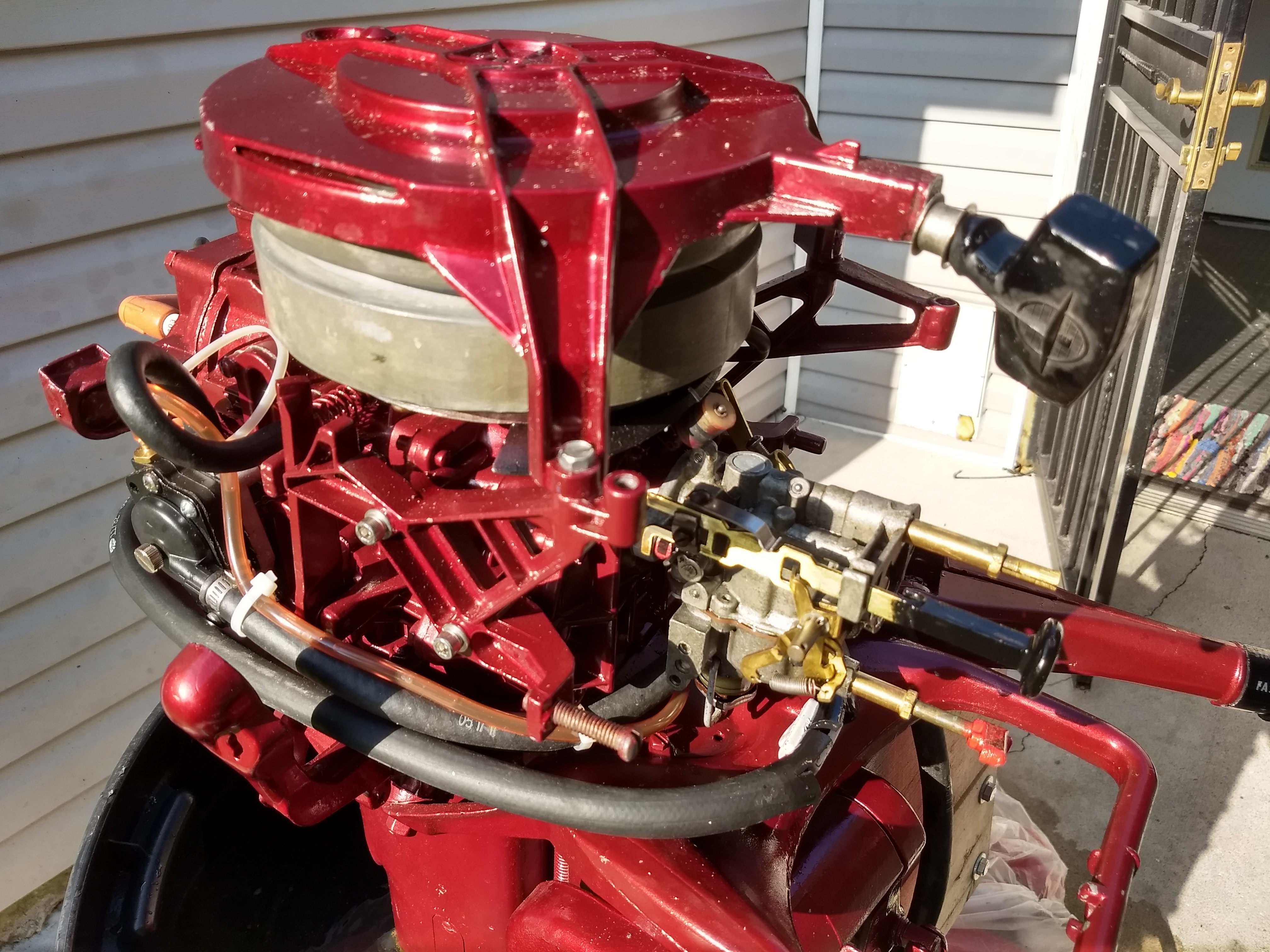

      General layout of the fuel system.

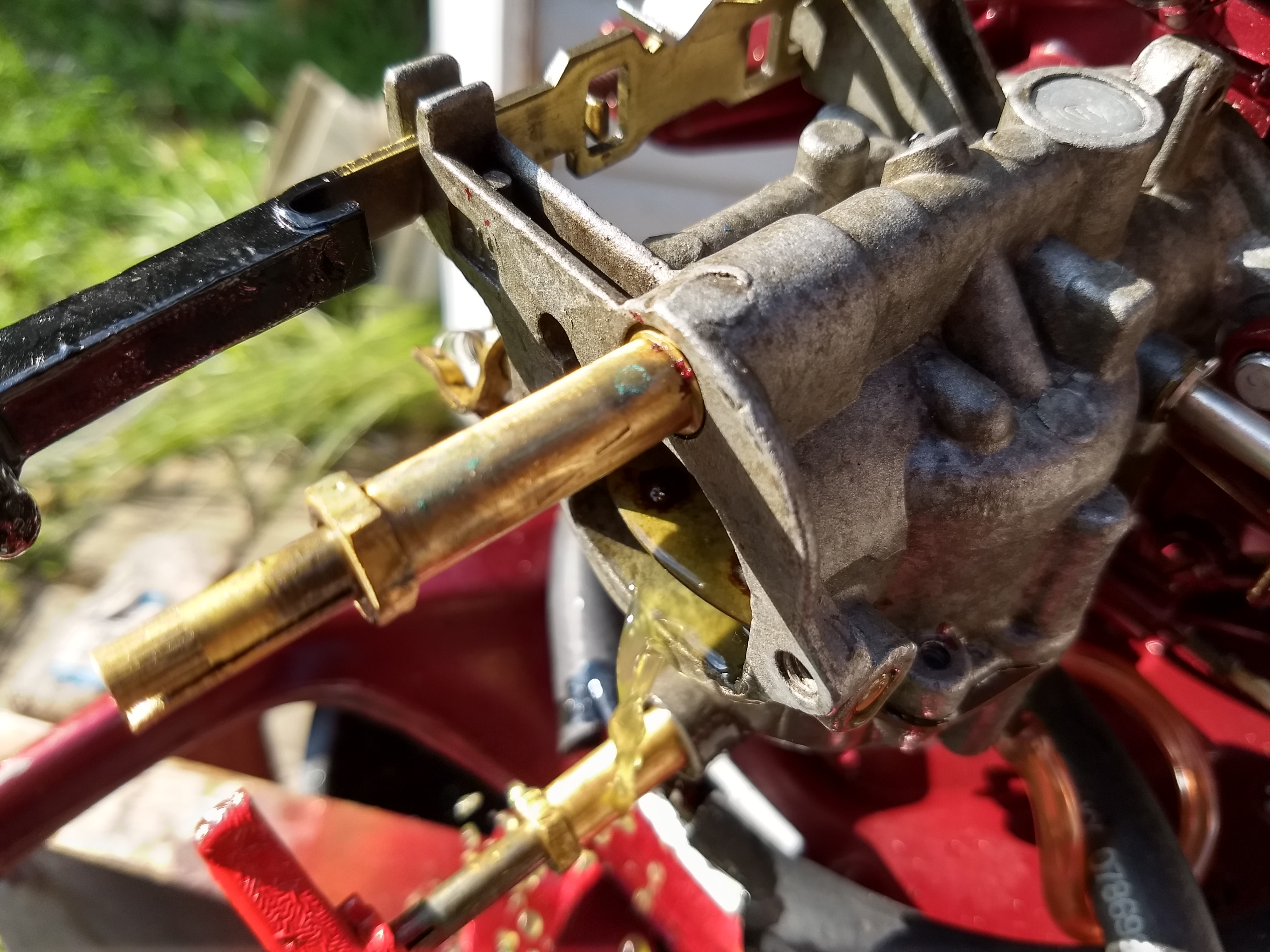

      What happens when the motor is primed or the starter cord is pulled.

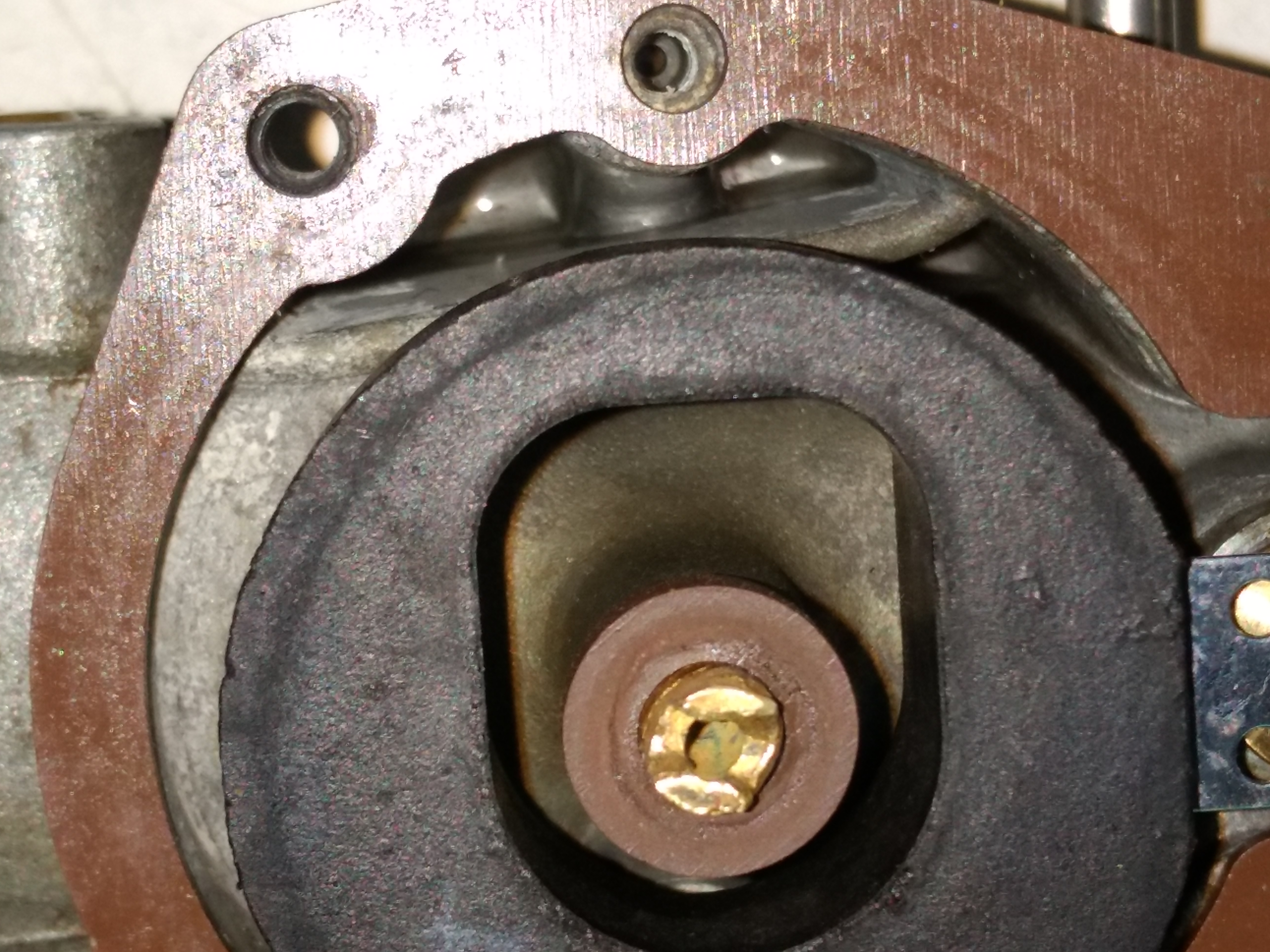

      View of the new float and body half gasket from the top.

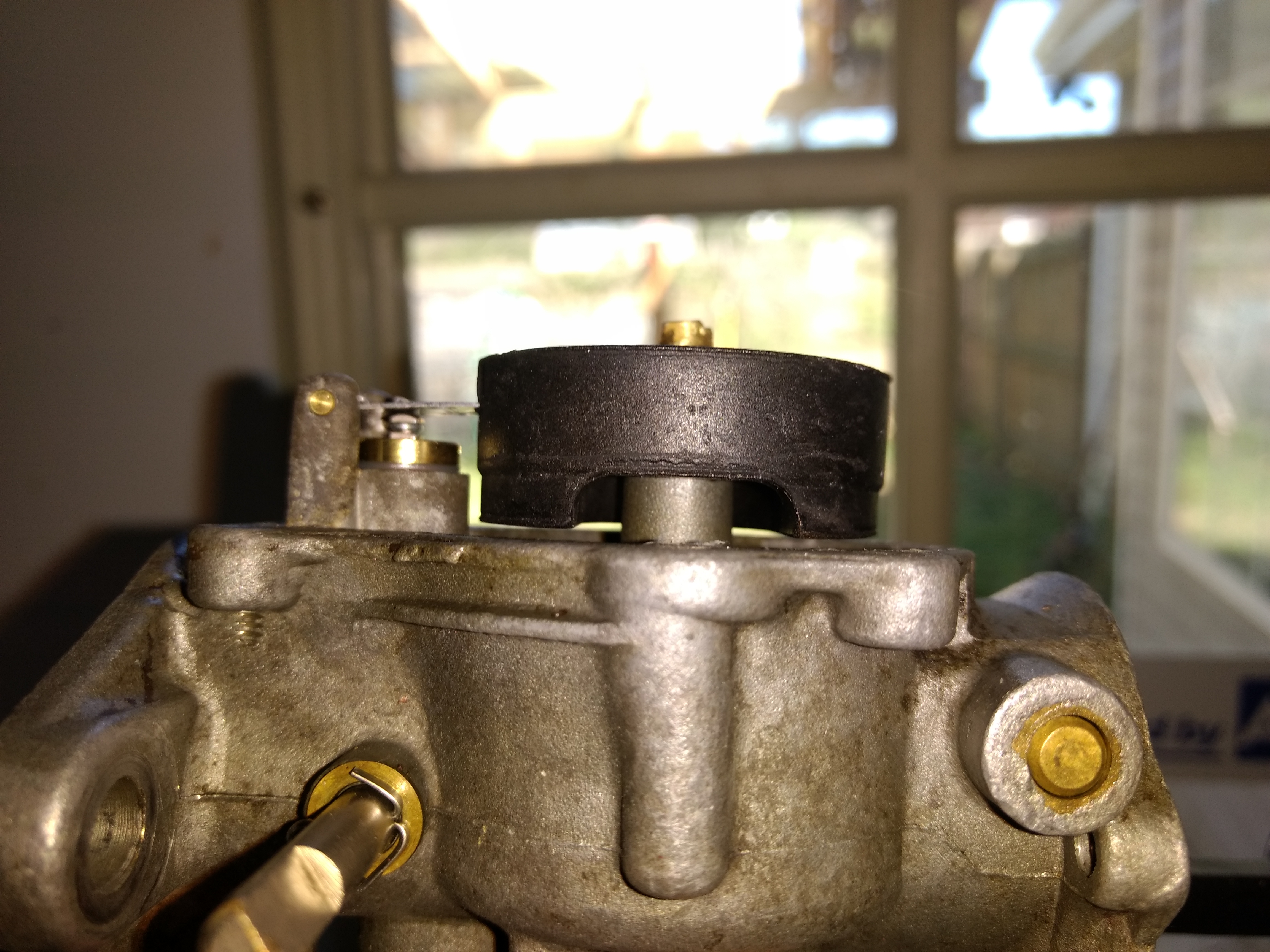

      View of the new float and body half gasket from the side.
      This has got to be a problem with the float/valve, but earned if I can see it. Since it is the same thing that was happening before the carb was rebuilt, so I hesitate to assume it was a detective kit and order another.

        Looking at the picture number three, it looks like there is debris in the nozzle 0303618. It may my eyesight though.

          The area I have outlined in red is the float bowl vent. If it gets blocked, the air bubble in the bowl will not allow the float to rise and gas will run out by way of the high speed jet. Squirting gas when you crank the motor indicates the fuel pump is working. . . 😆

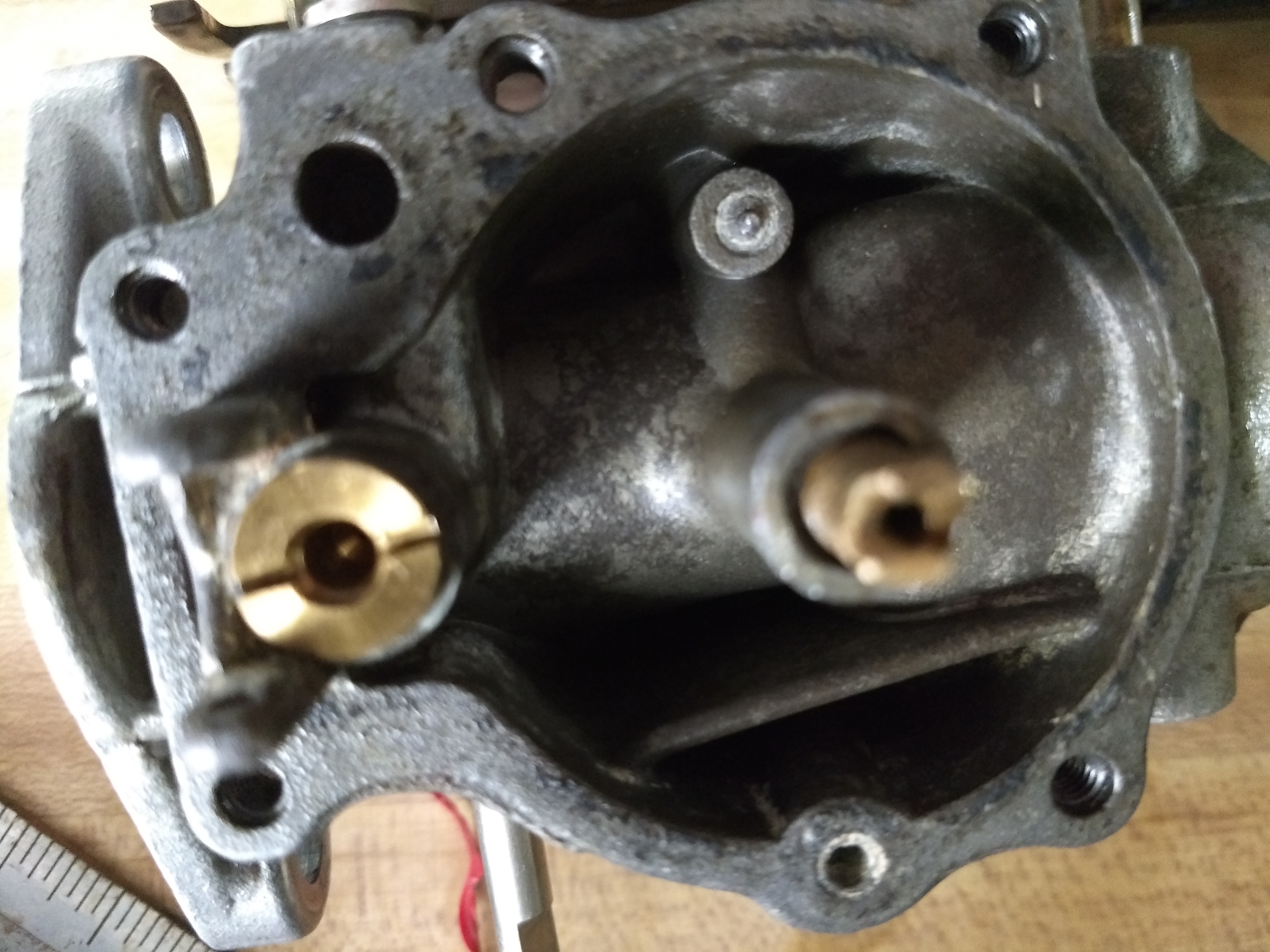

                      Ok guys. You hit it right on the nails head. The exterior opening next to the bowl vent was so packed with crud, I thought it was a factory plug. I cleaned out the passage back to the point where it turns downward to go into the bowl and tried flushing it out with carb cleaner and compressed air. However, it still appears to be plugged up. I want to try a back flush through the passage, but i can not find the opening to the passage from inside fuel bowl. Any idea where that opening is?
                      #79976
