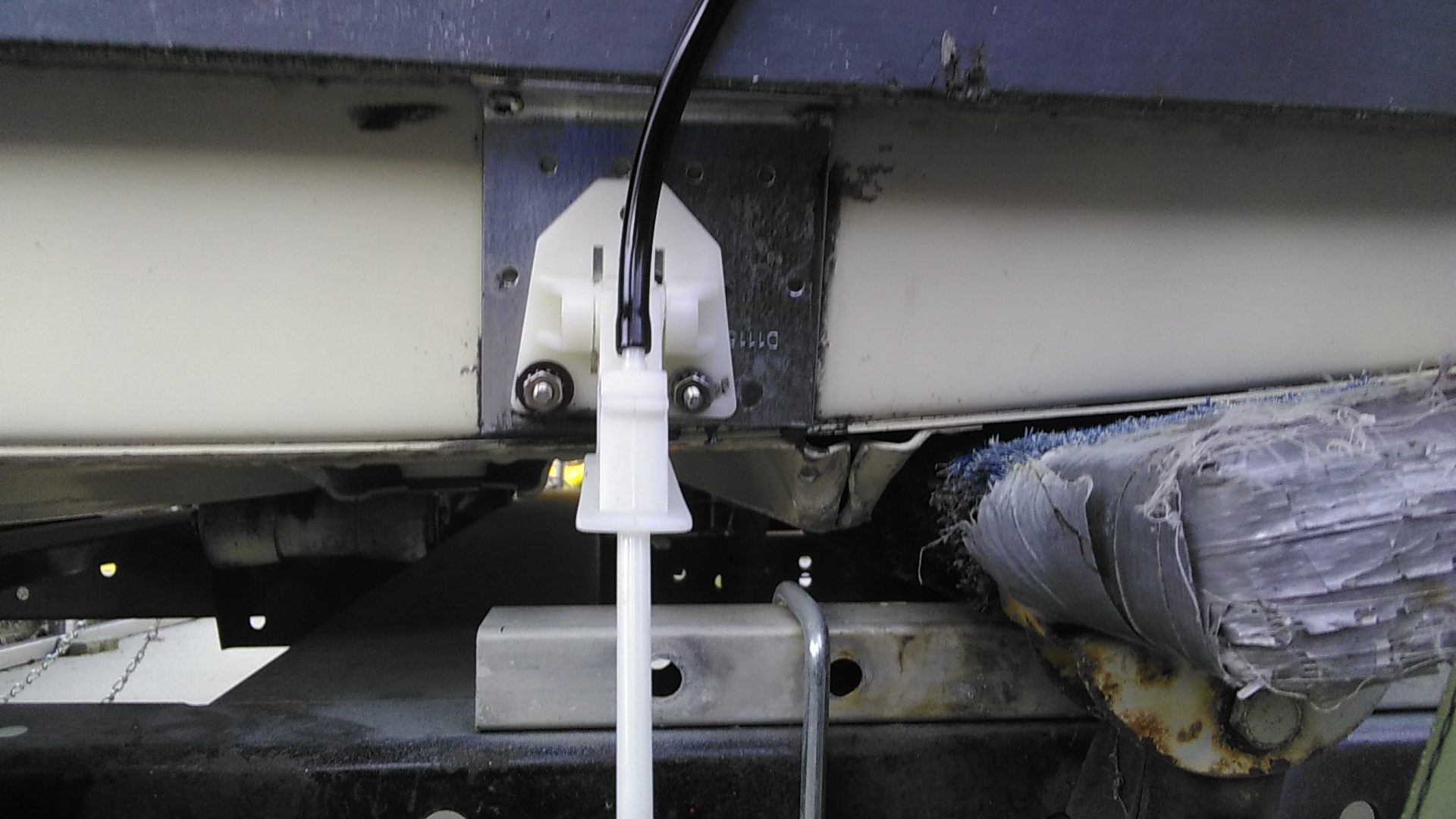

                    #250090
                    lindy46
                      Here’s how I mounted it. Used JB Weld between transom and plate. Seems solid.
