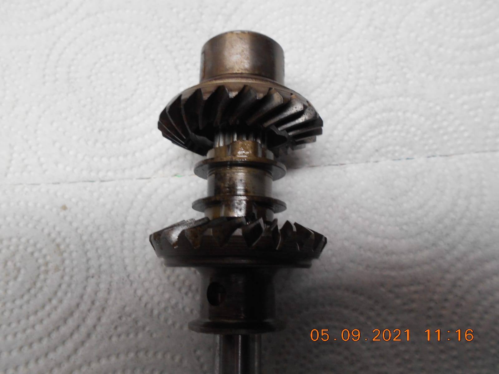

      The one side of the clutch dog ears have some wear. I see no noticeable
      difference in length from center to each end, nor different shoulders, etc.,
      that would make me think I can’t flip over the dog.
      The only difference I can see is the ears on one end are “clocked” in
      a slightly different position than the other side. I can’t for the life of me
      see how that’s a problem.
      Anyone know why I should not flip the dog over on this model?
      I’m not used to working on these new fangled outboards that shift! 🙂
      Also, curious if anyone knows what the “A” designates on the model number?
      Marine Engine only shows them at MQ12.
      Thanks!
      DSCN0858
      #238063
        The manuals say not to flip it, but people do it all the time. Yes, even me.
        Have no idea on the clocking. In fact, probably never noticed before
        Model number suffix identifies any mid-year changes IF there were any, Otherwise it means nothing.
        • This reply was modified 5 years, 5 months ago by frankr.
        #238065
          Thanks Frank. Guessing that OMC wanted to sell more parts. hence the “no flipping” note in the manual!

              Well, at least I won’t be charging my brother in law for a new clutch dog that I “filpped over”!
              #238235
                I don’t know – that ought to be worth one beer!
                1982 Evinrude 25hp
                #238245
                  Two beers and some scrap metal to practice with on the new milling machine!
