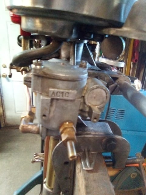

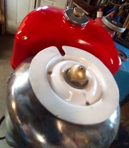

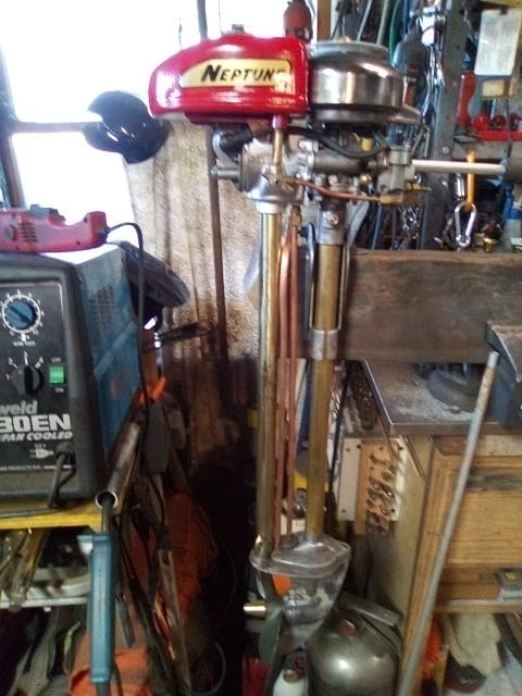

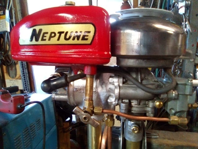

      I have enclosed a few pictures of the Neptune, Mighty Mite, type motor that I am working on. Unfortunately the ID disk is missing. I am trying to find out the model of this one so I might look up the correct parts for it [plugs and such] and get a idea on its age. Hopefully one of the members here can help me with the model number by looking at the pics. I repainted it and applied new decals, so do not go by that .Thanks once again for all the help .

        According to “Dis-count Marine” the AC1-1 Tilotson carb was used on the model 11A1 and 11B1 Jr. Single 1 1/2 H.P. in 1941 .

          Thanks for the reply , that gives me a starting point at least.
