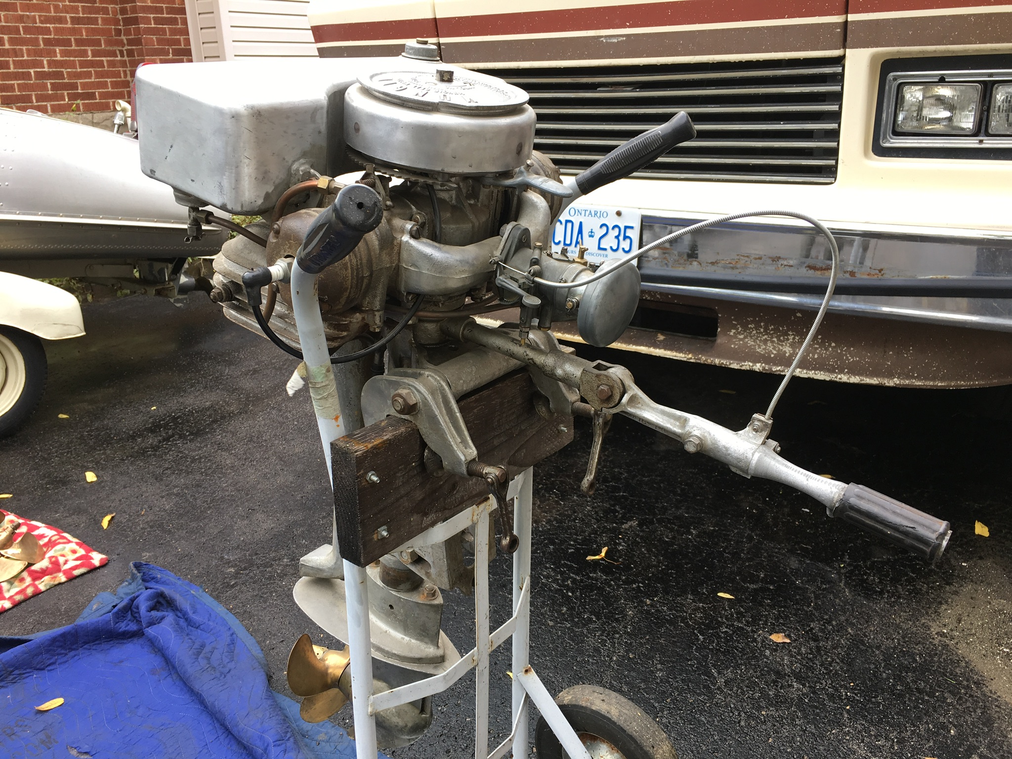

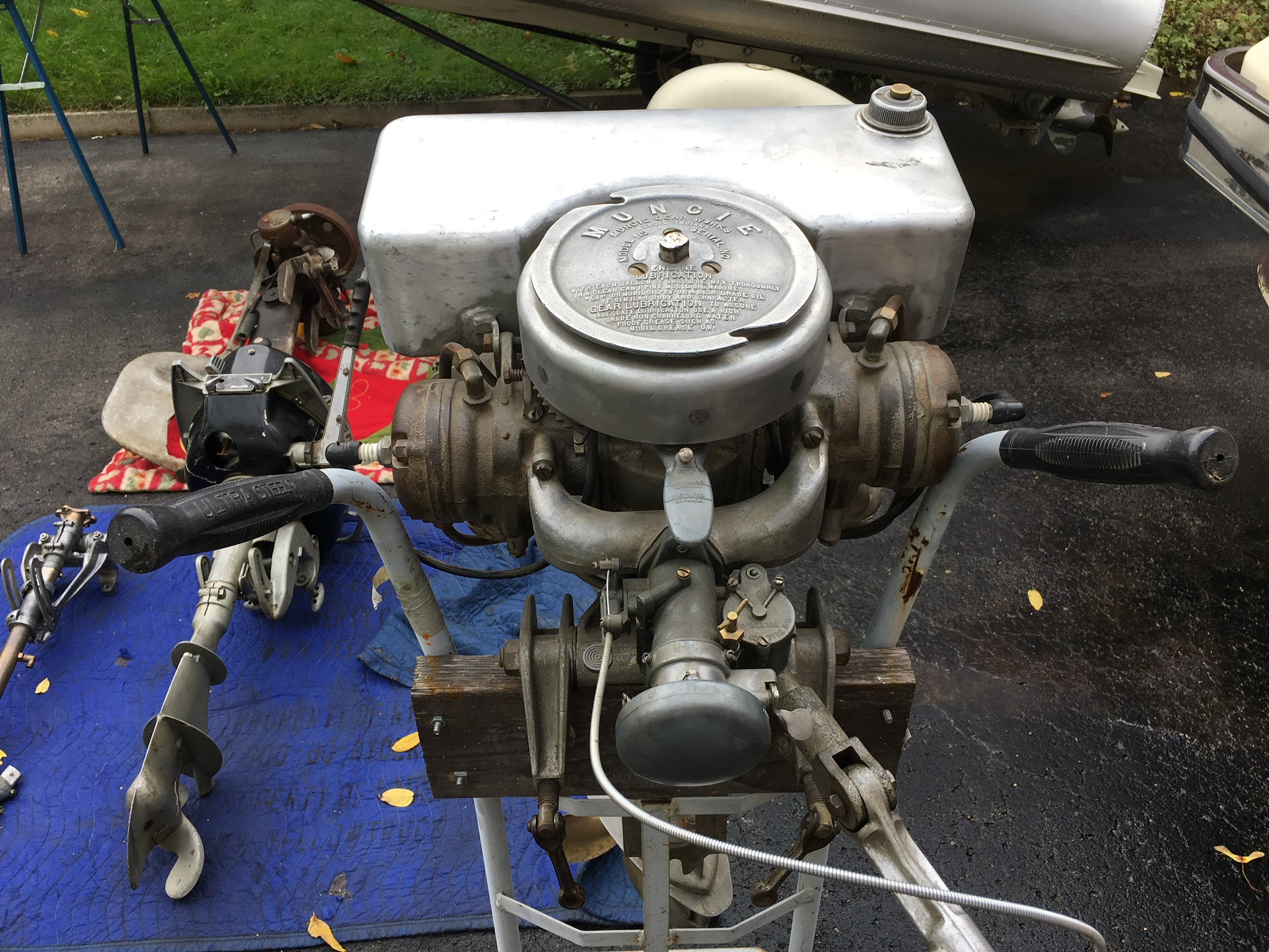

      I’m having some trouble starting a Muncie/Neptune Master Twin 16 hp. It has a Tillotson MS47D carburetor. Would anyone have information on the correct initial carb settings? It has good spark and is getting fuel. I’m having trouble finding the right combination of settings to get it to start.

          Well, that’s not encouraging. The best I’ve managed is some backfiring, which gets pretty exciting when you are directly attached to the flywheel with a rope.
          On the plus side, I think I solved the mystery of what year the motor was manufactured. It appears that the MS47D was only used on the Master Twin in 1941. That would make this one of the last Master Twins produced, which may explain why there is no serial or model number stamped on the rope sheave.

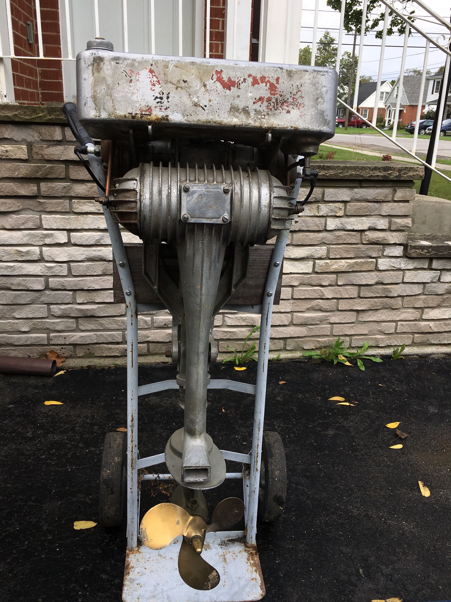

            I also have a 1936 master twin, a nice original but it has also been a bear to find the right settings to get it started.
            Is yours an opposed twin or an alternative firing?

                Thanks for all the responses. This one is an opposed twin. It looks the same as the late 30’s Master Twins. I had the advance set at about 5 o’clock when I had the backfiring. After I moved it to the 6 o’clock position the backfiring stopped and the flooding began. The throttle is set about halfway. Obviously, I’ve tried different choke settings. I regrouped this morning and managed to get the motor to fire on Seafoam (Gibbs isn’t available here) on the third or fourth pull. It ran for about 20 seconds and sounded pretty good. It died the moment I touched the throttle. I made a few more attempts to get it restarted on gas to no avail. I’m going away this weekend. I’ll try it again one night this week. I’d like to have it running for the Bellwood Lake Wet Meet on May 7.

                      Wbeaton: my master twin looks the same as yours. They are nice looking motors but as mentioned they are "gravitationally enhanced"
                      I have the same hard starting issues but I will try the things mentioned here to get it running. I’ve had this motor for a few years without a successful boat run.
