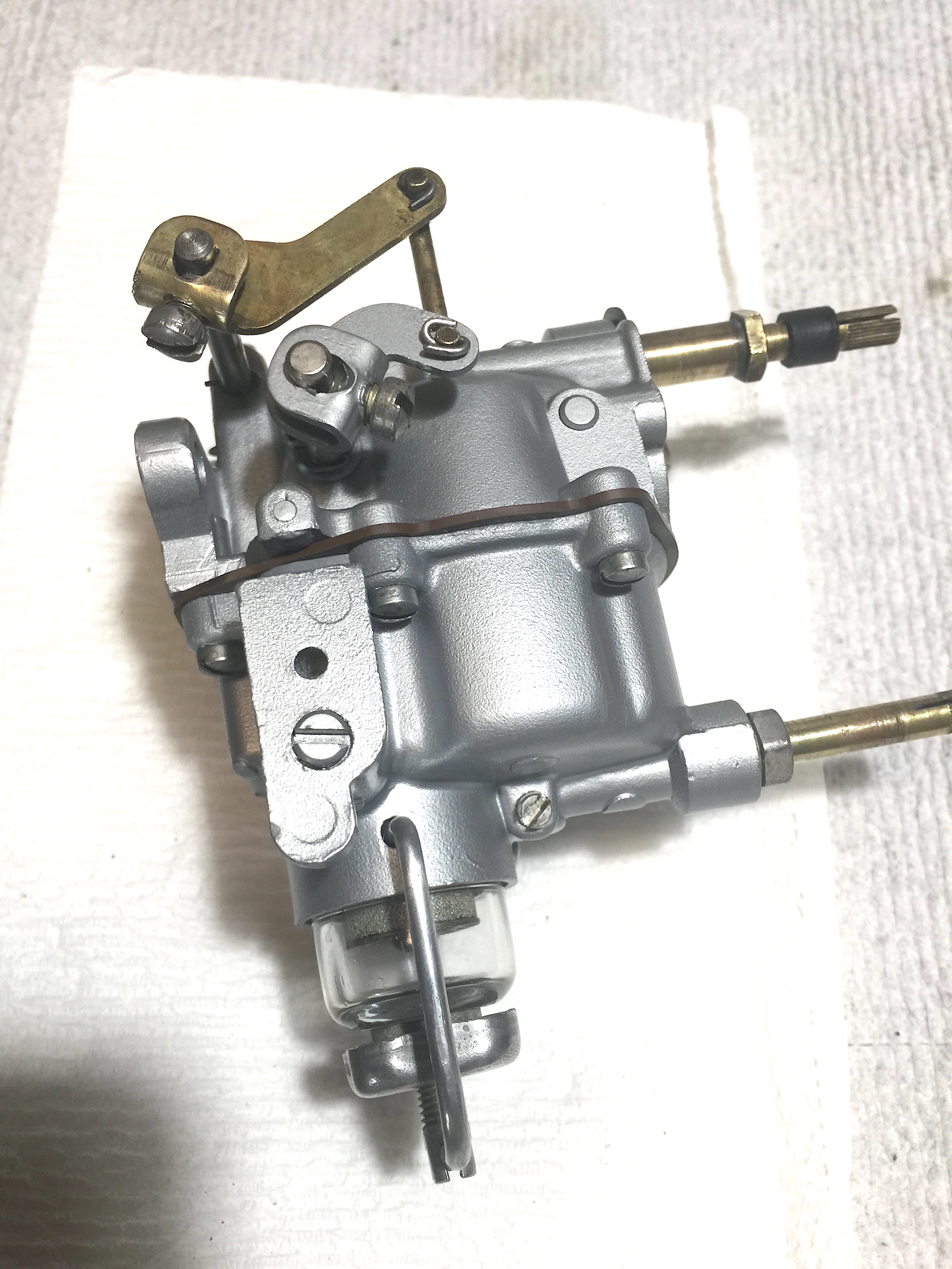

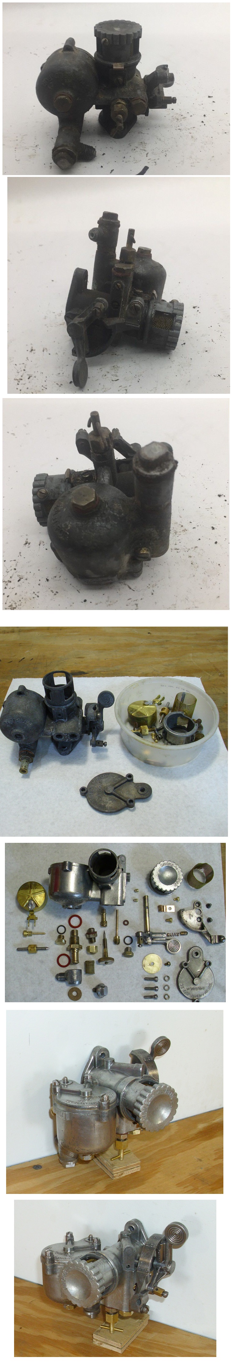

      Got a Folding N awhile ago. A rough one missing
      some parts including the carburetor. If it had one
      it would likely be broken as this is from the time
      when the pot metal would swell, become brittle,
      and break apart. This replacement is from a later
      Neptune but is the same except for the bracket
      that would hold a choke cable. I may cut it off at
      a later date. 1 day of soaking and 2 days of
      cleaning in between other projects I have going.

        Tubs,
        Really nice work. What do you use to soak your carbs?

        lyks2tinkr
          Came out great looking. Did you use a soda blsster?

            #75150
              Soaked in Gunk carb cleaner. It takes off the crud
              from and in the carb body but its still discolored.
              I removed the black coating with any number of
              solvents, cleaners, pads, sand paper, and brushes.
              My system is mostly a little of this and a little
              of that.

                  Guess I’ll have to work a little harder on my next carb overhaul and cleanup to get all the discoloration off it. Just finished a carb overhaul on my Johnson CD-11 and just painted it with a cast aluminum paint to freshen it up.
                  1982 Evinrude 25hp
                  #75172
                    Its still nicely detailed.
                    Not just put together and sprayed.
                    Up keep can be less with paint.
                    In time yours could look lots better than mine.

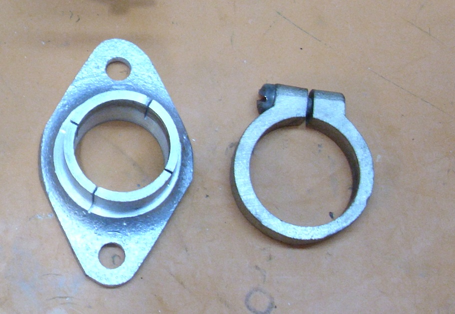

                      Looks great. Having the same motor and missing carb completely I was curious what one even looked like. How will you mount it to the engine, mine just has the snout for a clamp on carb. Is there an adapter?
