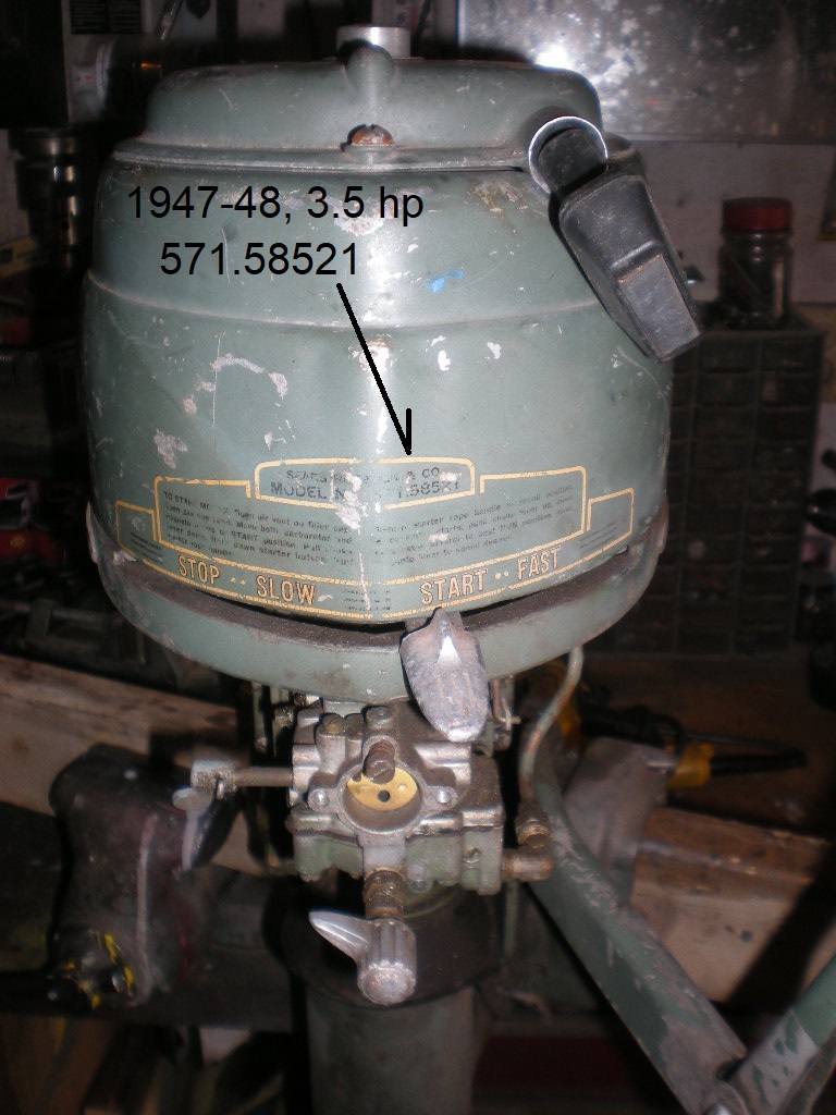

      #79614
        I have a push button starter on a 3-1/2 hp Elgin,
        but presume they put them on other models.
        On mine, the model number was on front, on the decal.
        Not sure if it showed up elsewhere.

                        Thanks Frank, I learned something new too, and your system
                        "checks out" for my 3.5 hp as well.
