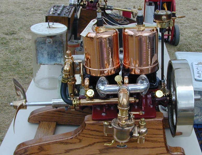

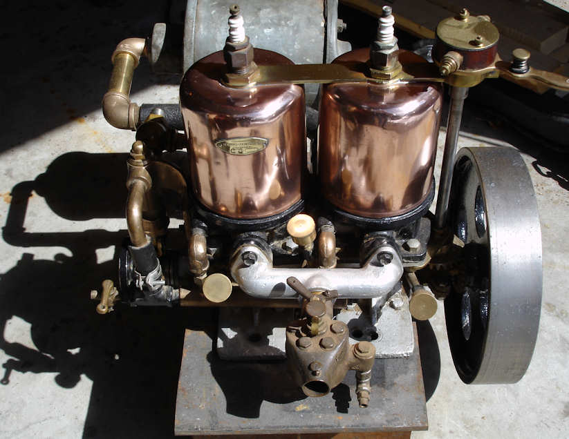

April 14, 2017 at 9:45 pm #56093April 14, 2017 at 11:36 pm #56101Ya, some of those old inboards are also works of art from a bygone era. Those pics show the potential for sure.

April 17, 2017 at 2:03 am #56227Interesting item. Would like to see what’s behind the shield on the port side. It seems to have a timer driven by a pair of spur gears, so what’s the purpose of the bevel gears and vertical shaft behind the flywheel? Is there a water pump anywhere?
On looking again maybe that "timer" is a gear pump and the vertical shaft is for a missing timer–as in both restored engines.
Would usually expect a plunger pump on something of this vintage, but…..
April 17, 2017 at 5:29 am #56241The timer is usually in the front, so the bevel gears would be driving the (missing) timer. That’s a rotary water pump at the back, driven by the straight gears – the petcock would be for priming it. I’ve seen many motors like this with the inspection ports on the sides of the crankcase, but I’ve never seen any with covers on the bypass. And I’ve never seen domed copper water jackets like that.
