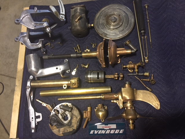

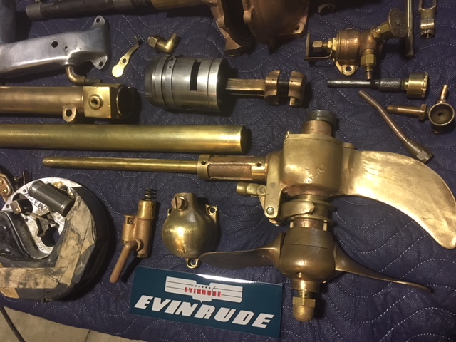

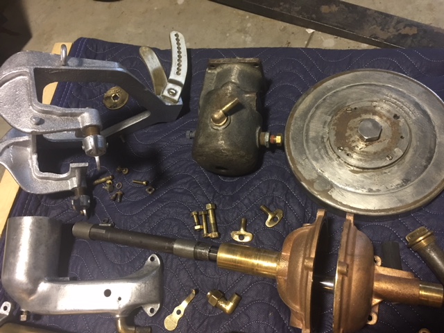

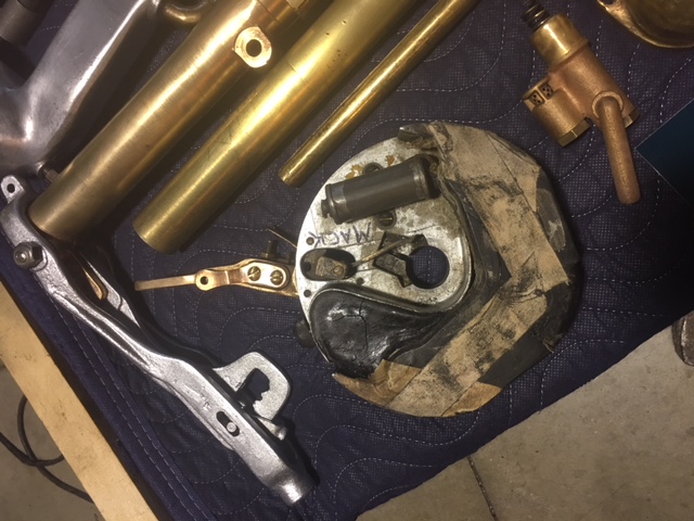

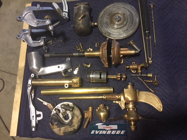

      Looking for info on Motor, what year, brand, colour, mag coil and condenser (can these parts be purchased), flywheel knob and mount, anything to help me restore this
      OBM owned by Okeechobee Lodge, located on the North Channel (Baie Finn) on Georgian Bay
      Note: The Evinrude Family Cottage is located close by
      Here are some of the numbers and info I can find on the parts
      Engine Mount #18850
      Flywheel – Evinrude with Pat # Mar 23 1915, July 20 1915, Jan 28 1916
      Magneto Plate #67834
      Fuel Tank – L Shaped with Evinrude decal
      Crankcase Halves 4A-3, 4A-4
      Con Rod 2A3B
      Piston 3A-7
      Fuel/Air Valve, Caille Detroit
      Tiller Grip, Caille
      Muffler 5A-1
      5 position handle
      Variable Prop
      All Brass Crankcase to Prop
      Fuel Tank and Cylinder – blue paint
      Pics attached of parts

        looks like a Caille 5-speed Rowboat motor from maybe 1917 – 1923
        with an Evinrude flywheel ( normal for that time )
        flywheel itself don’t has the starter knob on , but can also missing the optional starting device
        depend how the tank look likes
        that Evinrude decal on one of your picture is not for this motor
