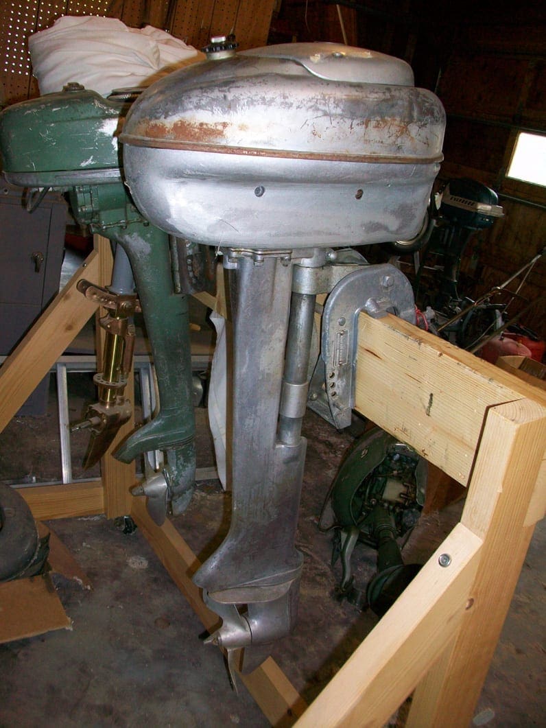

      Think this could be Scott Atwater serial number is 482-210 08 .Anyone have any ideas ? Thanks

        Close, but no cigar. I make it to be a pre-WWII Champion. Predecessor to Scott-Atwater
        I’m wondering about that serial number.
        #183131
          482 falls between the 481 and 483 Scot Atwater models built in 1948 ? ? ?
          #183145
            But that ain’t no 1948. That’s why the number looks suspicious to me. It has the 4-bolt head, last used in 1946. And it has the gearcase cap ahead of the prop, used in pre-war years.

              Thanks for your comments , can I get you any more pictures or information that might help ?

                Where did you find that supposed serial number? Can you find the Tillotson number on the carburetor, or the numbers or picture of the magneto?
                #183164
                  That thing is bugging me. It has the 1946 S/A exhaust housing, but with water intake holes. The lower unit is pre-war style. I’m suspecting it is something S/A cobbled up right after the war ended, from parts in storage. There was a big rush to get outboard motors back into production. Anybody else know?

                    My apologies , I’ve misread the serial number , it should begin 462 . I went over it with a wire brush and it became clear
                    #183193
                      Aha!!! Now we’re getting somewhere. 462 is a 1946 Firestone 3.5hp, made by Scott-Atwater. I was a bit confused because my 1947 Firestone had the newer style lower unit. In fact the whole thing looks considerably different. Posting a picture of the 1947 Firestone 3.5.

                        Thanks , that’s interesting . Am I missing a lower cowling ? Doesn’t look right with just the tank .
