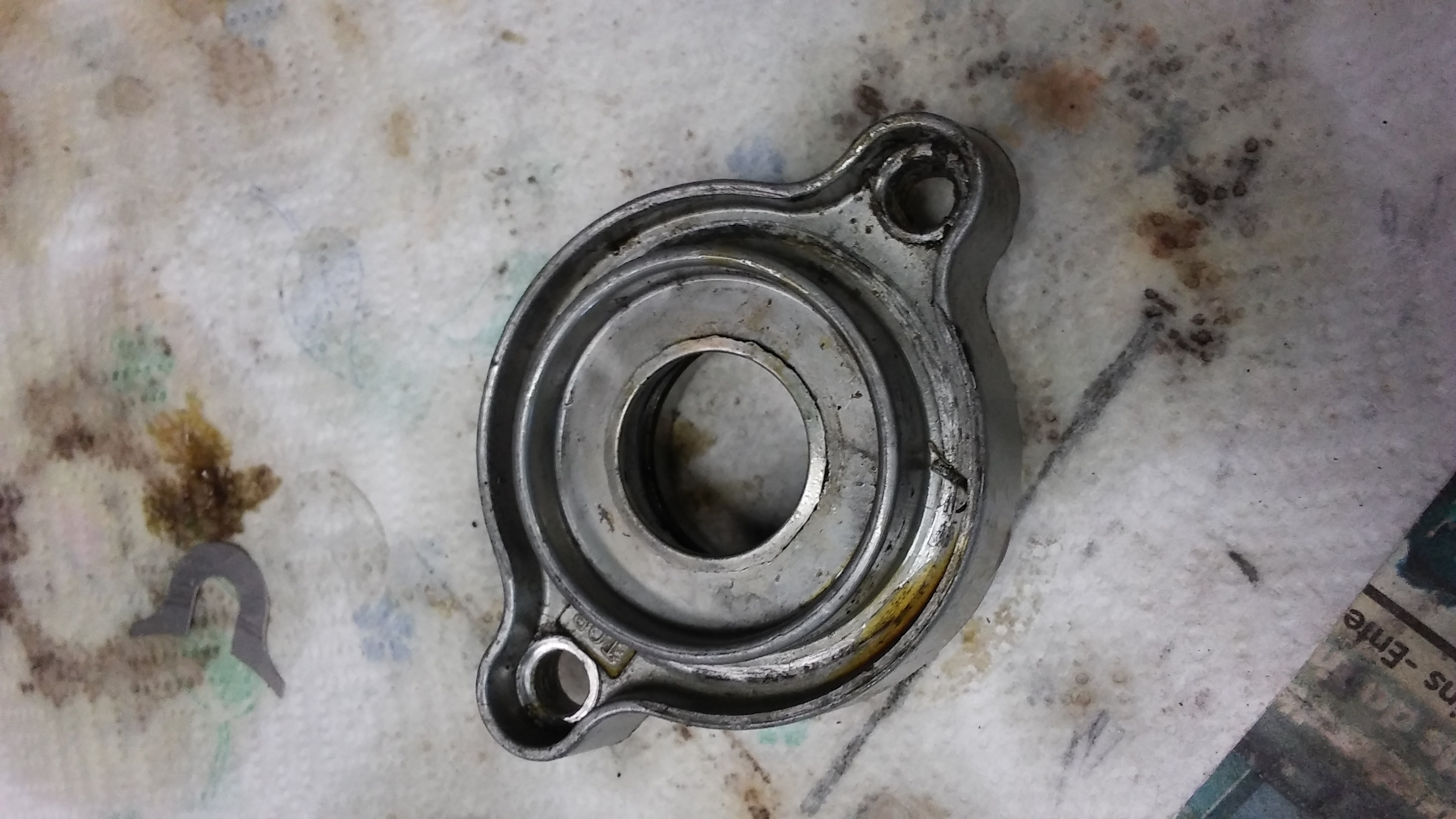

October 12, 2016 at 10:09 pm #45712See the ring around the center? That is where the cover cracked in a perfect circle when the previous owner hit something very hard. It leaks oil badly!

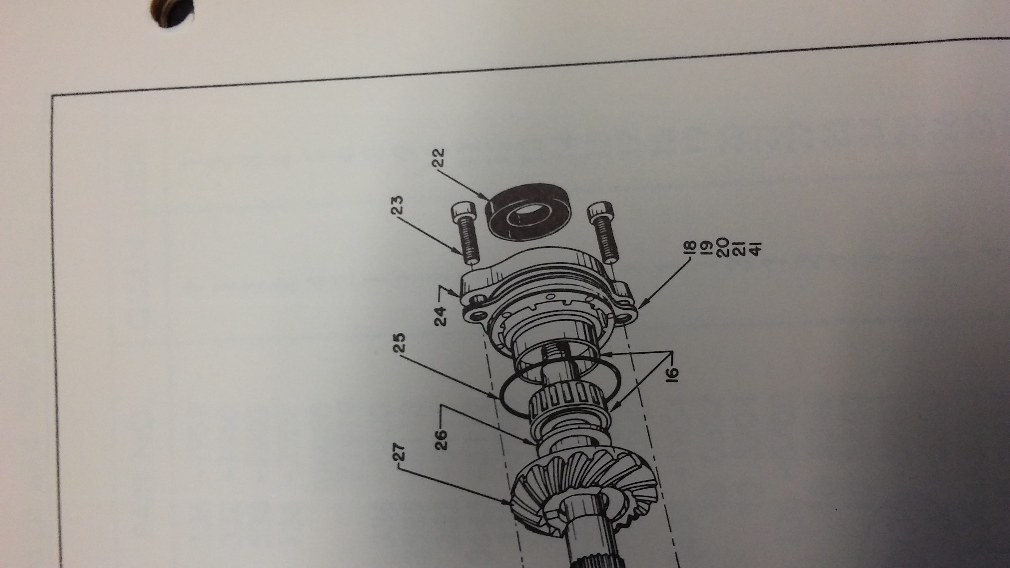

October 12, 2016 at 10:29 pm #45713I guess I’m not understanding. Doesn’t the prop shaft seal fit in the large bore? But maybe not. I’m wondering if the part can be salvaged by boring it out and fitting a spacer bushing around the seal if it goes in that small bore.. Guess I’m not seeing the big picture.
October 13, 2016 at 11:45 am #45756I don’t know? Maybe that would work. I have a repair man with 50 years experience. I’ll ask him. In the event that its not an option, do you think I could have it welded?
October 13, 2016 at 12:34 pm #45759It could probably be welded and re-machined. I see where it’s broken. Unless you can do it yourself or have a close friend that can do it, that repair will likely be more costly than a decent parts motor. I have one of these motors but I have not had it apart yet to repair it. I’m trying to figure out what punched the circle out. Is there a shoulder on the prop shaft that punched it? These motors show up for sale from time to time. If you don’t already have an extra one for parts you probably should have anyway if you are trying to get it back to good running condition. Maybe finding a motor for a parts donor is the best bet. Just my 2 cents.

October 14, 2016 at 2:13 am #45824Ben, I comepletly agree. I would love a parts motor. Want to part with yours?! Haha. I’m not sure how it happened. My cousin is a welder so I could probably have it done if need be, but I want to look around first. The motor runs amazingly. This is my only problem at present.

October 14, 2016 at 2:28 pm #45836October 14, 2016 at 3:38 pm #45837That’s a very good point Tubs. Welding may be an impossibility. I know there are others out there. I’ll be at Suter’s tomorrow and I’ll be on the lookout.
