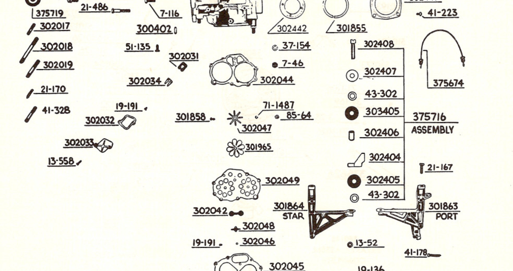

      I need a part number for the four rubber isolators that support a bracket that the two cowlings attach to.

        I need a part number for the four rubber isolators that support brackets which the two cowlings are attached to.
        #83216
          Is the QD-12 /13 the same parts?
          That’s the closest I have.
          #83217
          MIKE SIMS
            part# is the same QD-10, QD-11, QD12, QD-13
            parts diagrams were not great back then
            #83218
            MIKE SIMS
              I think the 303405 should be 302405
              #83265
              johnny
                quote Buccaneer:
                That parts diagram is for a QD 12 or 13. I need the part number for a QD 10. The rubber isolator is very different on a QD 10.

                  quote Johnny:
                  John Fairgrieve
                  jboats@comcast.net
                  There are some notes in the QD10 pdf parts diagram regarding the rubber stoppers.
                  #83321
                  johnny
                    Thanks cajuncook1. That is exactly what I was looking for. Those isolators are part number 302021.
