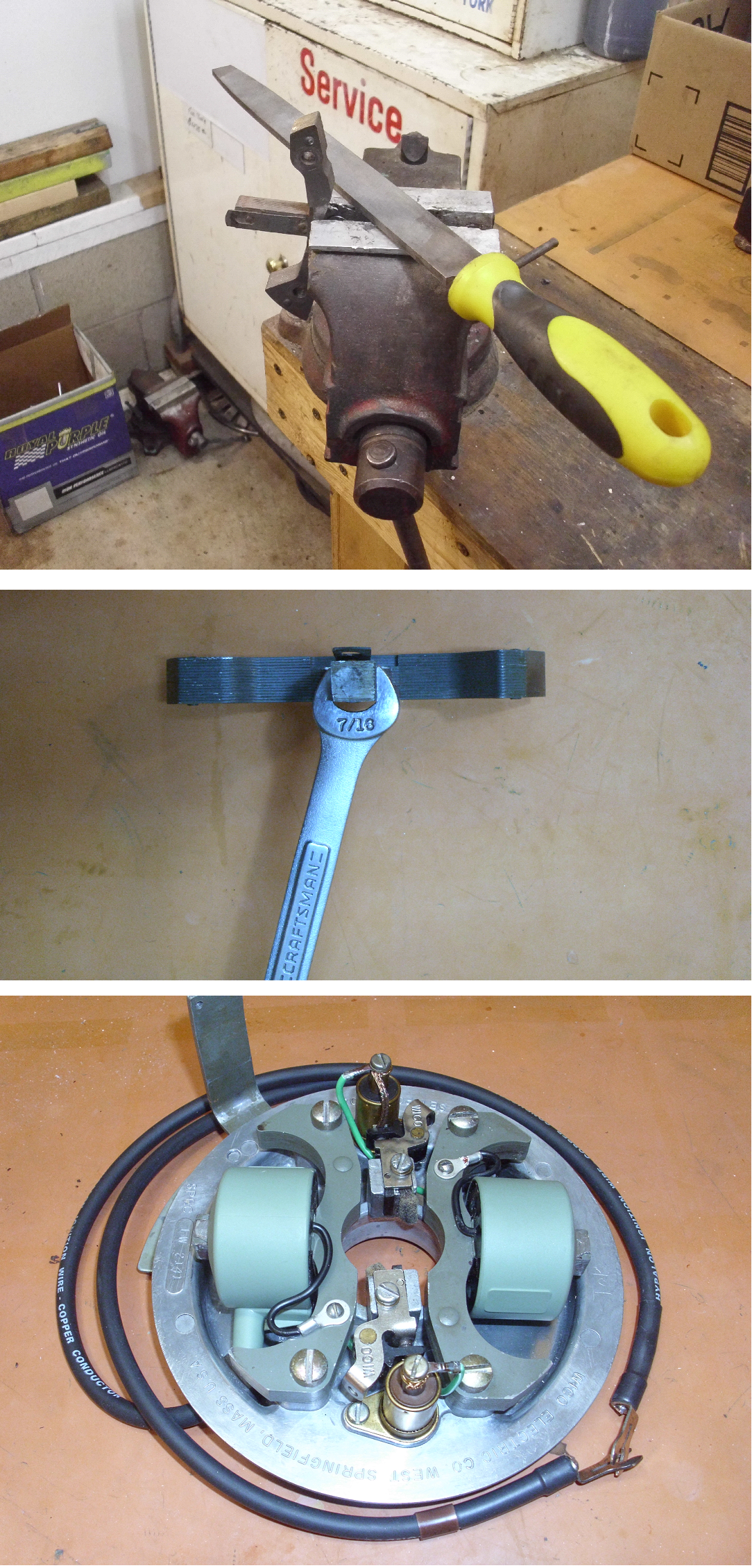

        If your coil laminates are about 7/16  high  and just a bit more than 7/16 wide….you are in luck because you can retrofit a pair of the common OMC coils.  Although some laminates are quite a bit heftier than that….so it would help with a picture.
        Points can most often be cleaned and polished and re-used.  A variety Condensers can be made to work,  spark plug wires can be purchased at a lawn mower shop or auto supply store.  Copper core wire.
        Member Tubs has a great video showing the OMC conversion.  If he sees this I bet he will post a link to it.
        #304479
          I believe you have this Wico magneto. If that is the case, these pictures are of the modification Seakaye has described above.  Here is a video link of the modification on a 7.5 hp. Mercury Phelon magneto .  https://youtu.be/OxPHe8EPe1Q?si=yu99T33CLZ52zeC5
