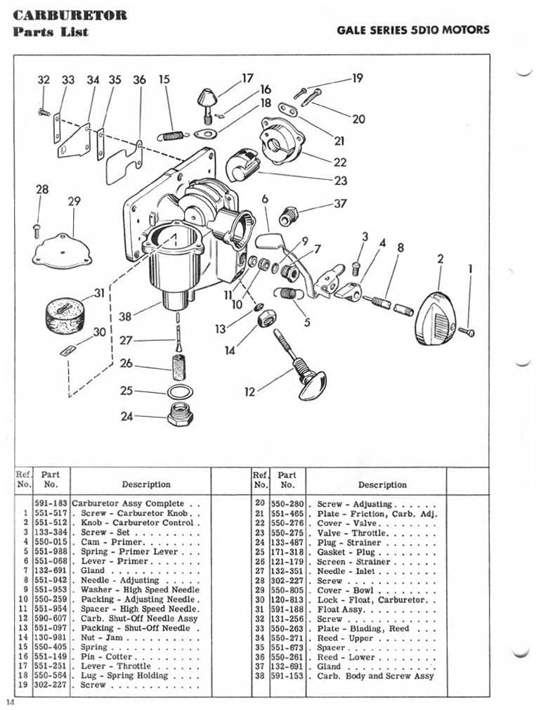

          Maybe the adjustment needle or seat is worn, making it “richer” than you think,
          or the float is too heavy?
          Is that adjustment on the side anymore than an idle setting, that opens the throttle
          spool open further when you turn it in? I know Frank set me straight on it a couple
          of years ago, but I haven’t played with one of those carbs for a while.
          Pg_14_Carburetor
          #178810
            you said it sped up as it was running out of gas. That tells me it was getting too much gas (rich) before it started running out. Try closing the main needle down some. Around 3/8 turn open is normal in most cases. The screw on the side holds the throttle shutter open part way at idle speeds, and serves as a rich-lean idle mixture control.

              I also need to check that float height too. My float needle clips are not in the groove.

                About all you can do with that or any motor in a barrel is get it somewhere close. The procedure is simple. Start motor and run it at full throttle (if you can). Turn high speed needle to the right till it starts to lose power. Then turn it back to the left till it regains power.
                As for the slow speed screw, just experiment with it for best idle. It screws in against a ramp, so good practice is to screw it in a bit with throttle open, then reduce throttle to see how it does. This is to avoid possible damage to the plastic ramp.
