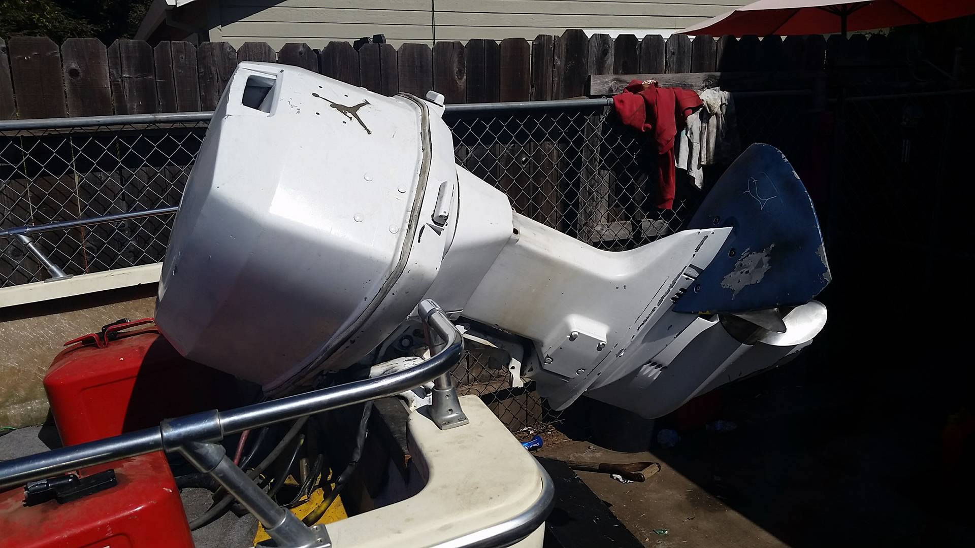

It’s a 23 hp Jordan.
October 3, 2016 at 5:51 pm #45120Looks like a Johnson V4 of some size. Does it have the metal tag on it that lists model and serial number? Could be painted over somewhere on the transom bracket.
-BenOldJohnnyRude on YouTube
October 3, 2016 at 5:53 pm #45121quote Bullie:It’s a 23 hp Jordan.Good one Mark! 😆 😆 😆
October 3, 2016 at 6:23 pm #45124Pull the cover off the motor and look for the freeze plug on the top of the port (right side viewing it from the front) cylinder bank. There are numbers and letters stamped into it. Report back with those and we can give you year and horse power. It’s a late 70’s or early 80’s Johnson or Evinrude V4. Does it have a separate oil tank (VRO) system? It’s most likely 80’s with the zinc anode in the lower unit.
October 3, 2016 at 7:16 pm #45127quote Bullie:It’s a 23 hp Jordan.I believe they can fly.
October 4, 2016 at 2:50 am #45148Well it should be a 1985 Evinrude 90,100, or 115hp or later year. That is the first year that had the anodes that hung off the ends of the stern brackets. If it is a bubble back powerhead it would be a 115. Hard to tell a 90,100 except by carb size, but there are other differences. Starting in 1986 the top HP was 110. Same basic motor as 115hp. If all the parts are original you know it is an Evinrude because of the canted motor cover. Johnson had a straight motor cover at the top corners. Like others said, if it is original powerhead the plug in the block above the port cylinder head will tell you the model number.
Dan in TN

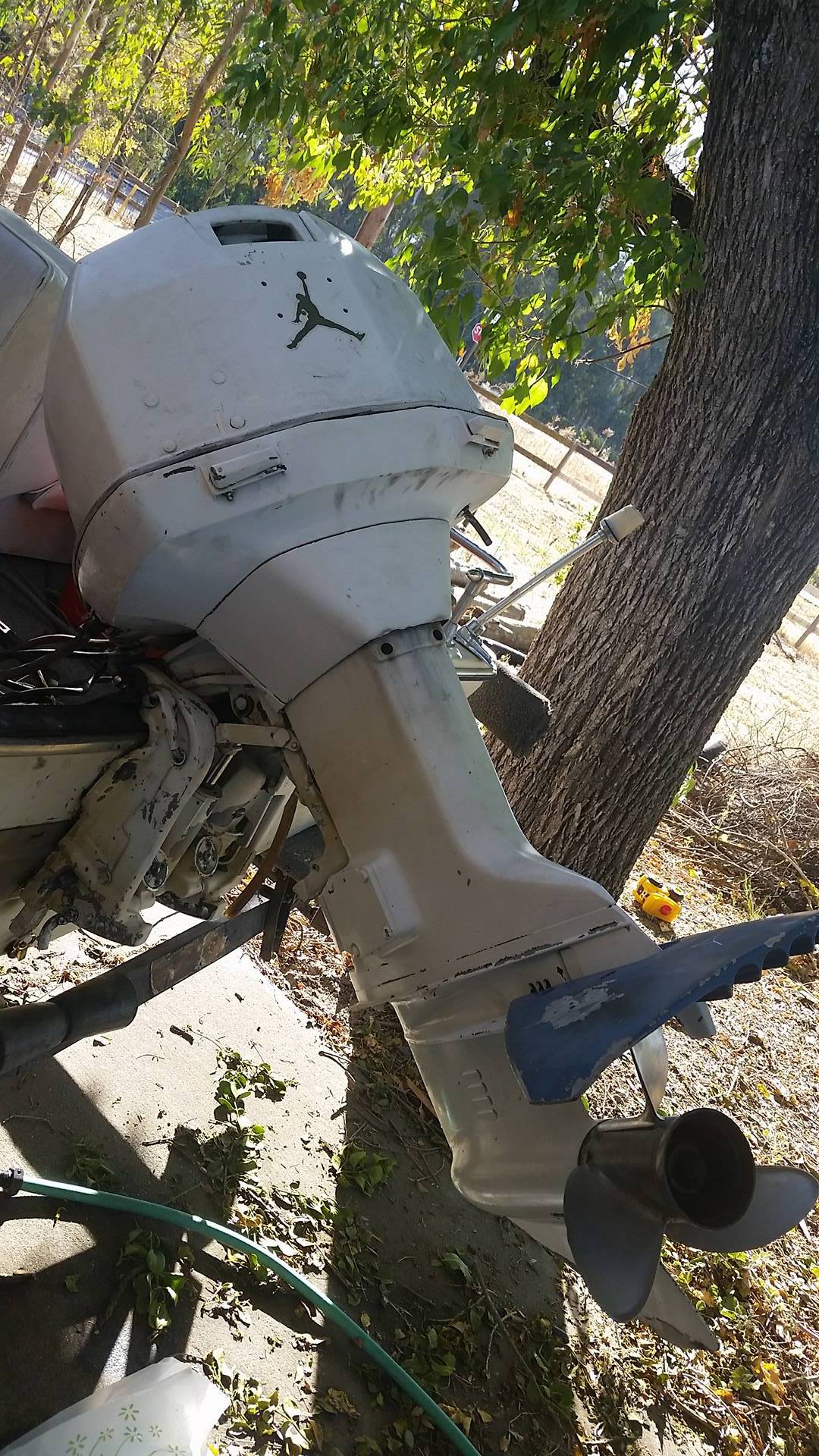

October 4, 2016 at 7:07 pm #45178Thanks so much for the help so far! I found the freeze plug and the number on it is 0432290.
October 4, 2016 at 7:10 pm #45179Here is a photo to ensure I found the correct part.
October 4, 2016 at 7:25 pm #45180So I found a plate that was painted over and was able to scrape off the paint and it has the model number and serial number! Here they are:
Model Number: E90TLCUR
Serial Number: R 1503836 -
