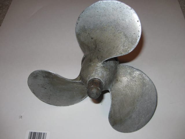

      Anyone knows what this prop fits?
      IMG_3598
      IMG_3599
      IMG_3600
      • This topic was modified 7 years, 7 months ago by Mumbles.
      #171562
        Pull the prop and look on both the front and rear for the ID numbers.
        #171575
        ROBERT LAFAYETTE

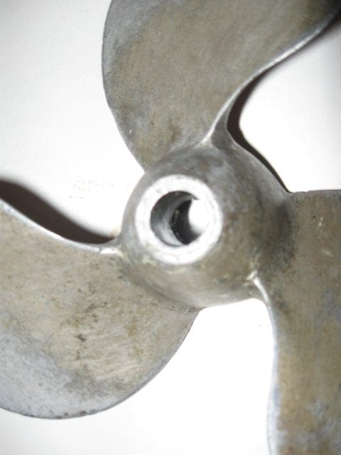

          Nothing stamped? it’s still a mystery?

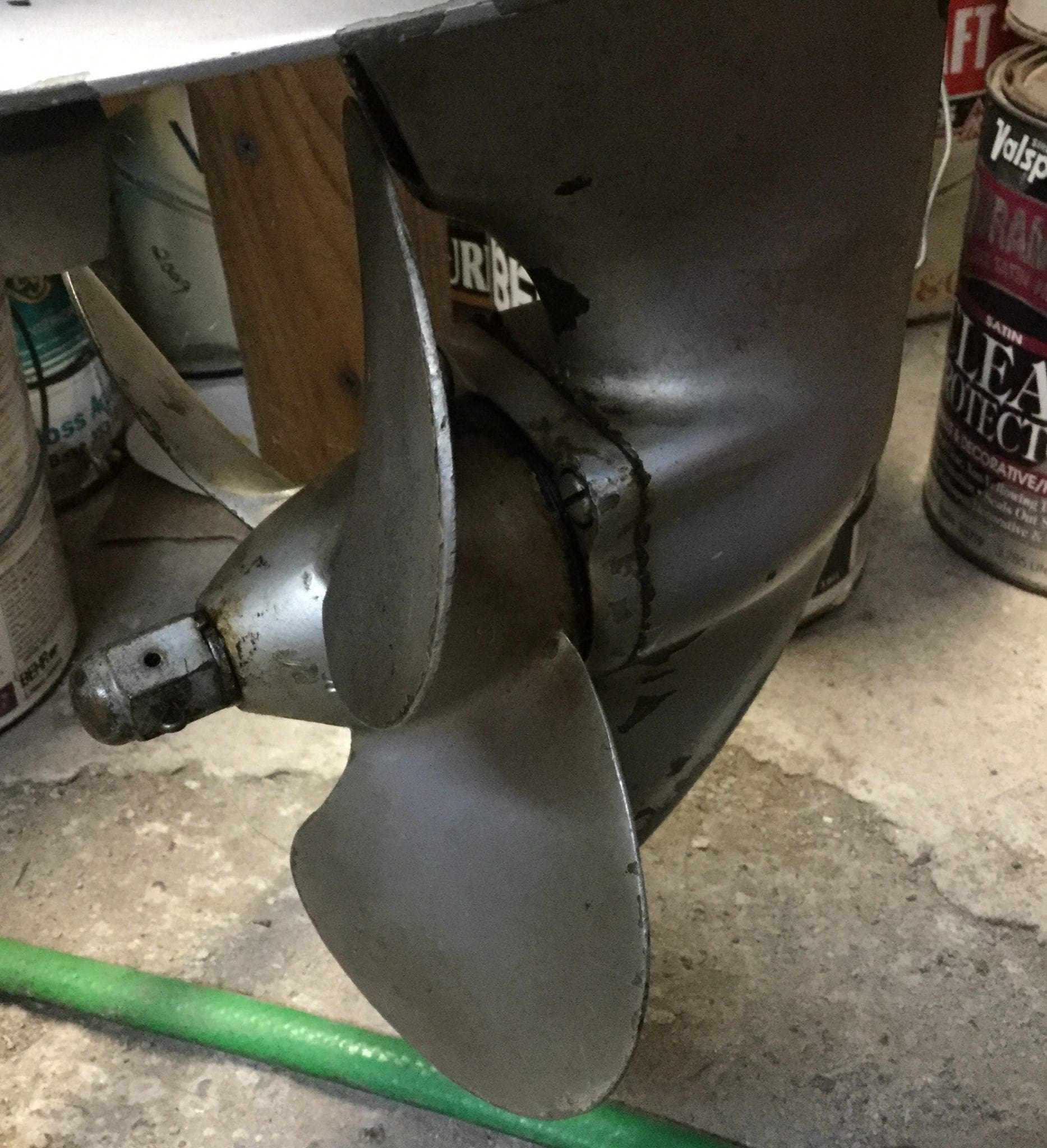

              squierka39
                The prop and housing look like the Johnson KA thru KD series of motor.

                #171792
                TOM GOEPFRICH
                  Clean the inner hub, some Johnson props had their ID. number cast in there..

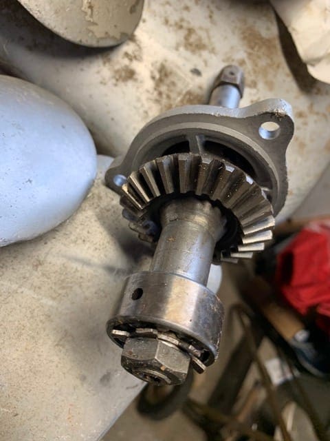

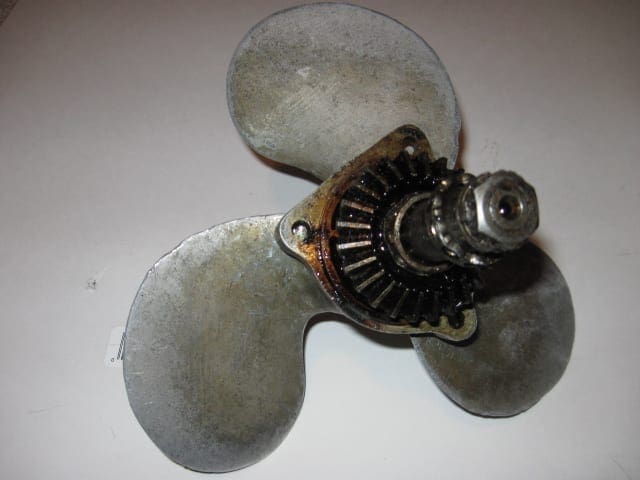

                  davidk
                    I was thinking KA model as well. Here’s mine to show you where the numbers would be.
                    IMG_0419
                    IMG_0420

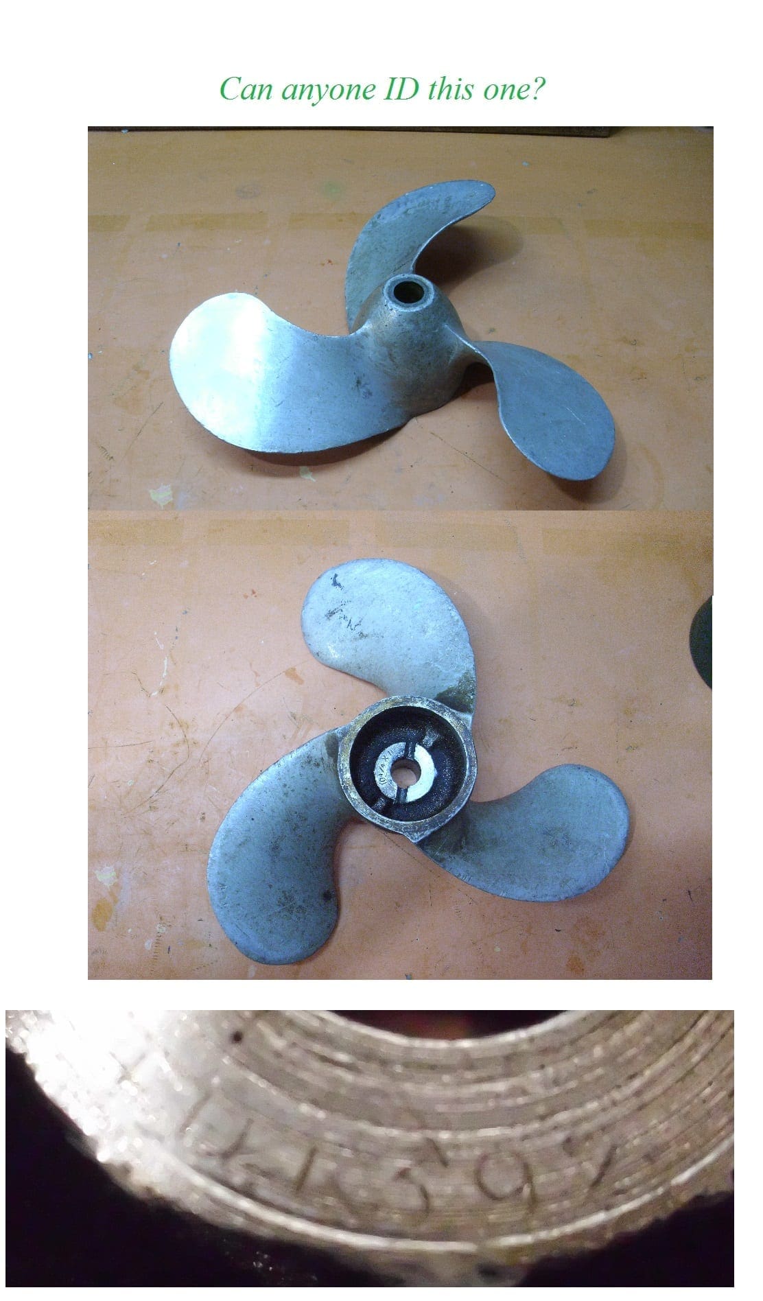

                    ROBERT LAFAYETTE
                      You guys nailed it!!! A+ work
                      I should have taken more time to clean?
                      Thanks so much!
                      IMG_3611
