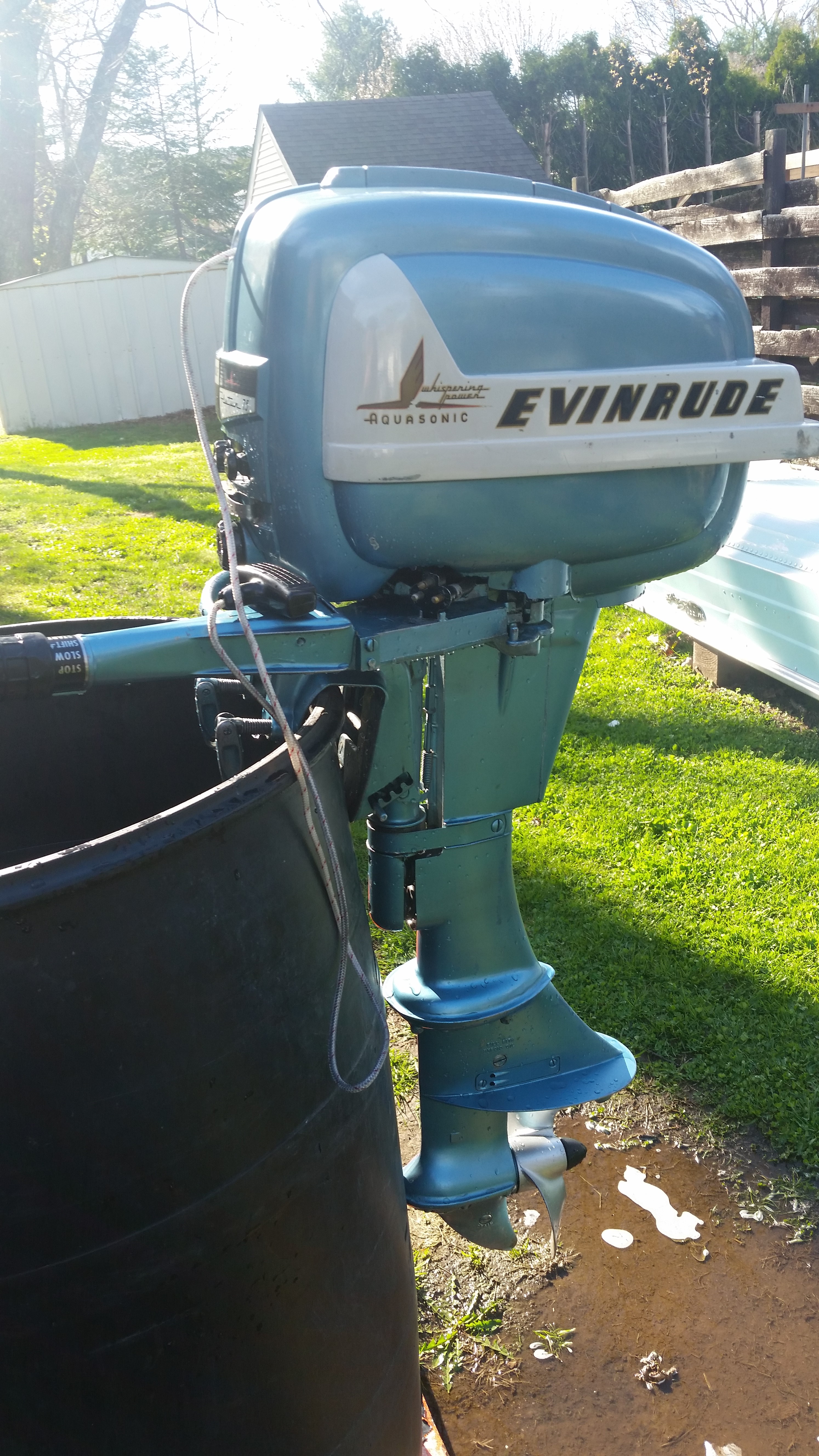

      Putting together a basketcase 7518 which I understand is a 1955 7.5 hp model.
      The recoil was missing so I got one on ebay for an evinrude 7518, but it’s too big. Not even close to fitting. Strangely enough, it turns out that a recoil from a CD-12 model fits and works. Any idea why? Any other recoil models that will work?
      Finally, someone kindly gave me the hood for it which I was missing. I mounted it, but it won’t close together. It’s too high on the side that is supposed to open up and it looks like the fuel fitting port/connector is in the way which prevents the hood from coming down a little lower and latching completely closed. Is there another hood design I should be using?
      #83584
        The recoil was changed in 1956, so obviously the guy sent you a 1956 or newer one. Yes, the CD-12 is the same as yours.
        Don’t know what to say about the hood.
        #83585
          The hood was also changed in 1956. 1956 had lower "pan" cowlings and different motor mounts. Maybe you got a ’56 or newer one of those also.

            #83602
            aquasonic
              All good advice. If you have a 1955 Fleetwin, then there is only one cowl that will fit…a 1955 Fleetwin cowl.

                  Thanks everyone for the replies. Looks like I got the wrong hood. I’ll be looking for the proper recoil and hood then.
