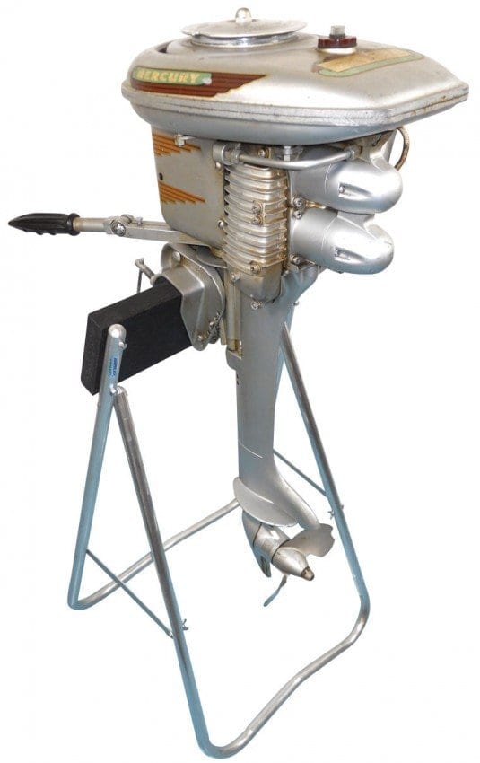

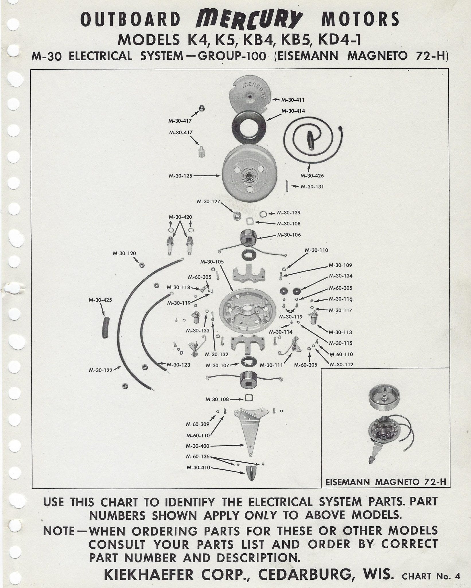

      I just came into this outboard, seems in good shape. It did not have any spark but cleaning up the points corrected that. It came with a “General Instructions and parts list” but the part numbers are old. Does anyone have updated numbers for the points ,plugs, and condensers for this ? It has the Eisemann system . Any other info would also appreciated. Thanks

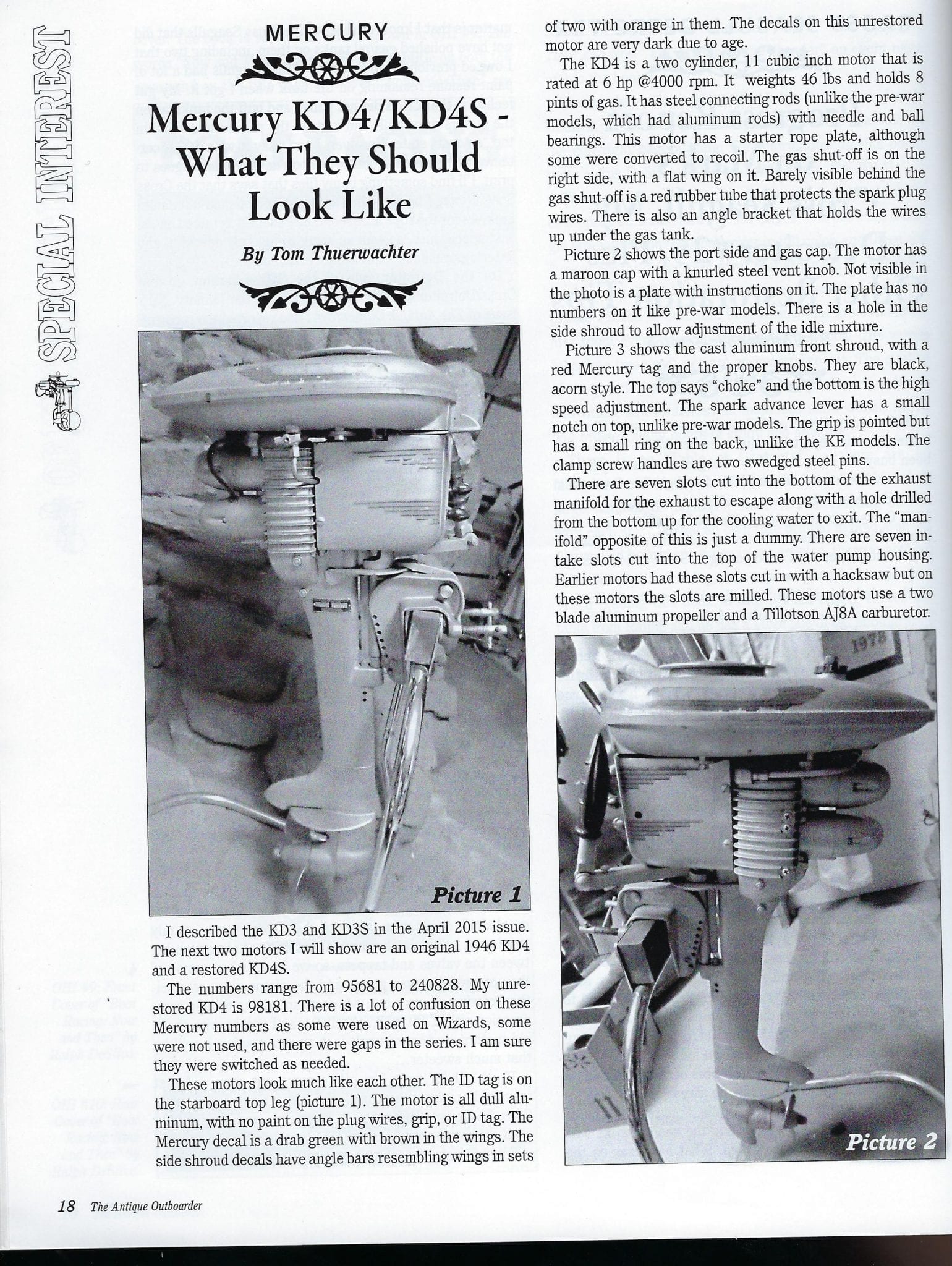

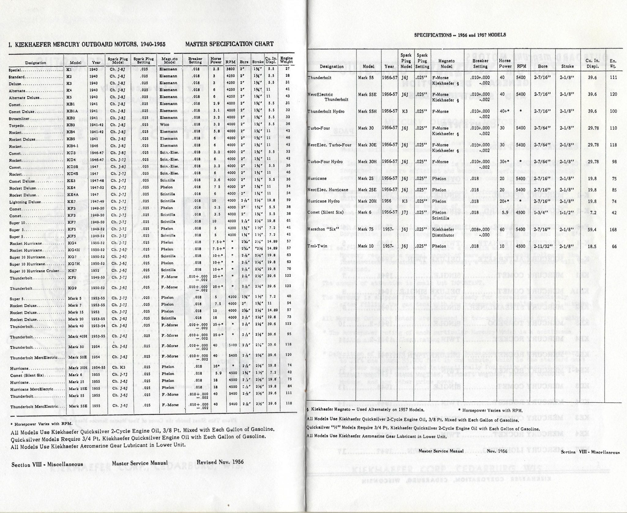

      #216458
      ROBERT LAFAYETTE
        KD4
        MKMC
        KD4WLL
        KD4WLL2
        #216464
        ROBERT LAFAYETTE
          Chart1
          Chart3
          Chart4
          Chart7
          #216470
          ROBERT LAFAYETTE
            Chart8
            11180581_2_l
            194620Mercury20ad
            Mercurya46001
            #216517
            todd281
              Wow thanks for all the info. I saved it all to file for future use.
