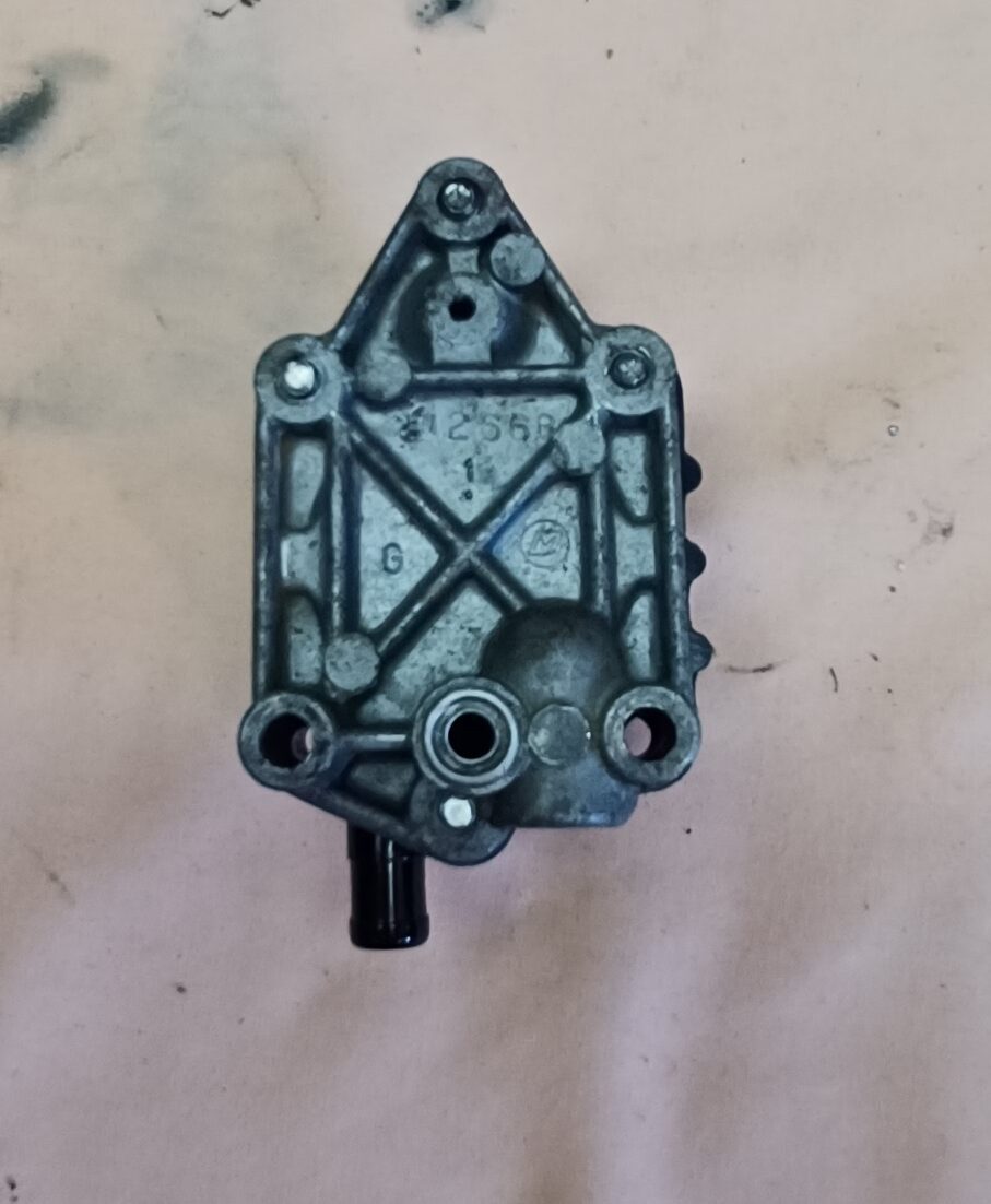

Well i purchased a rebuild kit for this OMC fuel pump
But unfortunately for me it was the wrong one.
I tried using it anyways and it failed
Like a dummy I threw out all the old gaskets and such
I don’t know what motor it came from
The casting number is 312668
Is there any other information I can provide you to tell me the part number for the fuel pump rebuild kit I need?

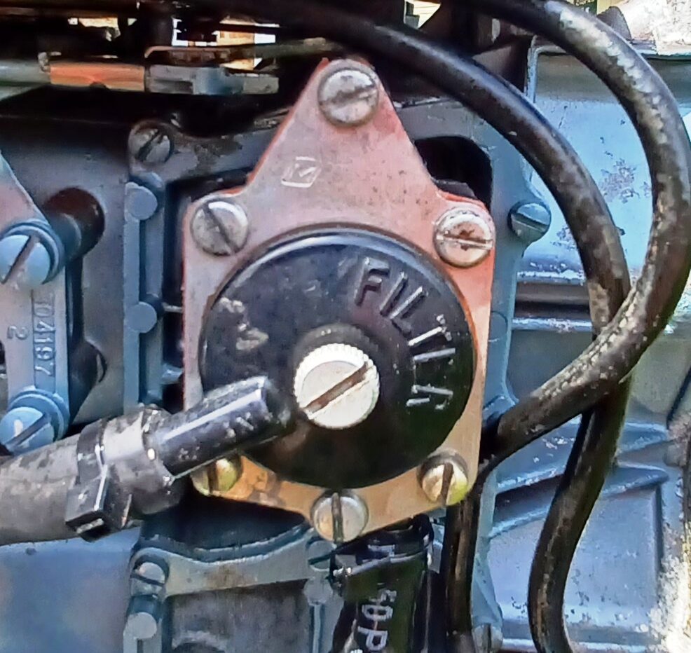

After looking at Marineengine.com’s parts breakdown, it appears that there are two different “large” fuel pumps. You have to look at both repair kits offered by BRP and Sierra. One style has the shoulder style pump and the other is sloped down without a shoulder. Both are still available. By looking at your picture, your pump has the shoulder so it should use the #393103 kit.
Hope this helps.
