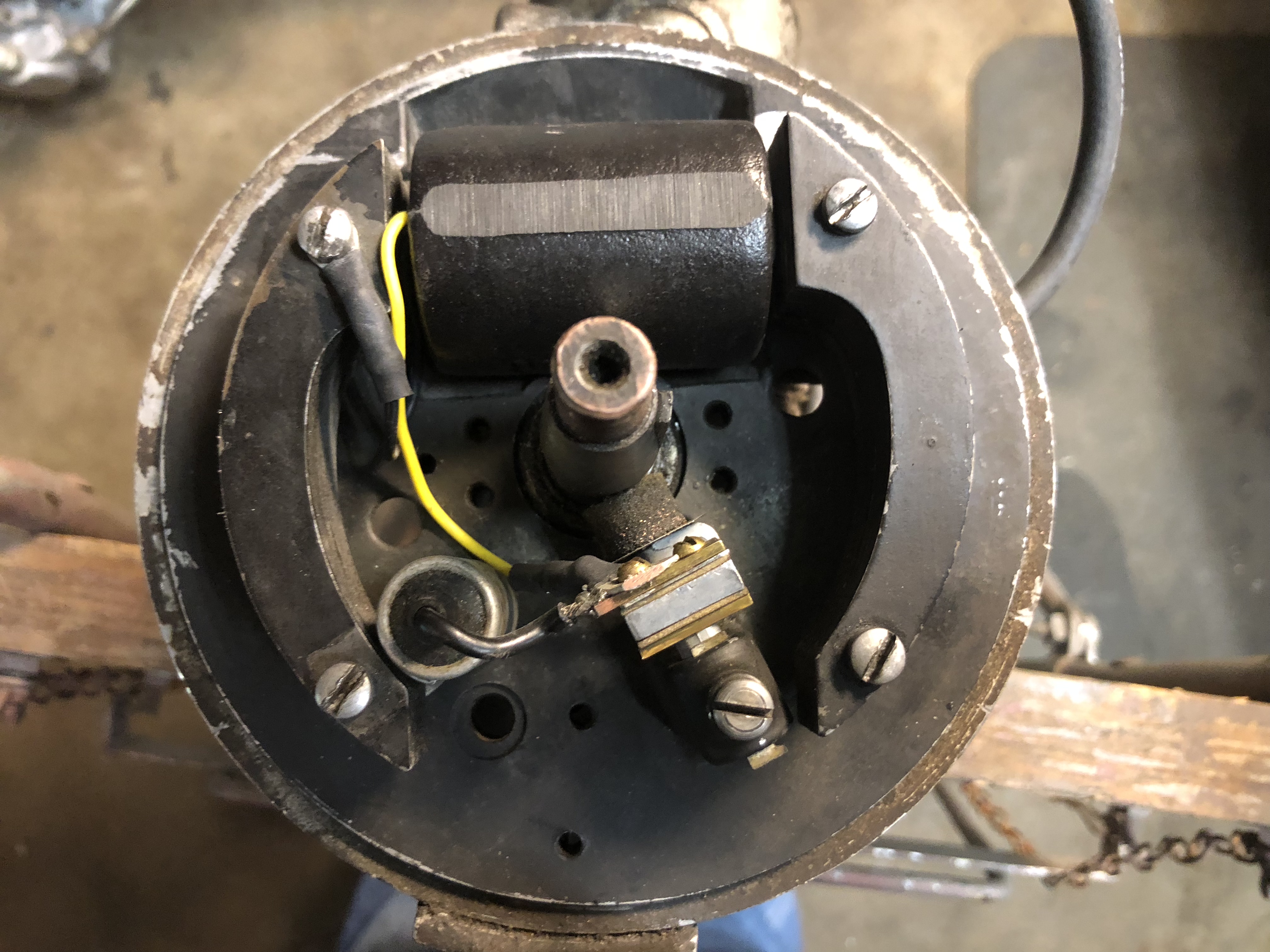

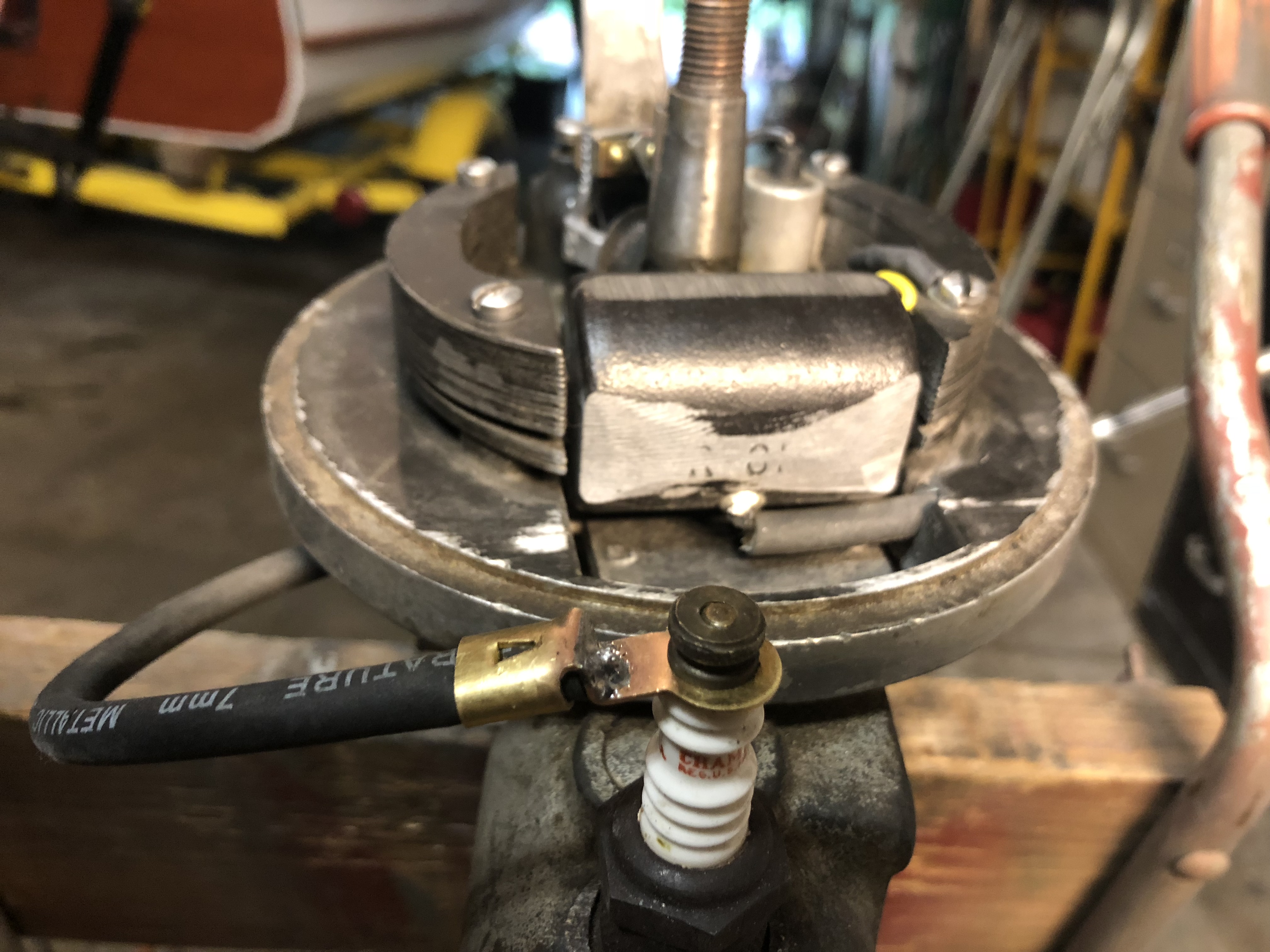

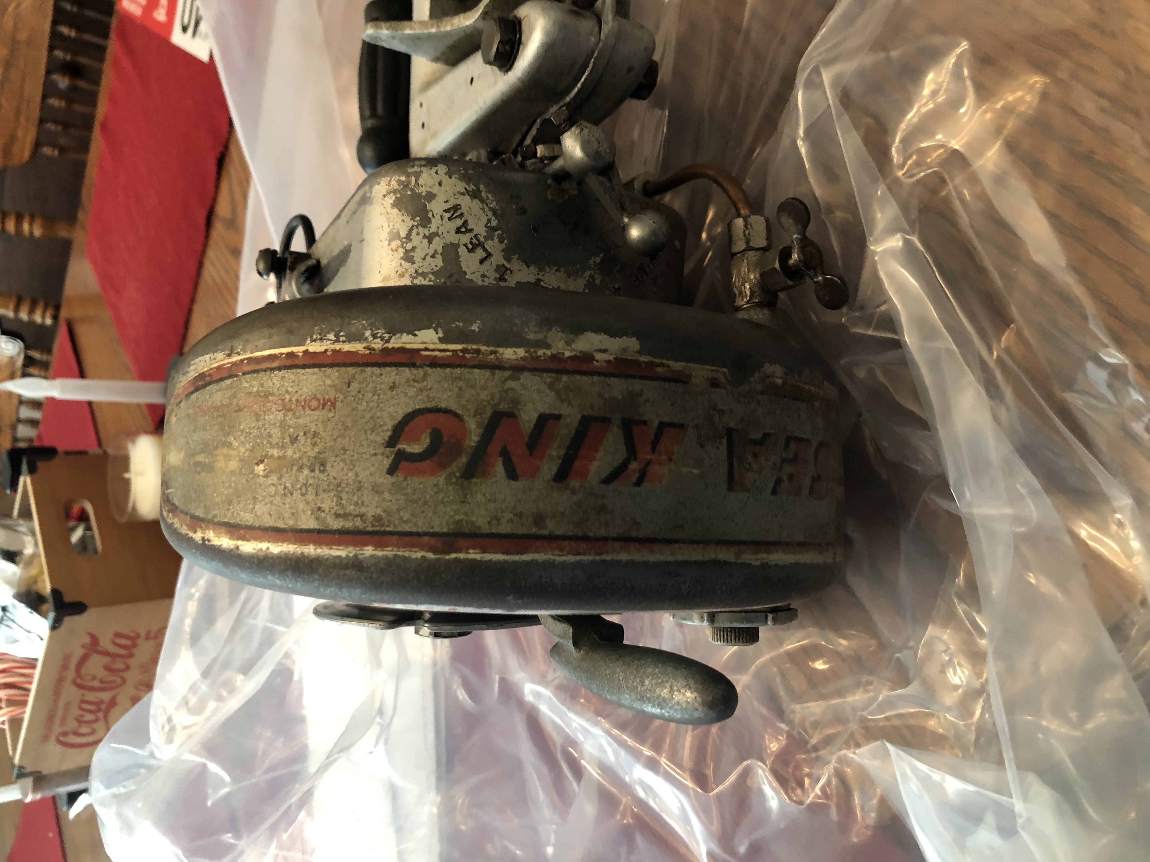

          #79525
          gjonz
            Here is a photo. Or three
            #79528
              That model shown is a 1946 or later model. If yours is an earlier model with the soft iron magnets in the flywheel, see Lykes2tinker’s Elto Cub Coil post . . . 😎
              #79529
                • This reply was modified 7 years, 12 months ago by Tubs.
                #79537
                gjonz
                  Yup. That’s the one. What is it??
                  Where do I get it?
                  I need a 12 step program!
