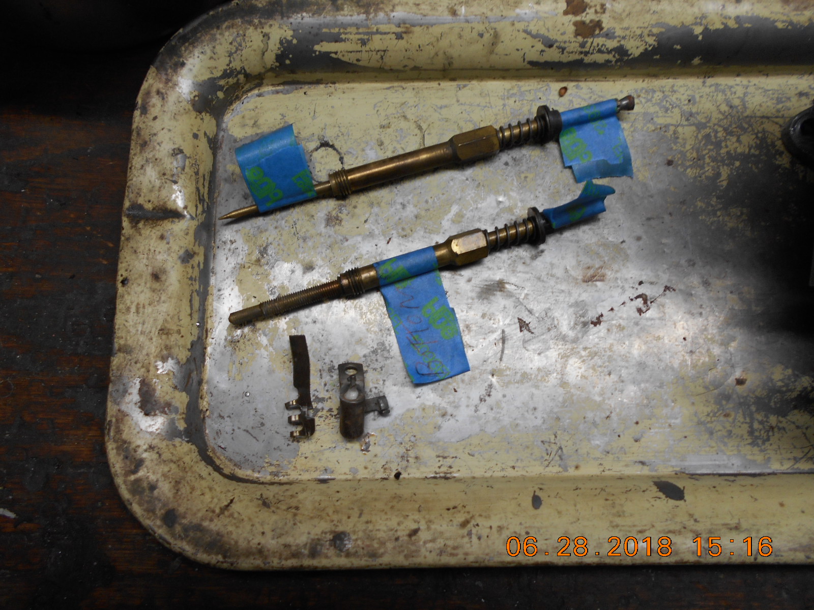

        I removed a slow speed needle from a parts 1956 Johnson RD18 carb.. The needle has threads at the needle end. There are no other external threads. The packing is tightened by 303982 needle valve nut. It threads into the carb body. The only other threads on the needle are internal at the far end to hold the indicator in place. RD18 is a 30 HP motor. Is that what you have for sure?

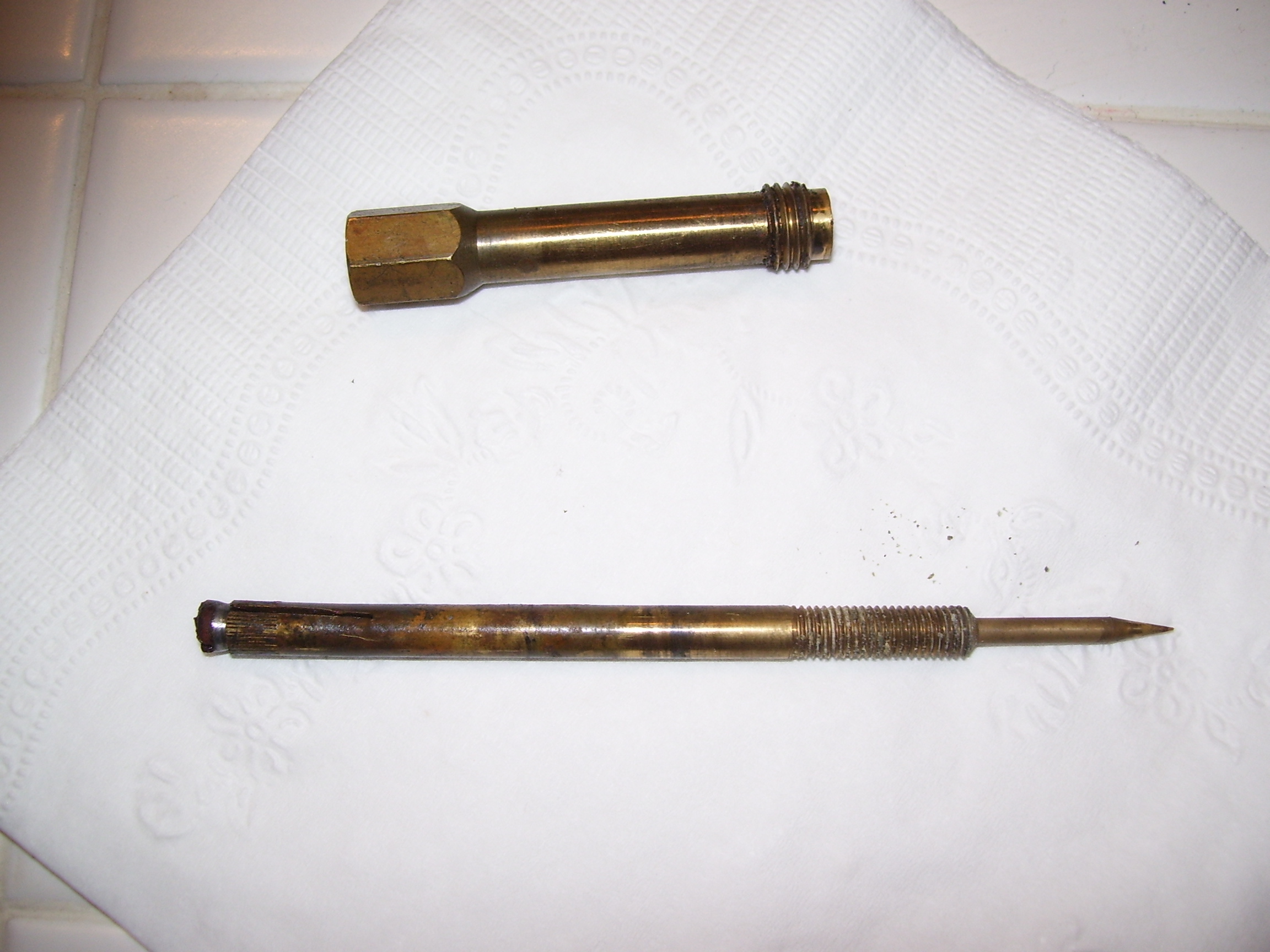

            What olcah shows is all they ever made

              Here is a photo of it, now the threads at the needle end wore off taking it back off. Keep in mind it has(had) two set of threads.
              #78688
              opposedtwin
                Those weren’t threads, those are wear marks. That needle is toast!!
                #78691
                fry-cook
                  So I’ll order the P/N according to my parts catalog. So, the bushing doesn’t thread onto the needle valve then?
                  Thanks, Tom
                  #78699
                  olcah

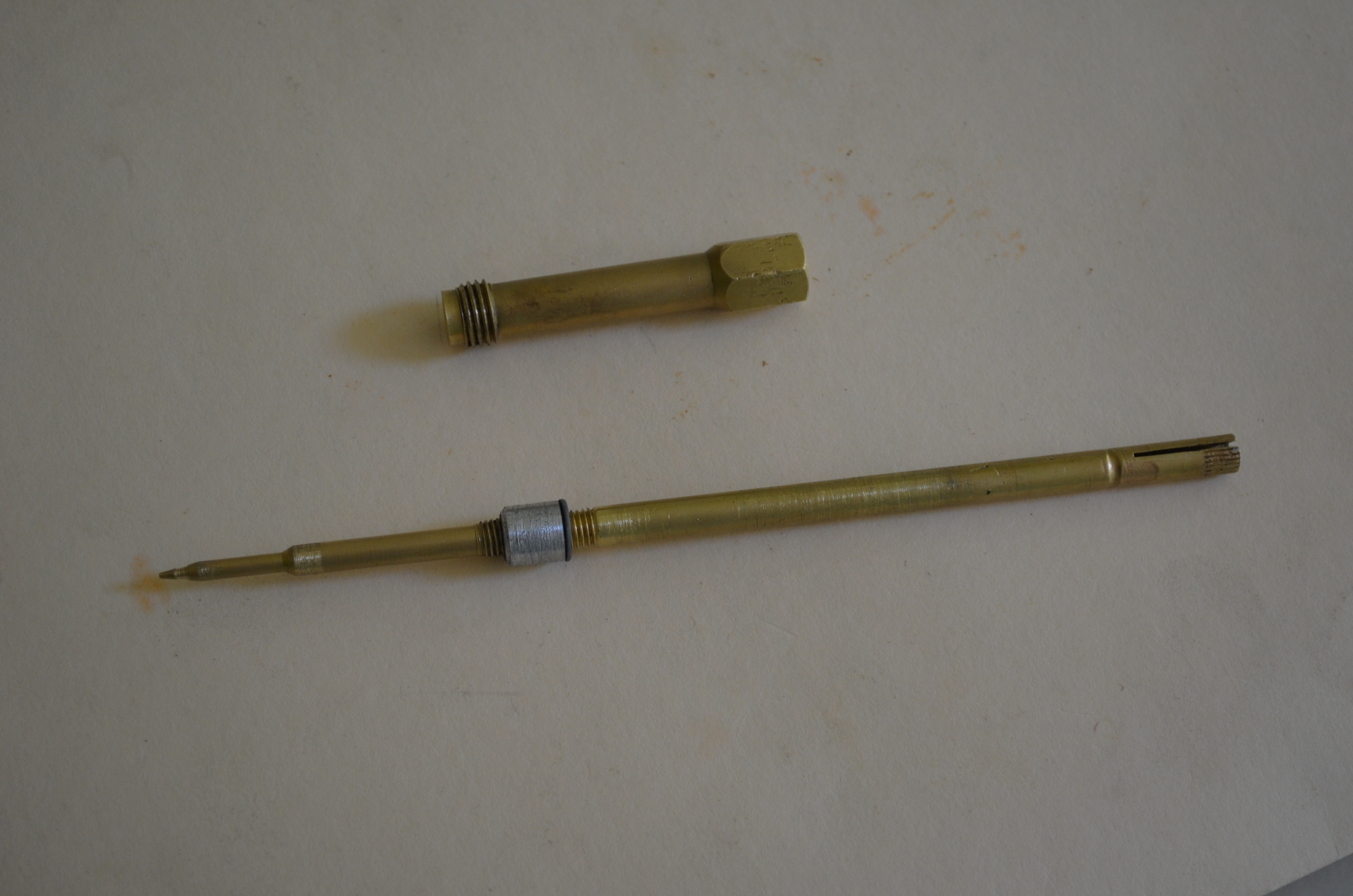

                    The aluminum bushing is part 303939. Normally it is retained in place in the carb body and prevented from turning by the 303982 nut. If you unscrew the aluminum bushing off the needle, your needle will look like the one in the parts list. Here is a factory parts list in case you do not have one.
                    Interestingly the one in my photo does not look much like the parts list, bet they interchange. I would put your needle in a lathe and try to recut the damaged tip. It’s worth a shot.
                    #78701
                    chris-p
                      What you think are 2 sets of threads are just 1, you just have the bushing mid way on them.
