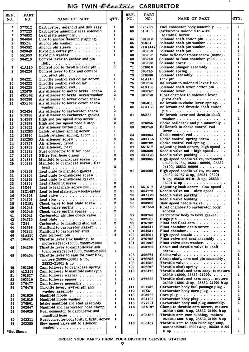

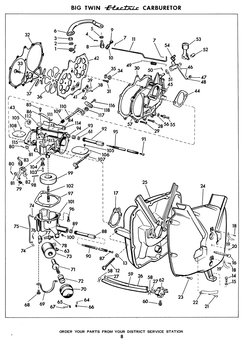

      35HP ’57 Javelin……having the darnedest time confirming the part number for the needle valve cork packing washers.
      I believe it’s OMC# 307583; Sierra# 18-7106-9
      Can anyone confirm or correct me?
      Thanks!
      #71548
        I’d say both of those numbers are good numbers for the fiber sealing washers.
        https://www.marineengine.com/newparts/p … SIE18-7106
        #71549
        nj-boatbuilder57
          Thanks!
          Any idea about the pt# for the plastic washers that the cork washers get sandwiched between?
          #71550
            Either one will appear to be a different material then the original because they are. The originals contained asbestos.
            #71551
              This should work . . .
              #71552
                Plastic washers were not used in ’57, but are a later improvement, so wise to use them anyway. Part number 306027
