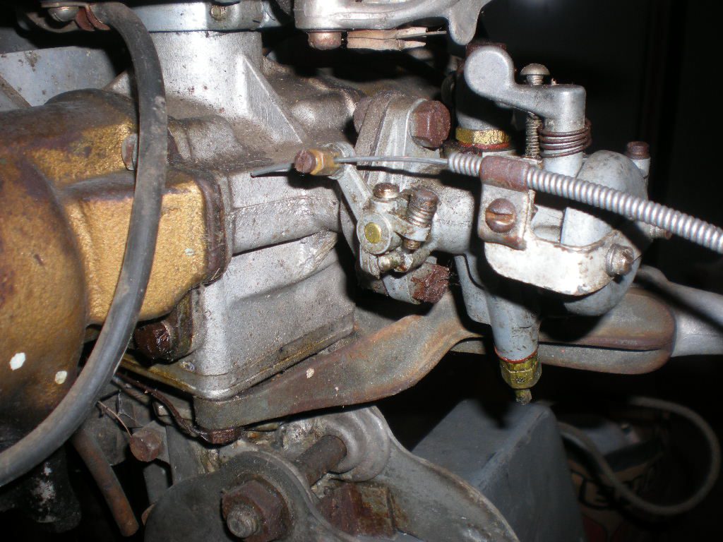

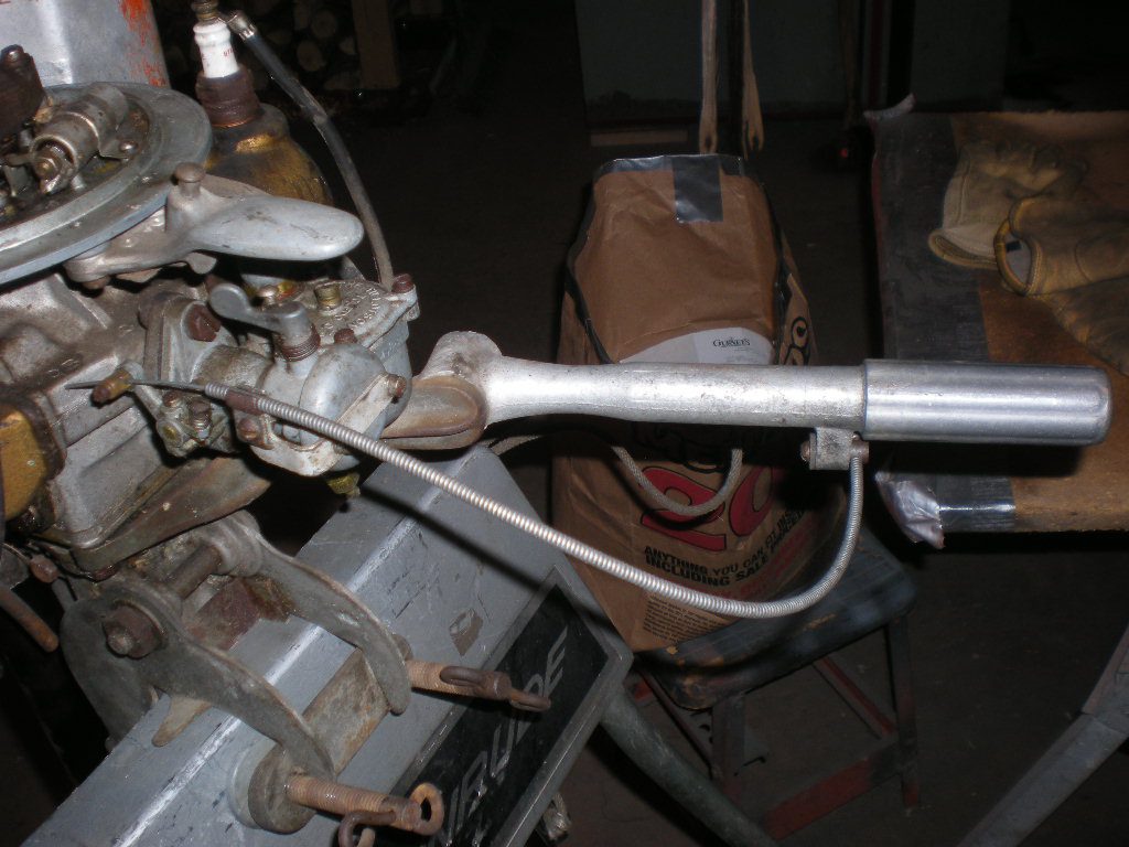

      Just aquired a Neptune 4A38 and was wondering if anyone out there has any pics of a complete motor including some closeup pics of the carb and throttle cable assy. Mine appears to be all there but has some broken pieces and a stuck throttle cable. Want to have an idea of any possible missing parts. Can’t believe how light this 4hp is!

          Thanks Buc…carbs totally different, cable goes in the other side. Thanks though…how does yours run?

            #261368
              Is there enough shown in these to answer the questions you have?
              I believe the number stamped on the side should be MS45C.

              DAN UMBARGER

                  The lever is pined to the shaft so removing the
                  butterfly to remove the shaft is the best way to
                  get that part off (IMO). Watch out for the spring
                  and slug if they aren’t gone already.
